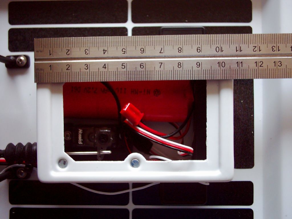

                By heck…it worked!

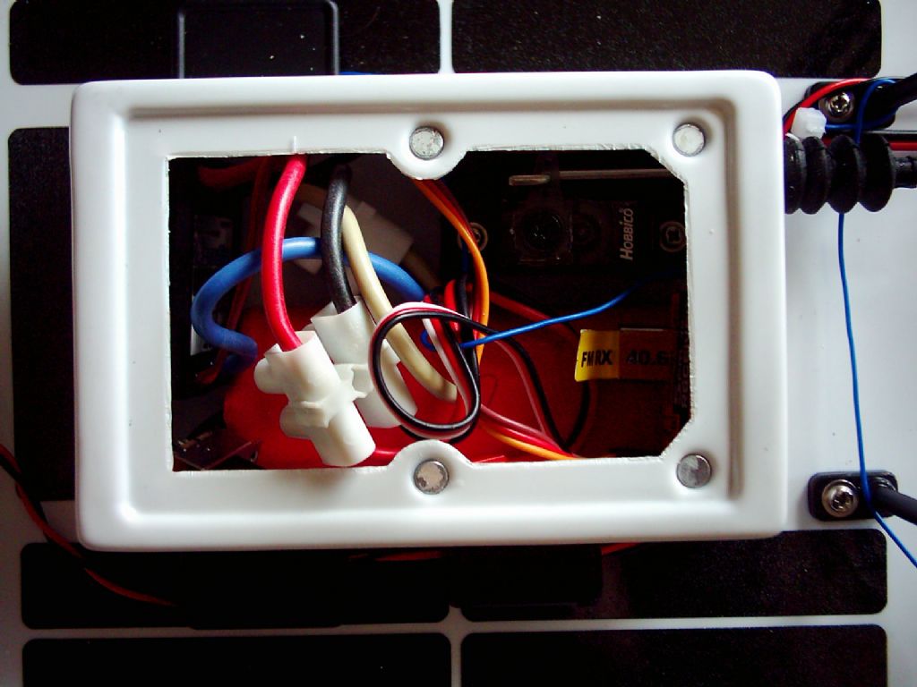

                This is the interior of of the r/c box as it was.
                Not much room in there…

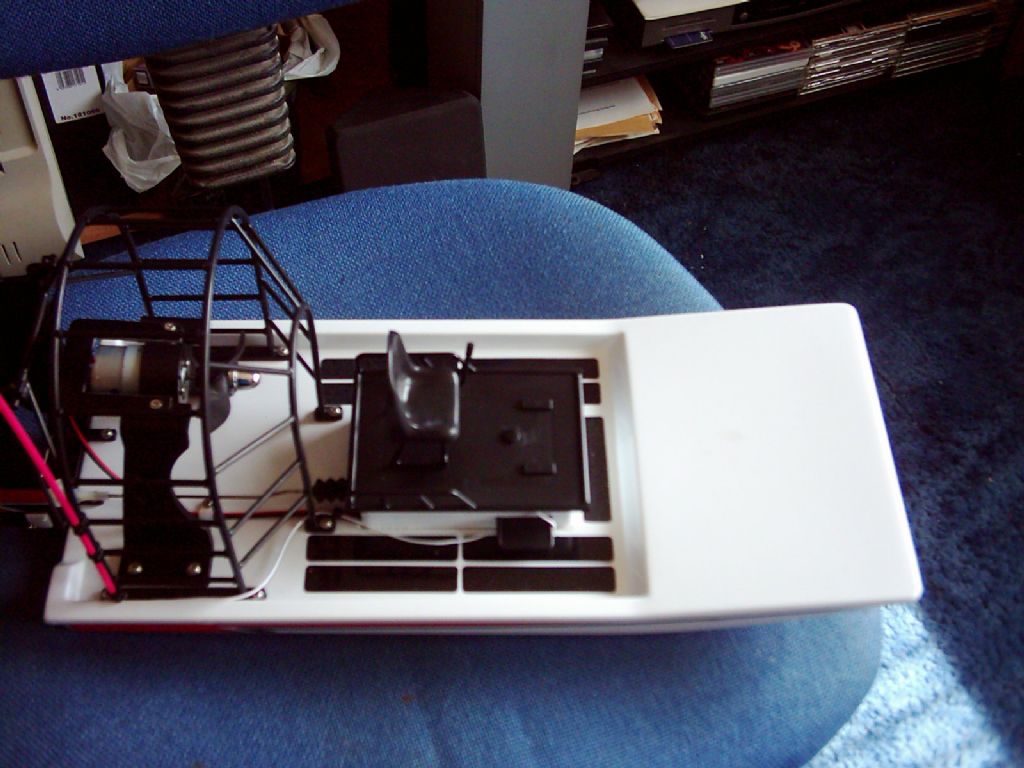

                This is the airboat before I got stuck into it…
                Now I need to take some pics of the modified version.

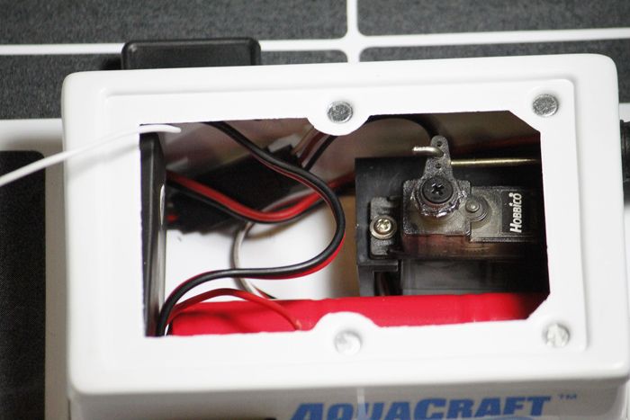

                  The r/c box now fitted with an Mtroniks Viper Mini esc and a four channel 40Mhz FM rx. Bit on the crowded side…

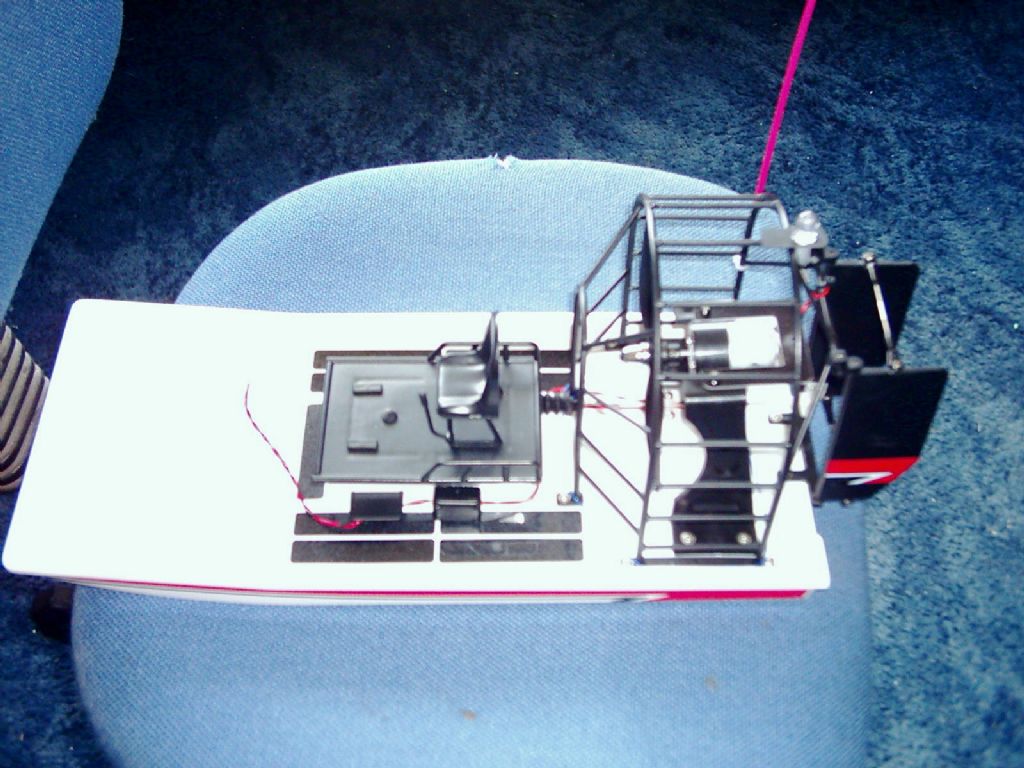

                  And this is the modified version…you can see the flashing beacon on top of the prop cage, the small black box under the seat is the circuitry for the flasher, courtesy of ACTion Electronics, the wire in front of the seat will eventually be attached to a PP3 battery, wrapped in a balloon and hidden inside a rolled up fish net.

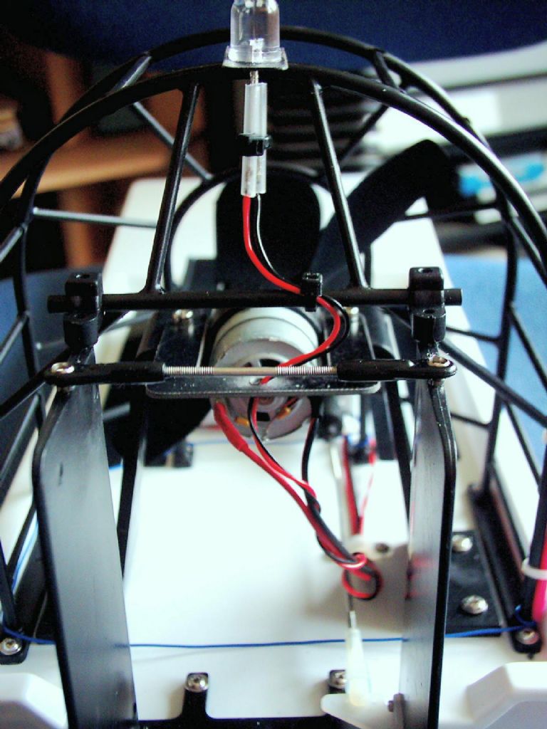

                  This is looking between the air rudders and shows the flashing beacon on it’s bracket and the wiring tucked out of the way.
