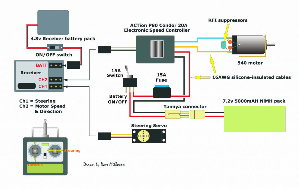

              Here's a wiring diagram suitable for any 2-channel model with a 540 and 7.2v battery:
