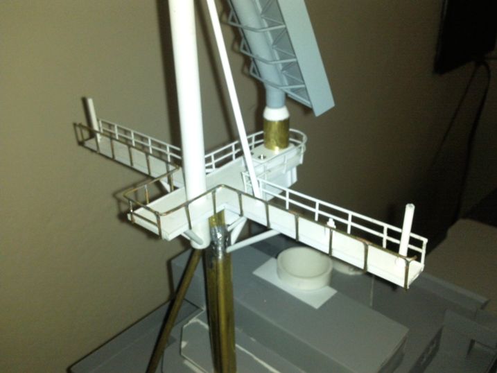

      HvyCGN-9
        @hvycgn-9

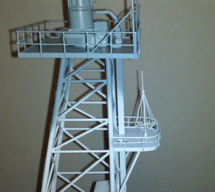

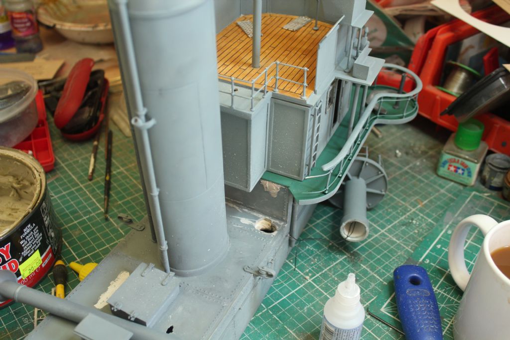

        Have finally made up railings for fwd mast used 1.2mm brass rod for rear side of platforms to stiffen the outer ends( they appeared 2 have a slight droop after the actual bracing finished) still need 2 di second rail for brass rails will CA some styrene in. The fwd side is styrene rod pre glued together using the jig a friend made for soldering the brass  rods (works just as well !)
        And have made up the railing for the antenna platform on fwd side of aft mast with the Xmas tree antenna (not sure of its designation)
        Pix also shows the rebuilt SPS-49 base section with cable trunking
        Cheers Bruce

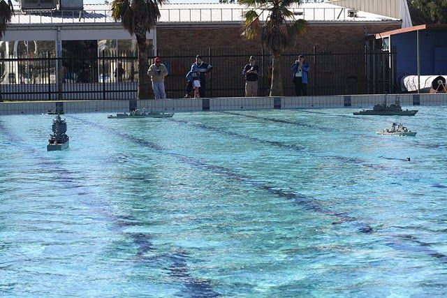

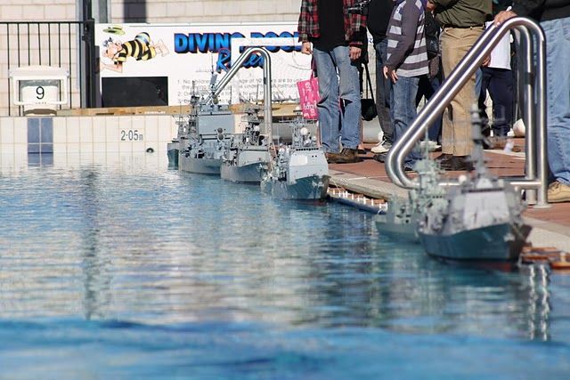

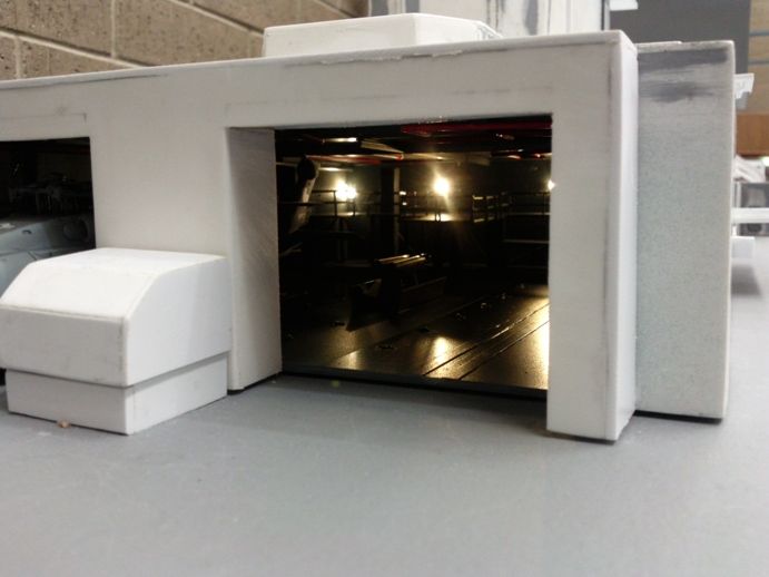

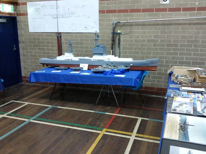

              Been doing more detailing and took CGN-9 to the South Australian Scale model expo for a club display we put on 2 entice interest in big RC models… Ran in to a couple of people who have or r starting 1/72 scale models ranging from  Paul with a Flower class Corvette 2 a young bloke who has begun a Bismark!! and another who is just starting HMS Hermes ( Falklands era). Great fun ran around trying not 2 spend 2 much!!
              TF72 fleetbase Gulf waters club display
              CGN-9 with USS Saucy and pair of PT boats

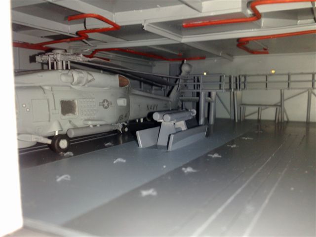

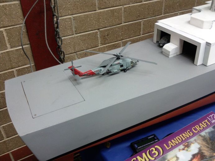

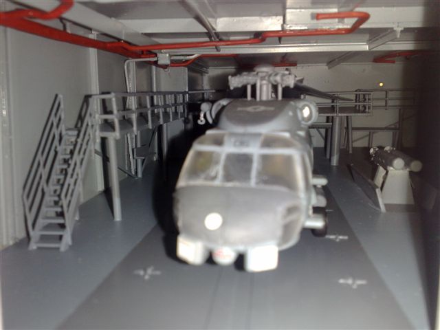

              SH-60 on deck a second in the hanger
              lights on in hanger( they R 1.8mm warm white LED’s there R also a couple of red LED’s for night Op’s lighting)
              Hanger internal details ( the hgr floor is removable in case of repairs)
              Hanger detail is mostly made up of scrap’s and a bit of styrene rod for uprights.

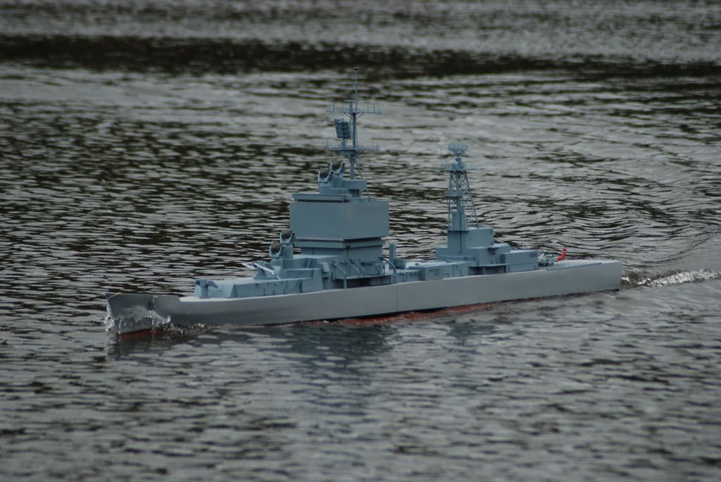

                Went on a monster road trip to the Annual Tf72 Regatta in Wentworth Fall’s NSW it was a 2700km round trip!! But hell it was fun, here are some pic’s from the run
                Cheers Bruce

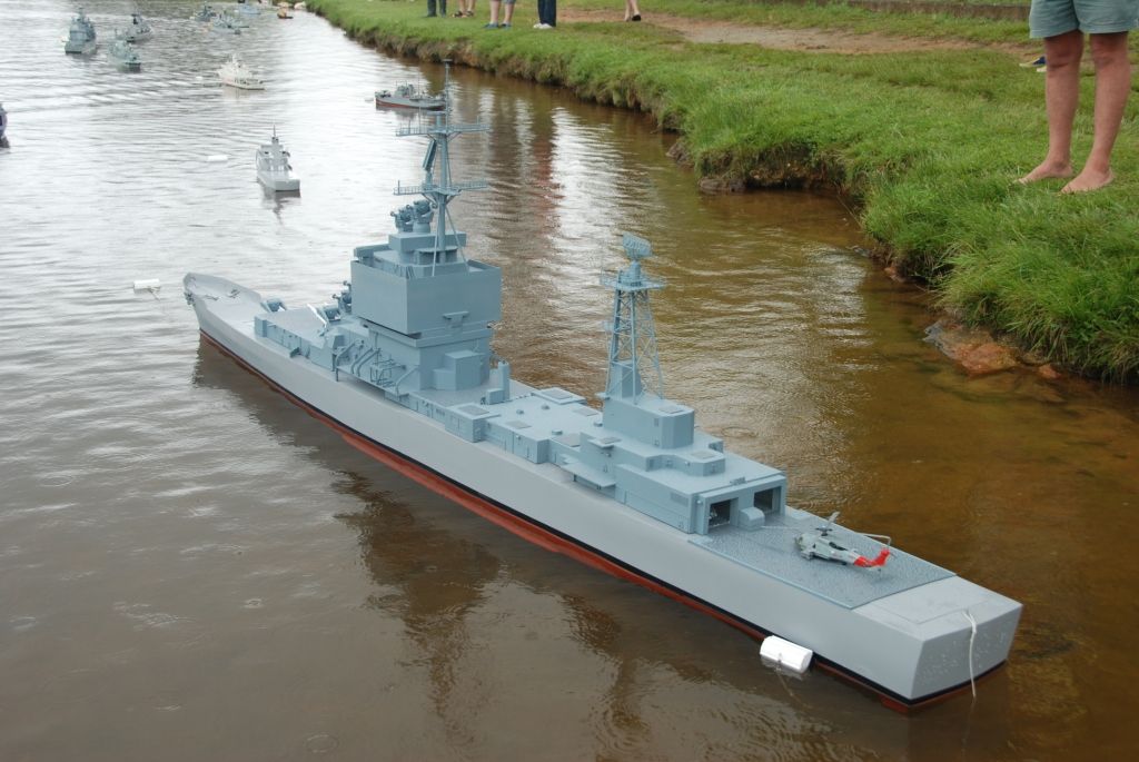

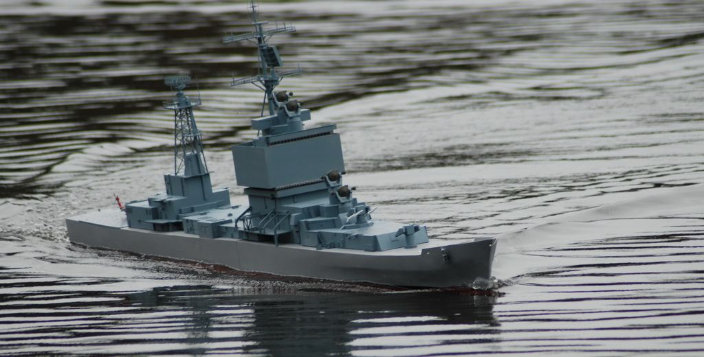

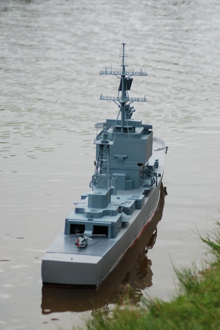

                USS Long Beach CGN-9 drifts at the bouy
                medium speed turn, note fwd missile radars and mk10 launchers in place thanks 2 Alan Pew of APS models who got them 2 me just in time 2 have them on for regatta!
                CGN-9 at speed, the overcast conditions made for excellent photographic conditions
                Pic’s by Mick Elst

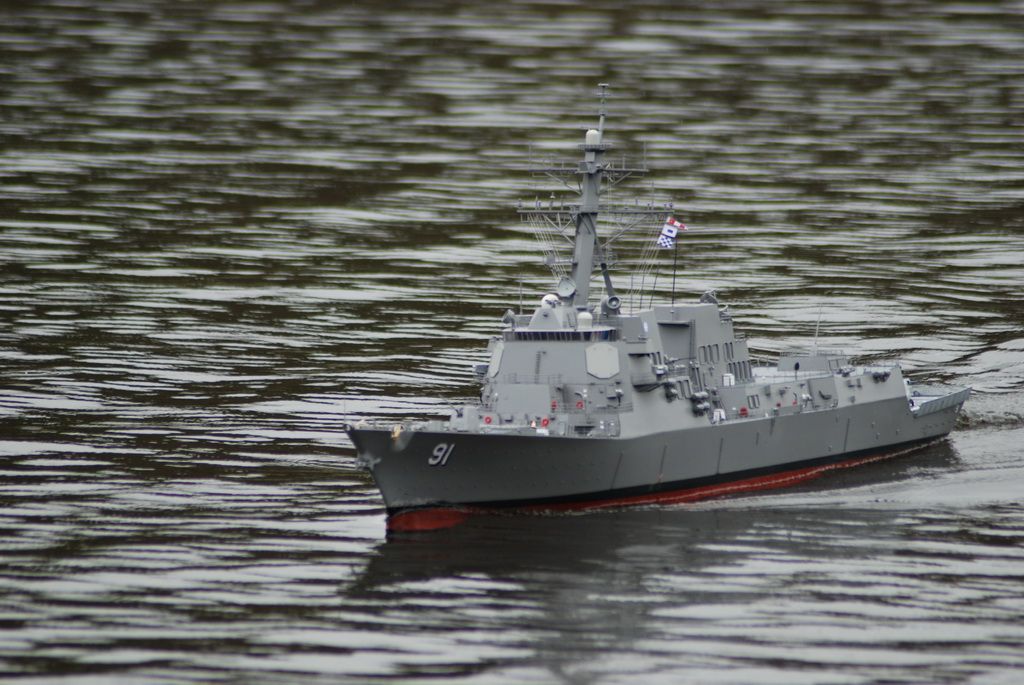

                  Graham’s new model USS Pinkney DDG-91 out for her 1st run

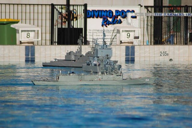

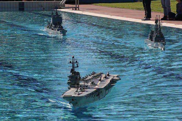

                  Fleet ops with CGN-9 leading DDL-42 HMAS Kokoda(by Mike James) and INS Mumbai
                  Midpoint of the Anchorage, in the far background are battleships HMS Hood and IJN Yamato with hvy crsr IJN Takao

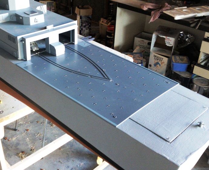

                  USS Long Beach at mooring, note Flight deck is on with SH-60.
                  This is a piece of 2mm Styrene with about 50+ aircraft tiedowns and RAST tracks.
                  Still need 2 paint white flight deck lines.

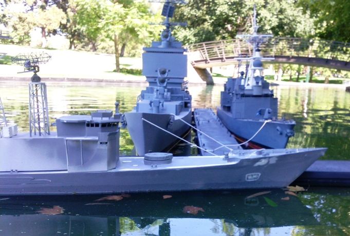

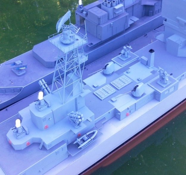

                        Been a fair while since I updated!! Have made a start on a new revised bow section and have been detailing midships area and taken LB for a couple of club run’s

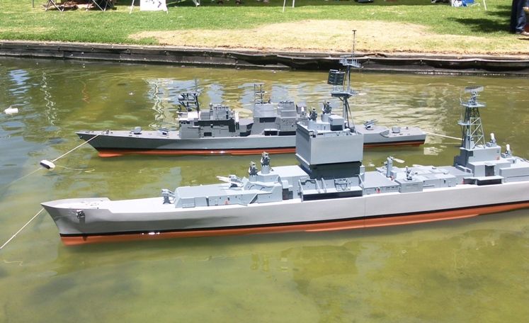

                        LB alongside USS Scott midship wpns upgrades inplace (and Stbd 24’RHIB)
                        This pic was taken in the shade on a 40deg C day!! Extremely blue…
                        HMAS Sydney, USS Long Beach and USS Scott tied up at my experimental floating dock setup.

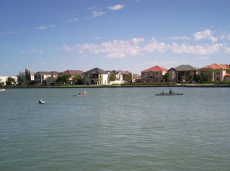

                        Fleet Ops
                        At a different lake due 2 low water levels at our regular lake

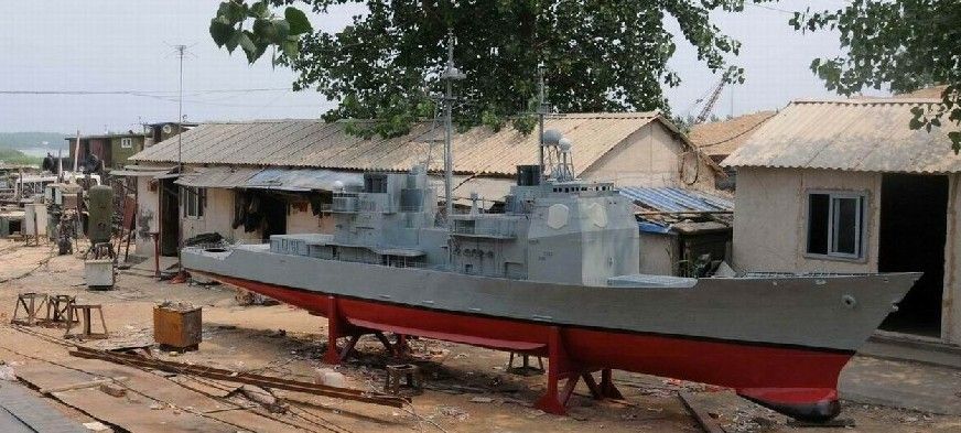

                                How wonderful is!!I dream to making a DDG-82 for 1/72 . But now, not have time and drawings. eiiiiiiiiiiiii…..
                                Who can take in touch with the model DDG-81`s player??? I want talk with he
                                 Sorry my English !
                                This ship L:11.8M
                                Edited By tomorrow on 17/09/2011 16:22:15
                                Edited By tomorrow on 17/09/2011 16:45:35
