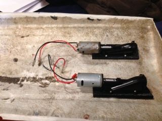

        Just got all the jet intakes done! and have created another thread for the 3D printed stuff img_1829.jpg

                    I just had a look through your album and found that lotus! Very cool indeed, what a great idea! How did you make all the complex wood pieces water tight? I am struggeling to seal around my jet intakes, what would you suggest?

                        Silicon bath sealant is good for sealing – make sure everything is clean and grease free first.

                          Ahhh Bath sealer! What a great idea, i will be sure to try it on the ABS intakes!
                          Also you said you have two 540 motors on such a small boat. What would you suggest for mine? 84cm long 29cm wide and i want it to go fast like the attack crafts?
                          Matthew

                            No idea on the size of the motors, chances are brushless is the way to go however be aware of the shaft bearing limits as there will be quite a load on them.
                            Tthe Lotus was sized around the weight of the motors, battery and some for controls, giving a displaced volume. The water line was guessed as around the window height and volume of car under water calculated.
                            Side elevation was adjusted on the photocopier to get the approximate size with just enough internal space for motors, width adjusted to get the displacement.
                            Thats why they teach maths at school.
                            Scale is about 1:15.

                              Yeah, it is a shame they don't start teaching any real world maths such as that until A-Level but i am sure i will figure it out! All i have worked out so far is that those 2 jet motor are not going to be enough!
