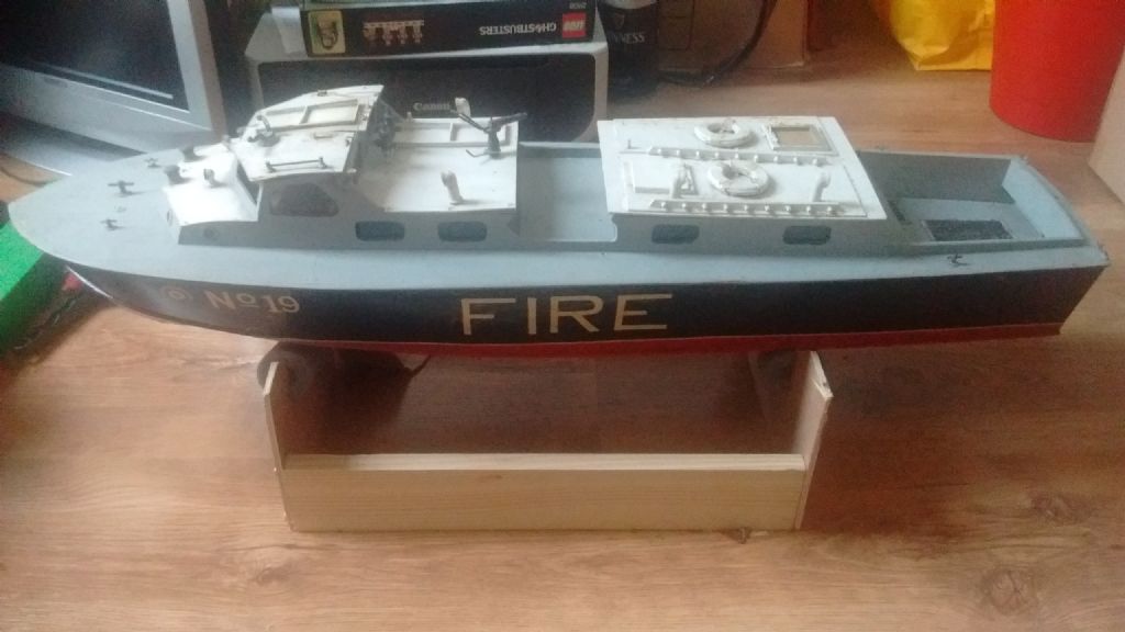

                                      Just waiting for the components to arrive, in the meantime made a stand. I'm OK ar soldering but most of the RC connections appear to be Futaba Male/Female and looks like the flysky receiver uses these.fireboat stand.jpg
