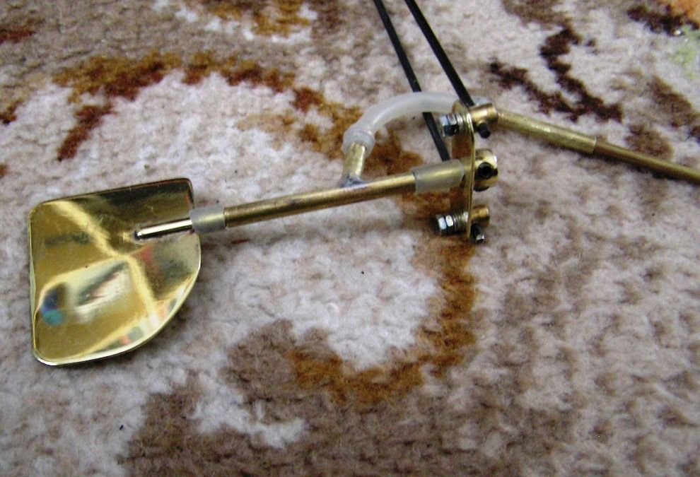

                      Hi Peter
                      The rudder on my boat is 70mm long and 45mm wide.
                      The silicon fuel tubing is for safety, if the operating arm comes off and to stop the rudder dropping into the water.
                      I am adding a pic of the rudder setup on by SG&K Runabout to give you an idea.custom rudder 2.jpg

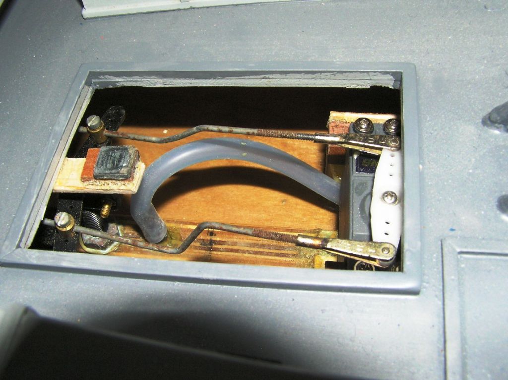

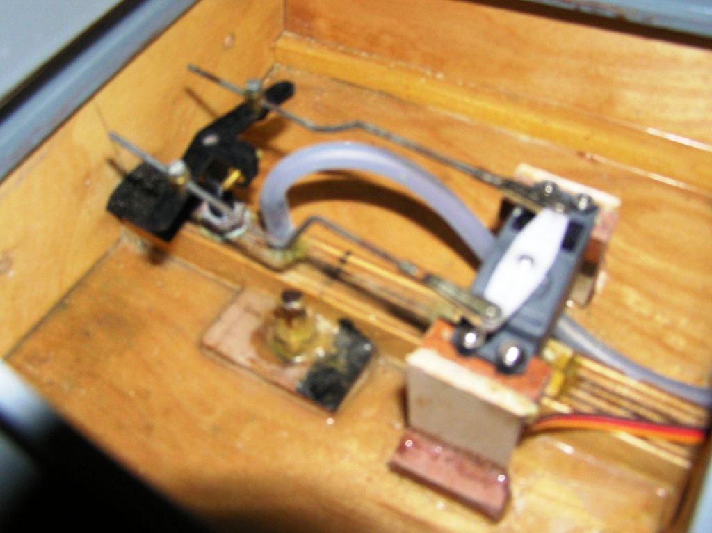

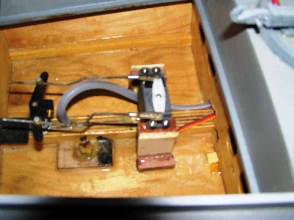

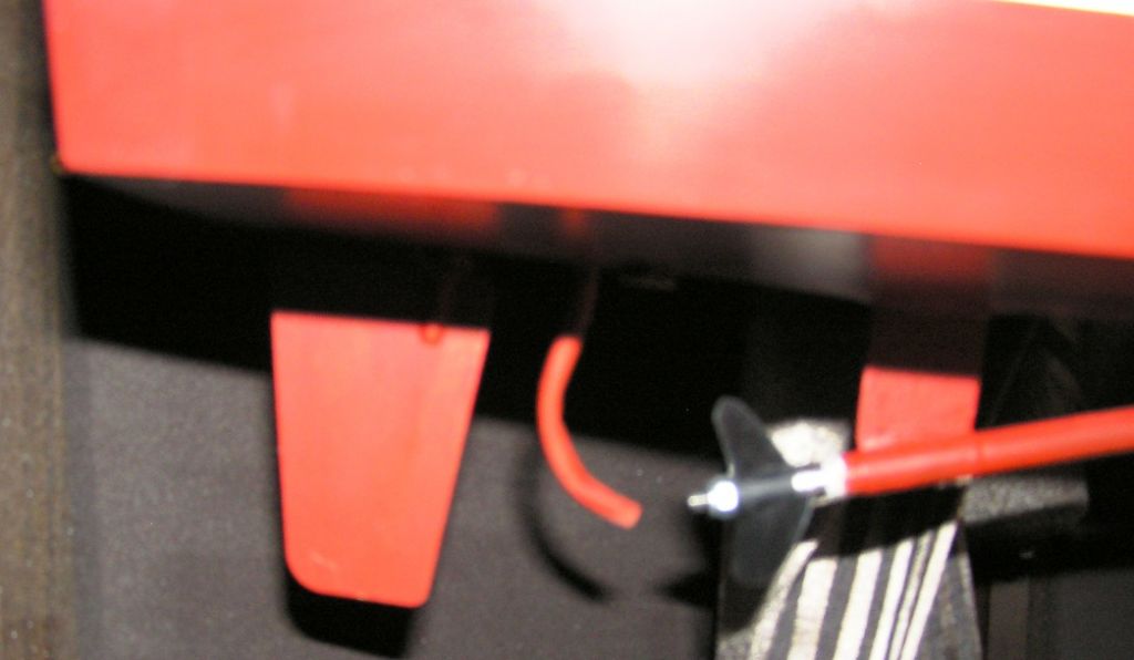

                                    #72374
                                      rudder 4.jpgrudder 3.jpgrudder 2.jpgHi All
                                      Pics as promised !!

                                        The Crash Tender looks like an Aerokits model. They came in two different sizes – about 36" and 48", as I recall. Have we sorted out which size this is? Because the rudder sizes will be different. Though, as I understand it, he already has the original rudder blade….
                                        Sizes do not have to be absolutely precise. To replace a 72mm X 52mm rudder, this should be fine – **LINK**

                                          I like the prop-shaft! How is the skeg connected to the tube?
                                          #72378
                                            Hi Dodgy
                                            I have no idea it was in the boat, I only replaced the bearing and drive shaft.
                                            But on my Precedent Huntsman my go to mate made the skeg from brass flat and a piece of tube(silver soldered) that fitted over 8mm tubing.
                                            He also made a Teflon and brass bearing to fit the 8mm tubing.
                                            Harry
