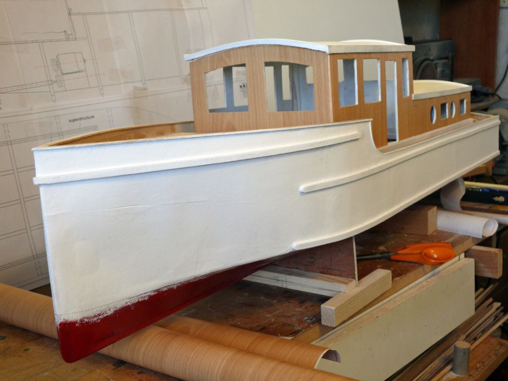

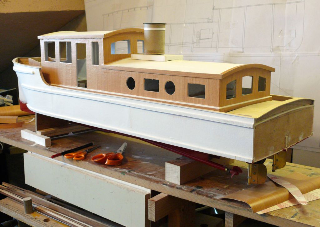

        Made a start on the Fablon Oak veneer covering and it`s really nice stuff to work with
        Instant results
        Will be permanent after a coat of yacht varnish

                    Looking a bit too light and too clean, I think?
                    I may need to darken the wood with stained varnish and add some grime in the corners etc

                      SURELY you will be painting the underside of the hull a bright and dashing colour and adding a stripe to the top of the hull??? Grime…GRIME….please, no. A gentleman's cruiser would be spotless, spick and span. Ship shape and Bristol fashion etc etc
                      ​HOWEVER I see what you mean about the top. A bit light if you want my opinion. But nicely done
                      ​Are you painting the stern white or giving it the wood treatment as per the last one (that's right isn't it??) I would paint it white so it doesn't share the same styling.
                      ​Ashley
                      Edited By ashley needham on 18/08/2017 17:54:09
                      #72698
                        Ashley is right, these boats were maintained in pristine condition, if you could afford the boat you could afford the maintenance. Any signs of weathering would be quite inappropriate.

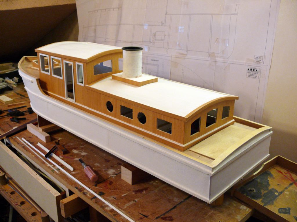

                                                Here`s a novel idea chaps and may be worthy of a mention in Eureka Moments thread?
                                                Made the window frames from 5mm plasticard angle section
                                                Very easy to make and look very neat and very suitabell for the Cruiser build
                                                What do we think, chaps?

                                                  That looks very nice indeed, Bob! My only question is, what are your plans for framing the round windows?

                                                    Hello Banjo, many thanks for looking in and your kind comments
                                                    The round window frames could be simply fabricated from sheet material
                                                    It would be nice if I had a source of white plastic round bar, then they could be made on the lathe
                                                    They could be turned from hardwood and painted……As a last resort

                                                      A very good solution for the window frames Bob. I was wondering what you might do to disguise the bare wood round the frame cut-outs. I often laminate thin mahogany onto lite-ply for superstructures and have the same problem. I'll be interested to see what you paint them with. I have used Plasticote Chrome paint in the past, which is a nice silver but not very durable.
                                                      I still have an old Maycraft Mercury to finish refurbishing and the thing that's putting me off is fabricating the twenty plus window frames!
