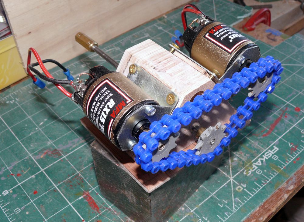

        Decided to leave the sprockets as they are at the moment and get on with the construction
        We need to see how the two motors behave in unison
        Here`s a WIP picture, for interest and any comments?
        This drive will be tried out in the Ellie launch
        The prop shaft will be on the chain side for accessibility and appearance

          Bob, Wont this be a bit noisy??? all that plastic flapping about?? Ashley
          #50162
            Don't know myself, Ashley
            I'm hoping it will sound "different"
            It will also act as a sort of gearbox too…With either one or two motors powered up
            MK11 will have proper timing belts
            We like to experiment with new ideas…..It keeps us young!

              Not sure if I'm correct but if you only power one motor the other will become a dynamo and if connected to a circuit may cause problems?
              I may be wrong and will stand corrected by others in the know. I am more of a pistons and oil man by trade than a lectrickery type.
              #50164
                Hello there, Dave
                You could have a point there?
                That's the beauty of this exercise!
                Pioneering the unknown!…..It might even charge the idle battery up!

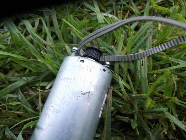

                  Amy jane September
                    @amyjaneseptember49770
                    Hi Bob, How's this for a timing belt?
                    From a defunct printer.

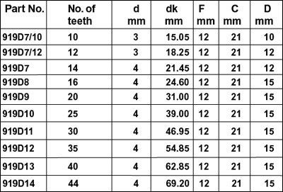

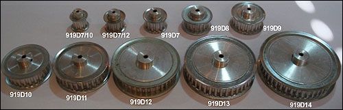

                      Here's a good source of timing belts and sprockets….
                      #50177
                        I have seen other twin-motor drives, one in a v large Severn, and no mention was made of imbalance between the motors. I think there will be no problems but a check on each motor with an ammeter may be in order when loaded in case.
                        Those belt drives are expensive or were last time I looked. I like the chain, looks more "mechanical"

                          All that will happen if there is an imbalance is that one motor will want to rev faster than the other. That will cause the slower motor to be under less load and consequently it will run faster. The net effect is that both will run at the same constant speed with no problems. All that will be found is that one will draw less current than the other.

                            I agree with you Mike but my point is if you are only applying power to one motor what is going on with the other. If you spin a dc motor shaft I am fairly sure it will behave like a dynamo and produce a voltage at the terminals. What effect this will have on the esc I don't know.
                            #50188
                            lnvisibleman
                              @lnvisibleman
                              I totally agree, it essential that both motors are working and not just one under power or the unpowered motor will certainly act s a dynamo.
                              Are we looking at perpetual motion here ????

                                      Concerning the two engines on one propshaft: No problem at all, it has been done before even on commercial units (such as the Hydrospeed drive as featured in the Graupner Systems cat, with two Speed600's).
                                      Powering only one of the two engines is a huge waste of energy, as this one engine is now powering both the propshaft and the second motor, which in turn effectively acts as a nice mechanical heating mechanism. With the added hazard of overloading the powered engine, too…

                                                Bob – if two motors running against each other cause sparks over there, then either you are doing something VERY wrong while doing something very wrong. You should not run them against each other in the first place, obviously, but even IF you did that, then either your chain should snap or the motors would both stall and heat up until smoke was emitted heralding the tragic death of two brave E-motors.
                                                Sparks IMHO mean that your wiring is so bad that it is coming loose, creating spark arches….
                                                Paul, ask your wife – maybe she knows where you put that key of yours.devil
                                                Either way, the rule you are breaking on the perpetual motion thingie with two motors, is the one that says that the power input into a system equals the power output – and friction resistance caters for a bit of power output in the form of heat. Thus slowing the motors down until all power has been lost to the surrounding.
                                                Oh, and of course, if you have two engines wired up in parallel, which is sort of mandatory for this kind of experiment, and you power one of them – the second one will be powered as well, per definition of copper wires laugh
