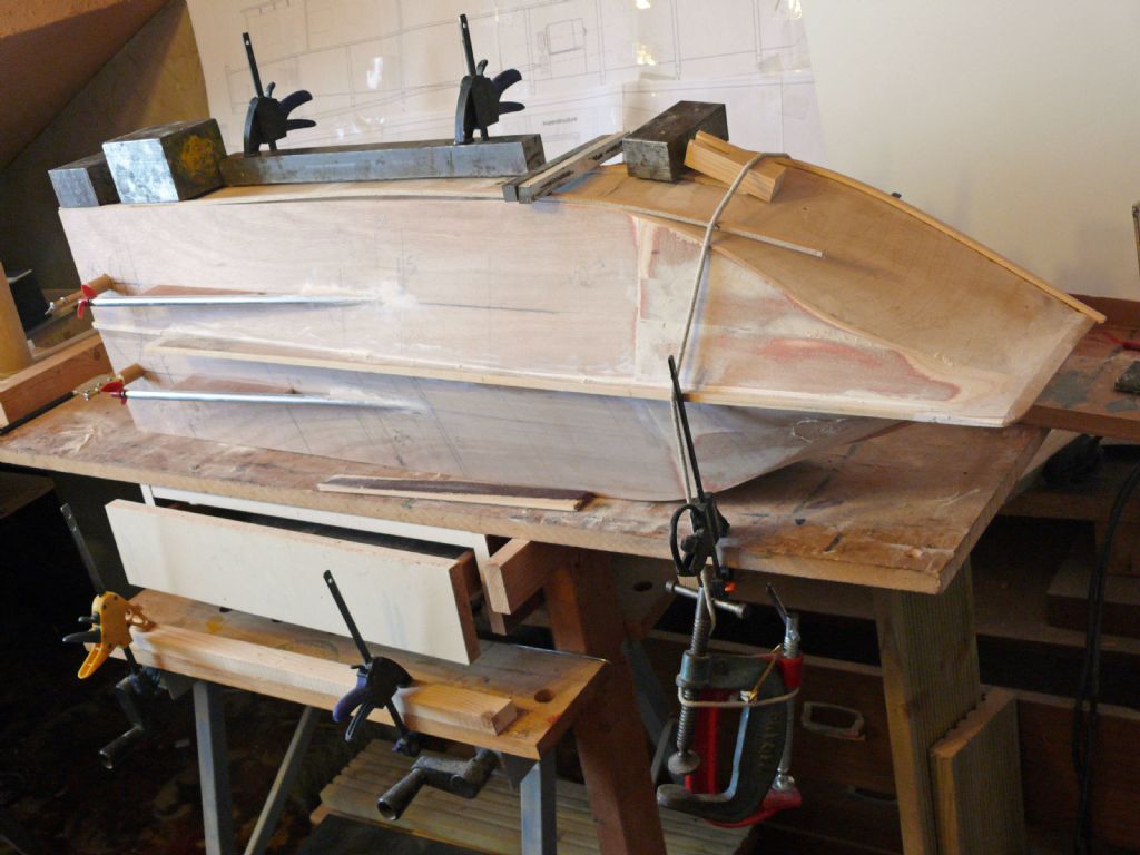

              The model is progressing well, with various bits and pieces being added daily
              Just adding the wooden Go Faster strips at the moment, before painting the hull etc
              Note how handy the G-Clamp clamp is, for handling curves?

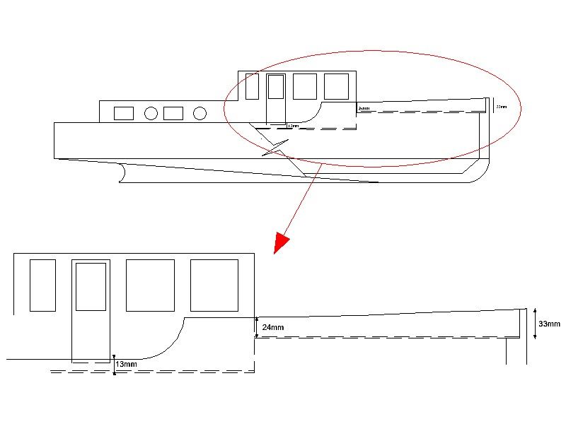

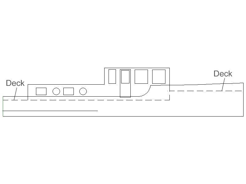

                    For the first time ever I'm not sure about your creative alterations to a design, on the original drawings the forward hull sides came up above the foredeck and the forward hatch is smaller and acts as a rooflight, (which looks like a low greenhouse) for the cabin.
                    I didn't intend to have a funnel as this style of launch had a petrol engine with exhaust through the transom.
                    However this is only my opinion and my view might change when the boat is complete as you usually pull a rabbit out of the hat.
                    #72387
                      Now you tell me!
                      There are no side walls on my drawing and none on the full size boats either
                      See your early photos
                      I agree the hatch is over size……..I can easily reduce it at this stage
                      #72391
                        Hello Captain
                        I see the problem, when I first started this thread for the original VGC I said that the design was based upon The Sea Dog but I had taken some liberties with sizes and shapes. However you liked the The Sea Dog pictures so much that we decided to build the VGC in the same style.
                        I re-drew the project to reflect the changes so the recessed deck disappeared and things like the rear cockpit were added.
                        Your new VGC is a hybrid of both designs.
                        I looked through the first set of drawings and found this section:
                        #72395
                          No problem Paul
                          I'll sort it out at my end
                          We could do with a typical cross section of the model, for a better understanding of the intended build

                                Very sorry about the last minute design change, dated January 2013, please don't try to adapt the existing hull as it might ruin all of your hard work.
                                Unlike some scribblers I'm not bothered about any changes to my designs besides, as Ashley says, its your boat and you can do whatever you like.

                                  I think the deck walls will be a welcome addition to the simple appearance of the model?
                                  I'll knock up some temporary mock ups to see how she looks
                                  Nothing ventured, nothing gained…….As they say
                                  What are the dimensions, please?

                                    Some basic dimensions.

                                      Many thanks Paul
                                      The trouble is………I've already jumped the gun and made a wild guess
                                      At heights………..Half your figures!
                                      Crumbs!…….What now?
                                      #72437
                                        The dims are based upon your build being 1m long, which is a guess on my part as I'm not sure what size your boat actually is.
                                        #72440
                                          Hi Paul
                                          Not really a problem, I can either leave it as it is or add to the wall height
                                          The model is 1000mm overall and my heights are 12mm for the main deck, with 16 and 22mm on the fore deck

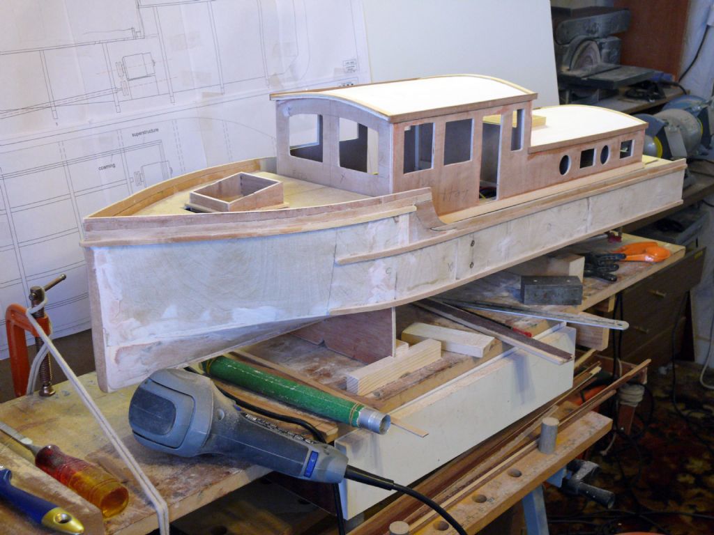

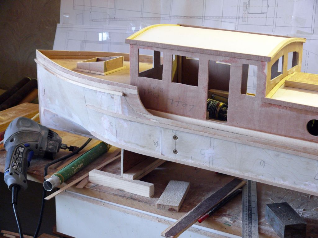

                                              Latest state of play……
                                              Built up the side walls and modified the fillet
                                              Capping yet to be fitted

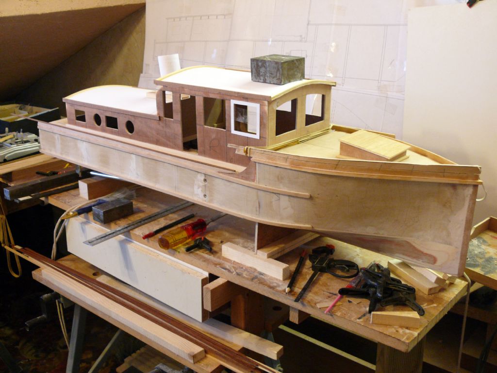

                                              #72549

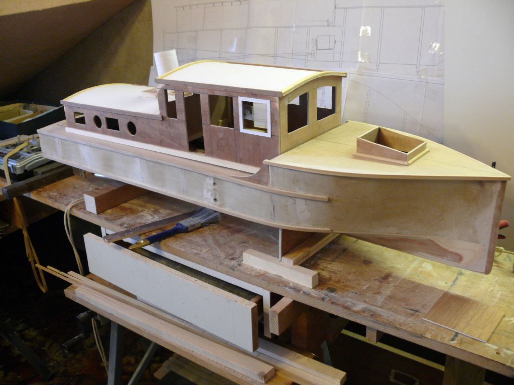

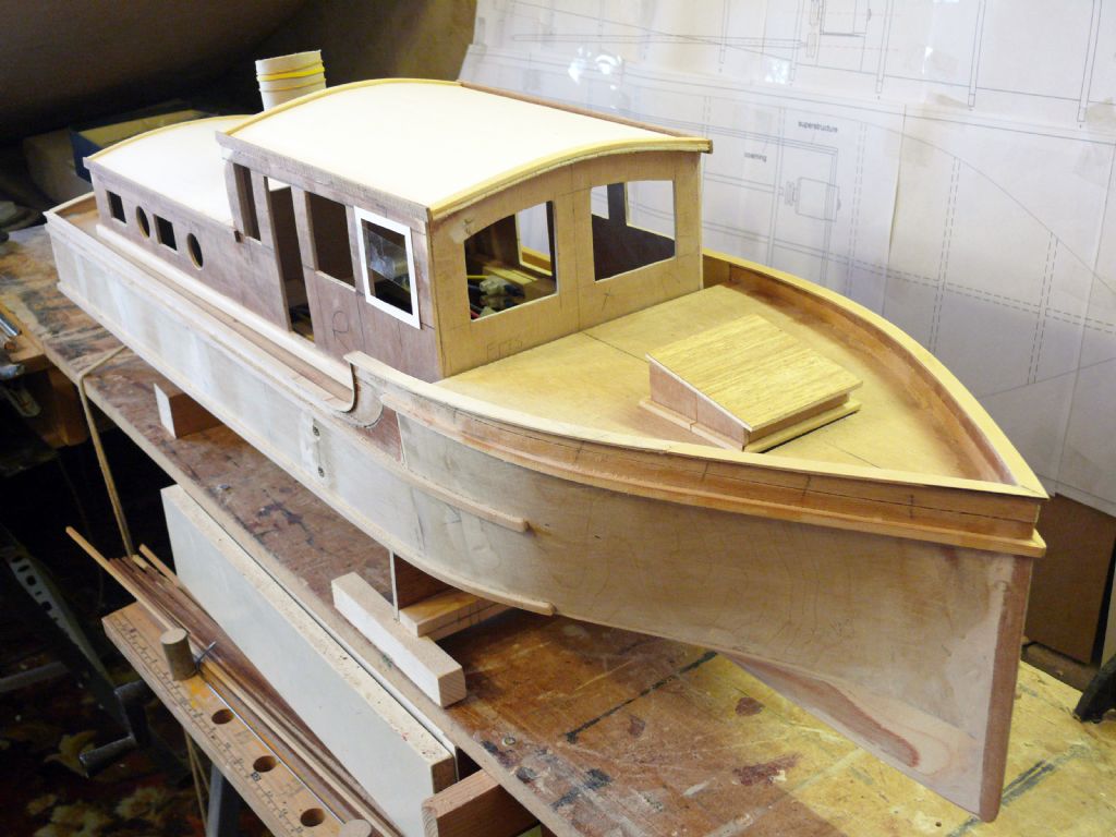

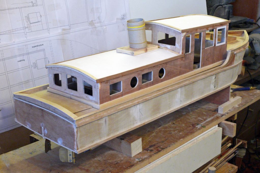

                                                Finally completed the side wall capping
                                                #72557
                                                  Drawing Office to Workshop
                                                  The capping is looking good especially in the area of the deck step as you have turned an awkward connection into a very nice detail.
                                                  Good to see that you are employing a decent craftsman.
