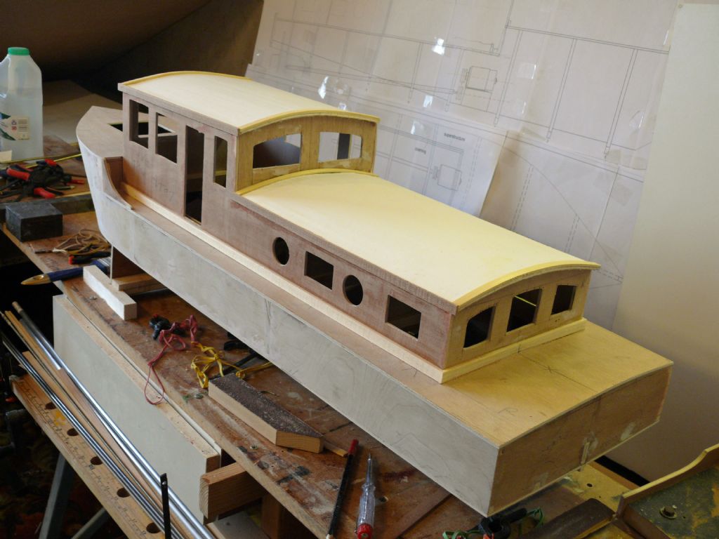

        Just finished the cabin planking………That Quirky Glue seems to have done a good job
        Now, where did I put those blinking G clamps? Been looking for them, all day
        #71912
          The cabin roofs have turned out quite nice?
          Great fun easy planking project

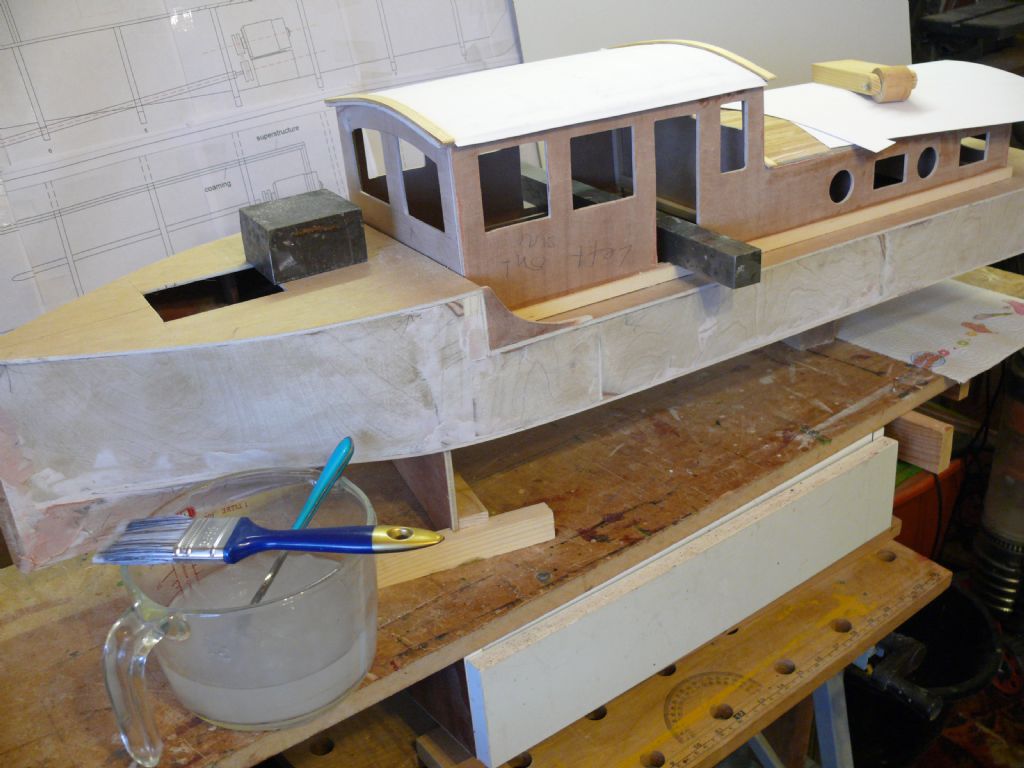

            The moment of truth………
            It took some nerve, I`ll tell you…..
            When Father Papered the Parlour….etc
            Dabbin it `ere, dabbin it there, paste and paper everywhere!
            There won`t be many chaps out there, familiar with this song?

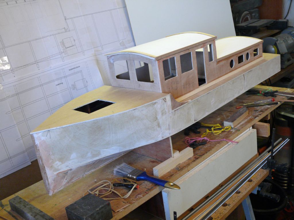

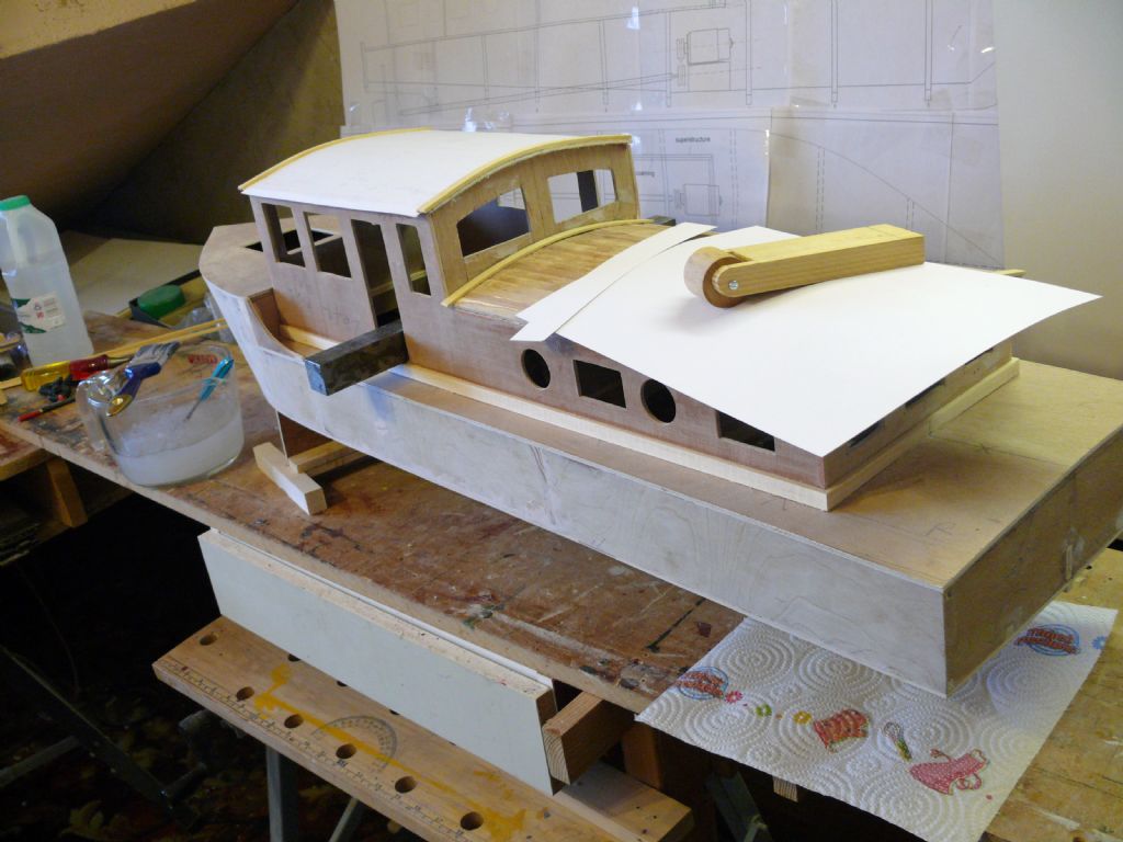

                      Welcome back, Geoff and also our loyal band of build followers
                      Working on the roof still and it`s looking good
                      It would be very nice to see a few more builds being posted?

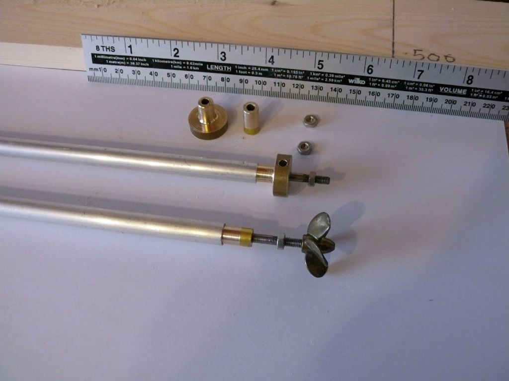

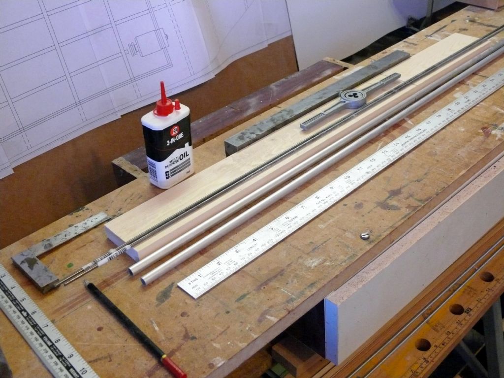

                            Now for the Prop Shafts
                            Two 500mm Prop Shafts would cost about £40.00 and I want them…..Now!
                            So I decided to make my own……….They are quite easy to make on the Lathe and it`s very satisfying to see the finished items, especially when the materials only cost about £8.00
                            First picture……..The materials obtained from B & Q
                            I`m using BDMS bar for the shafts……..It`s cheap and easy to thread compared to Stainless Steel
                            2nd Picture
                            The parts……..The brass bushes will be pressed in to complete the job

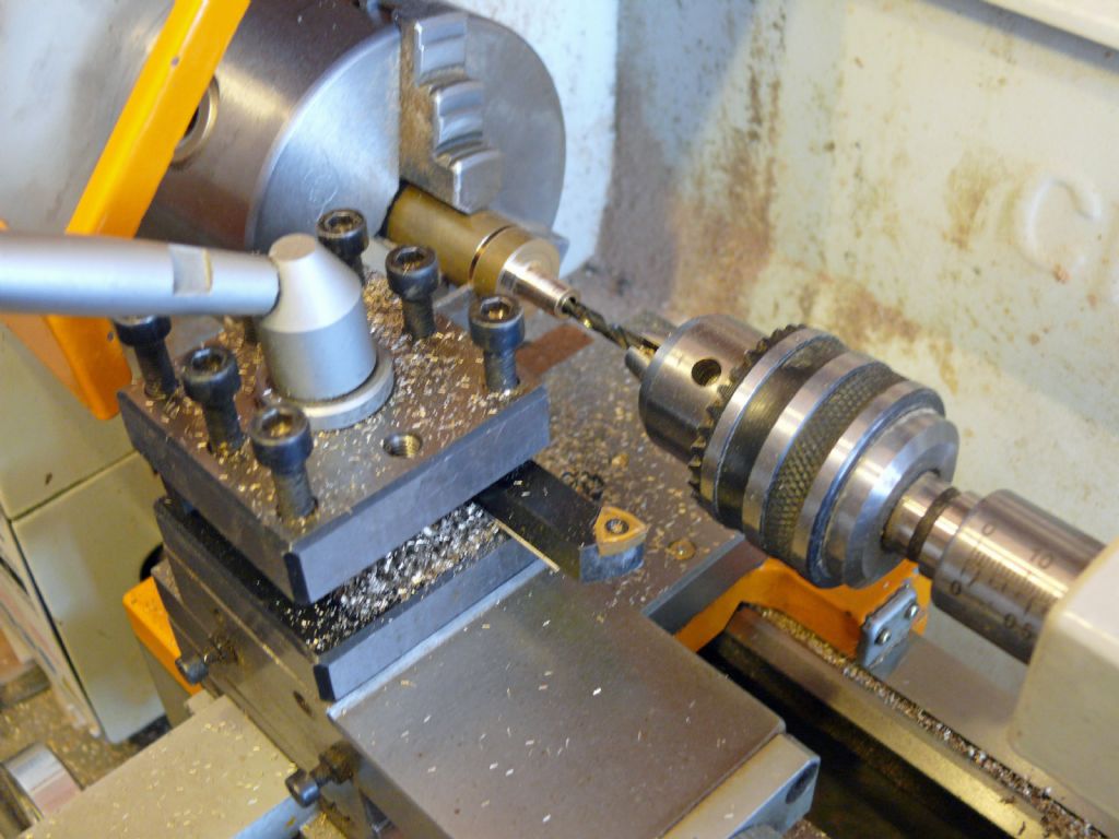

                              Just a photo of the Oiling Bush being parted off in the lathe
                              Note the drill being used as a support and catcher

                                Hi Bob
                                Are you going to drift a bearing down into the middle of the Ali tube as a 20" shaft unsupported might whip around in the tube? If not I'd definitely prime & paint the BMS shaft cos it'll will rust fairly kwik.
                                #71969
                                  Hi Ray
                                  I knew that was coming!
                                  I've weighed it up and decided not to go to the trouble
                                  The larger VGC has Prop Shafts about 36" long and they don't appear to whirl
                                  There's not much of a rust problem,with all that grease and oil slopping about
                                  #71973
                                    Its probably a mute point but why did you opt for bright bar rather than coated and pre-threaded stud bar?
                                    #71976
                                      Hi Paul
                                      I also bought two lengths of dead straight 4mm screwed rod, which was also galvanised, but also bought the bright bar as an alternative
                                      I thought the screwed rod would be a nice crafty solution………..But what have we overlooked?………eh?
                                      The screwed rod would not be watertight!………Phew !……That was a close one !
                                      #71977
                                        Why would stud bar not be watertight?
                                        #71978
                                          I would think that the water would get passed the thread somehow?
                                          I could have got round it, I suppose
                                          Looking at the finished Prop Shaft, I can see a minor problem………Can you?……..
                                          Because the Prop Shaft has a big head……..I can't get it in the hull!
                                          Time for Plan B………..Where's that kinky saw for special occasions?

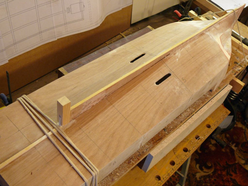

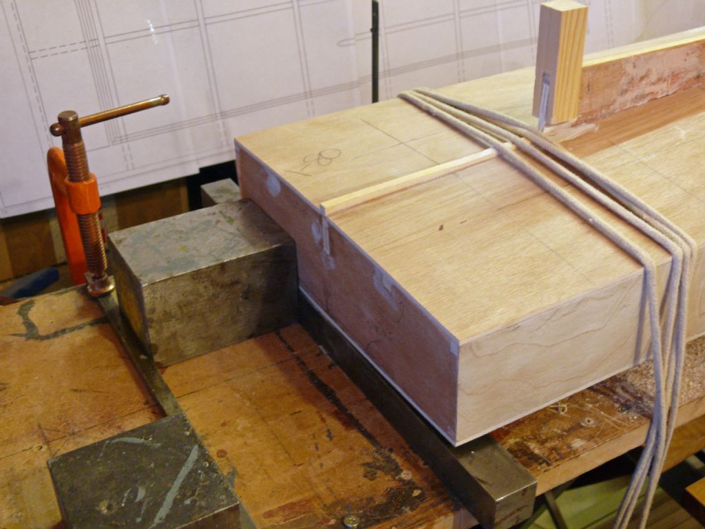

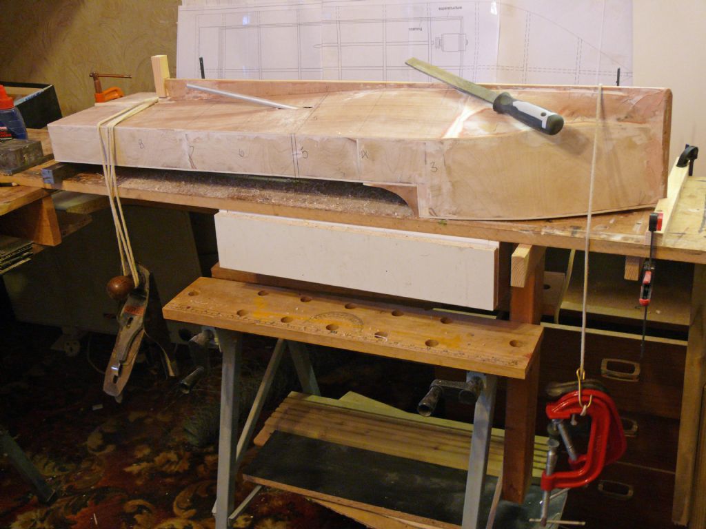

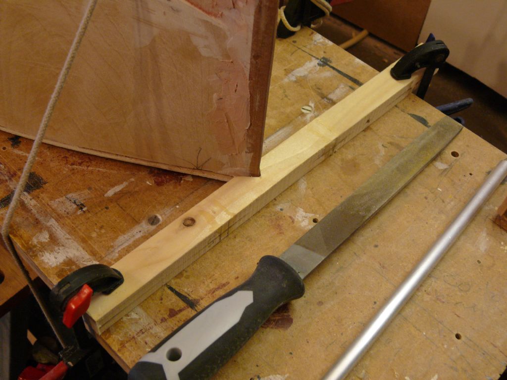

                                                    It`s now time to cut the slots out for the Propshafts……….They were carefully marked out on the hull bottom as per Paul`s lovely Cad drawings
                                                    Needed to hold her still during the operation, so out came Newties Clamps again, plus novel location features, Fore and Aft
                                                    See photo of Hull, hog tied to the bench
                                                    I said I needed the Prop shafts today
                                                    A very satisfying day today
                                                    Edited By Bob Abell on 21/07/2017 20:05:00

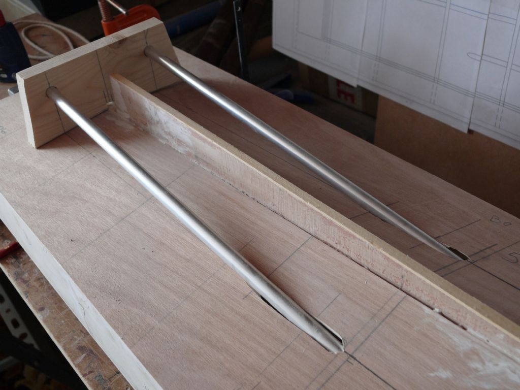

                                                    #71996

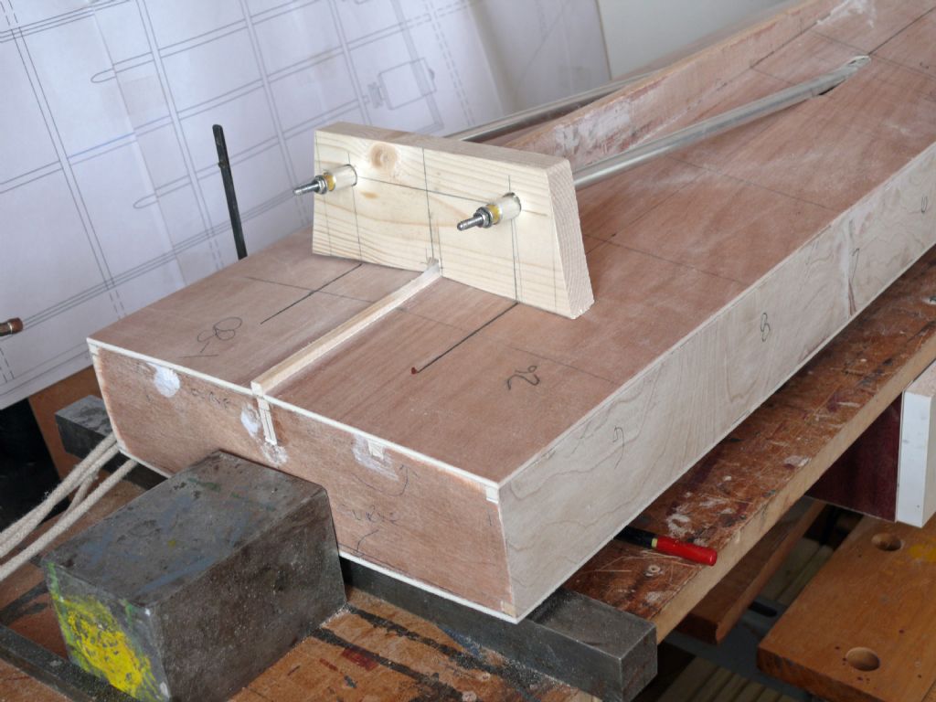

                                                      To align the Prop shafts, I always make a tube jig
