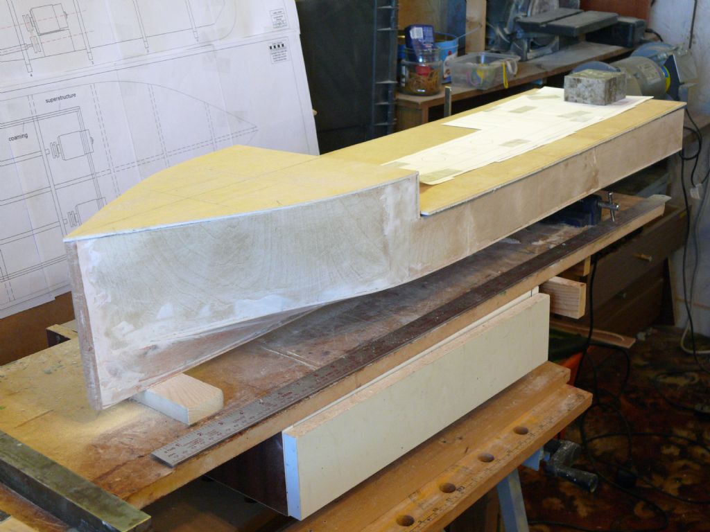

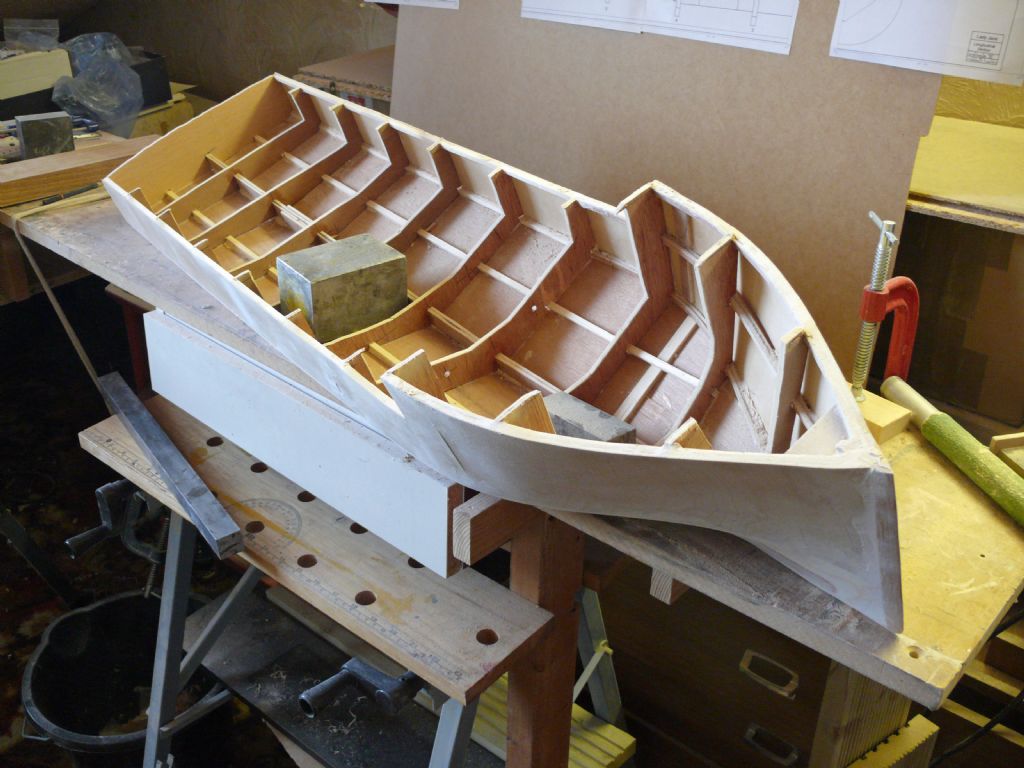

      Decided it was time to break free from the Build Fixture
      The hull feels as light as a feather now
      #71727
        There's no material in the hull to screw into
        Not to tell you how build but I usually screw the skin to the frames and stringers wink
        The bow looks great and the hull is spot on, have you decided on the engines yet?

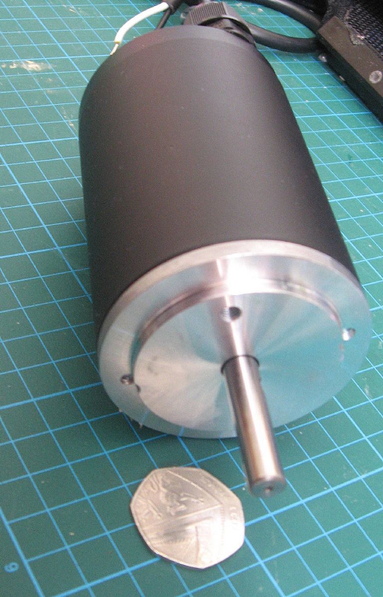

            How about one BIG motor?
            I got this one when I was trying out tug motors and it is now surplus to requirement.
            24v and enough torque to break your wrist.
            With this the model could tow the Etherow dinghy with both you and Duckie on board.
            Edited By Paul T on 05/07/2017 16:03:17
            #71735
              Wow…..That's one big motor!
              A fine time to suggest ONE motor……Having not put a hole down keel?
              What are the dimensions?……I could always fit a belt drive

                Dont worry as its not built for speed, the specs are as follows.
                24v DC, No load current 1.5A, Nominal current 3A,
                Nominal speed 3200rpm.
                The water resistant can is just under 100mm long and 65mm dia,
                Waterproof gland type cable seal
                The 8mm shaft extends 30mm
                Motor weighs 1150g

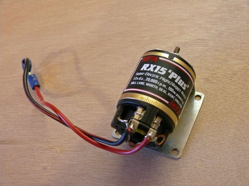

                    Hi Paul
                    I`ve just come across the original motors out of Brutus
                    They are too good to ignore………
                    MFA RX15 Plus……..With unusual mechanical speed adjustment and matching ESC too
                    7.2 volts………..20,000 rpm………190 watts
                    It`s a shame not to use them

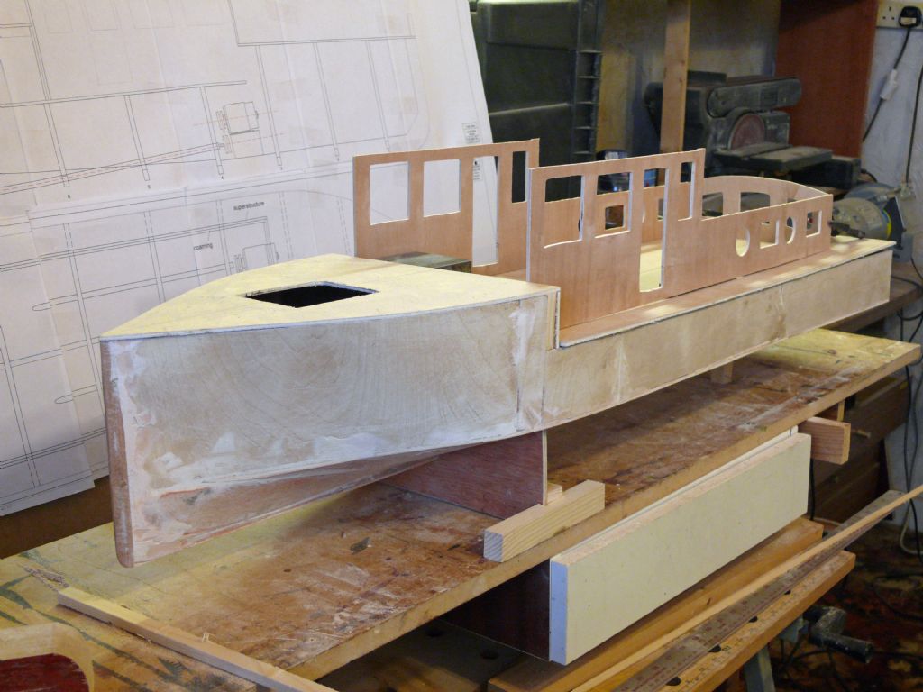

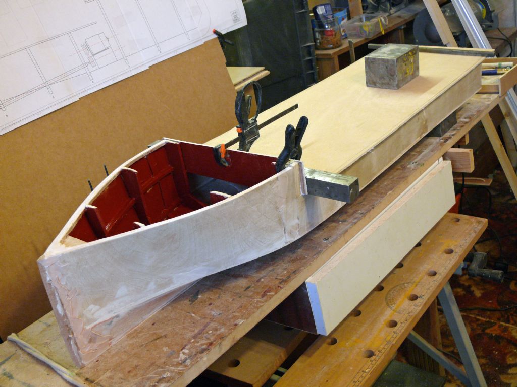

                      Work in progress picture
                      I`ve sealed the Bows end before the fore deck is fitted
                      And a picture of the proposed motors, just for your interest
                      #71762
                        The RX15's were a little under powered in Brutus so they should be ideal for this sedate river cruiser.

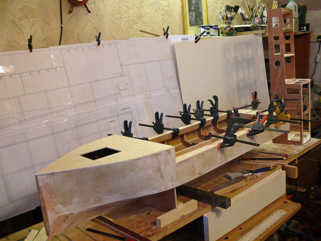

                          Glued the foredeck in place now and have the main deck roughed out
                          The model is quite simple, but I`m really enjoying the build
                          Ideal, when one`s wife is glued to the telly, watching, Wimbledon, Tour de France and Athletics!

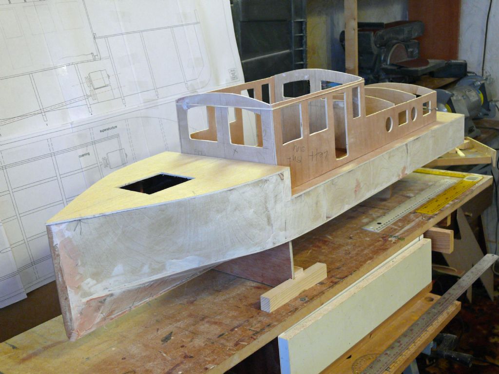

                              Work in progress
                              Not very exciting, but the build followers out there, will find it of interest
                              Paul…….Haven`t got drawings for cabin front and rear ends, please
                              I could easily guess them but we may as well work to the drawings

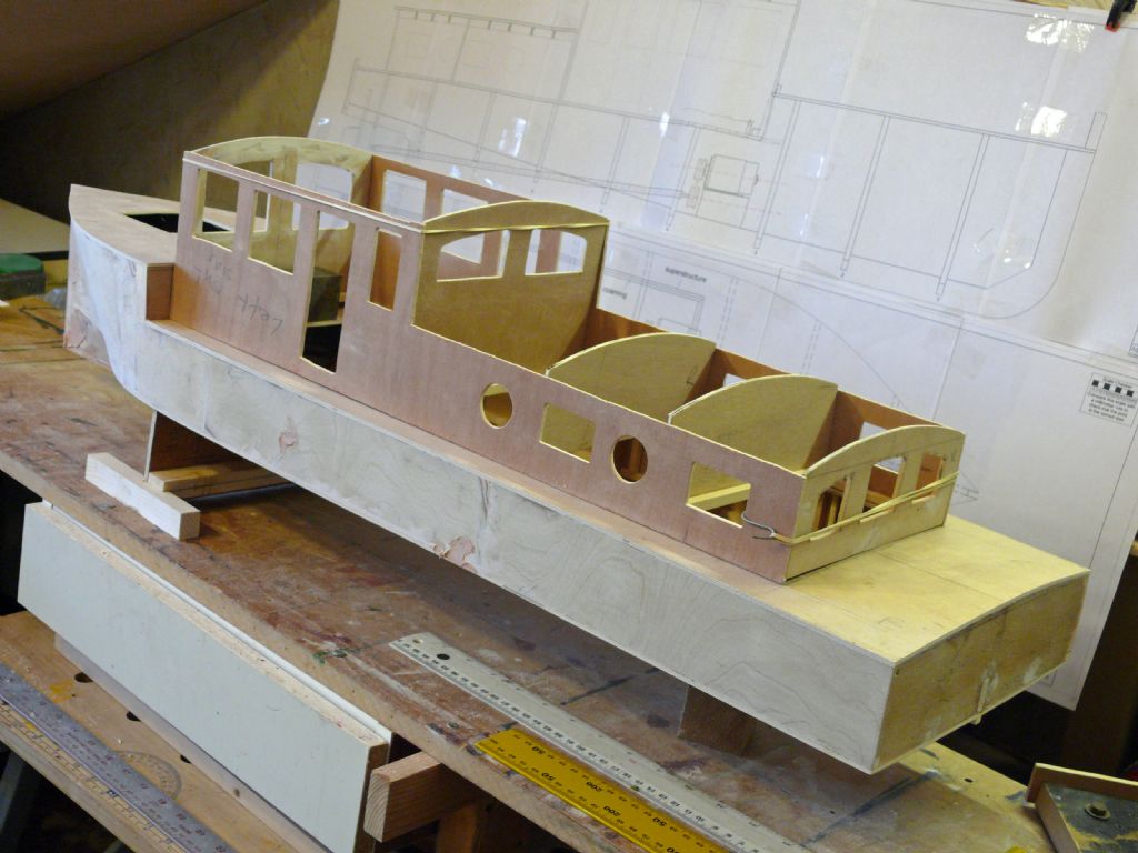

                                          Hi Paul……..No problem
                                          Here`s a dry set up……..I`ve taken the rear wall of the front cabin down to the deck for more support during trial runs
                                          Also added a 6mm x 6mm strip round the walls on the inside

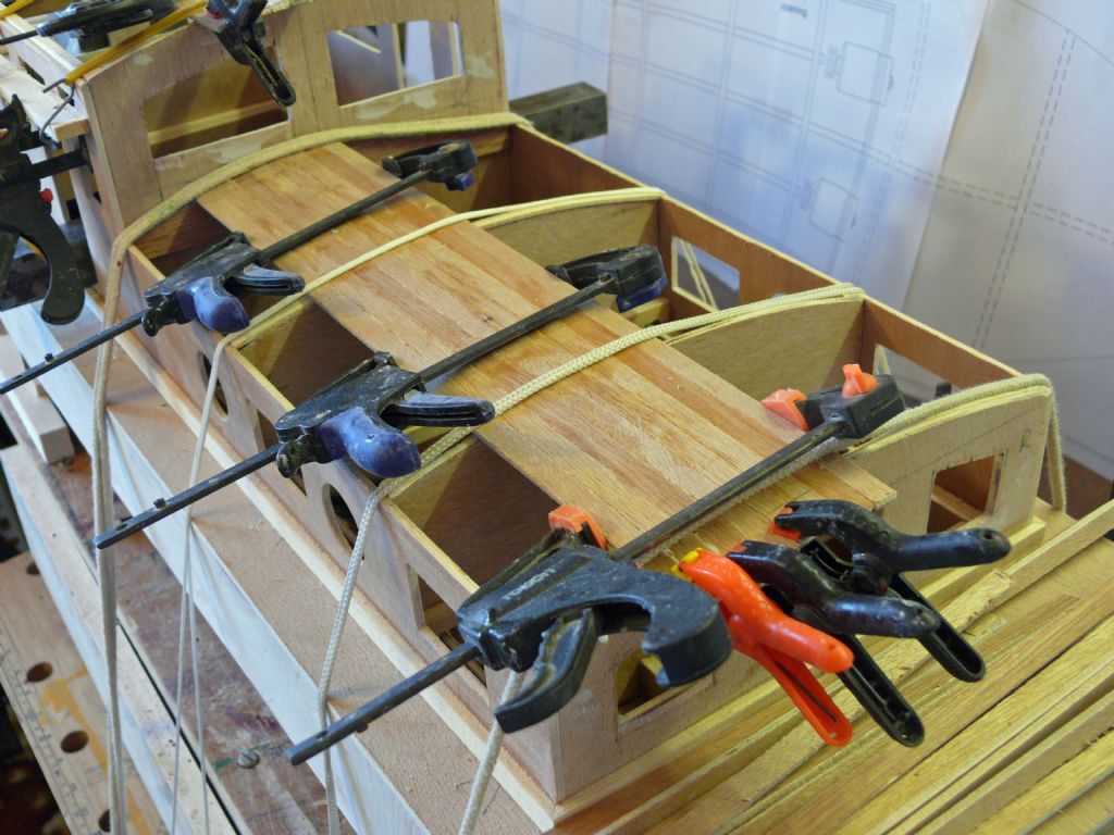

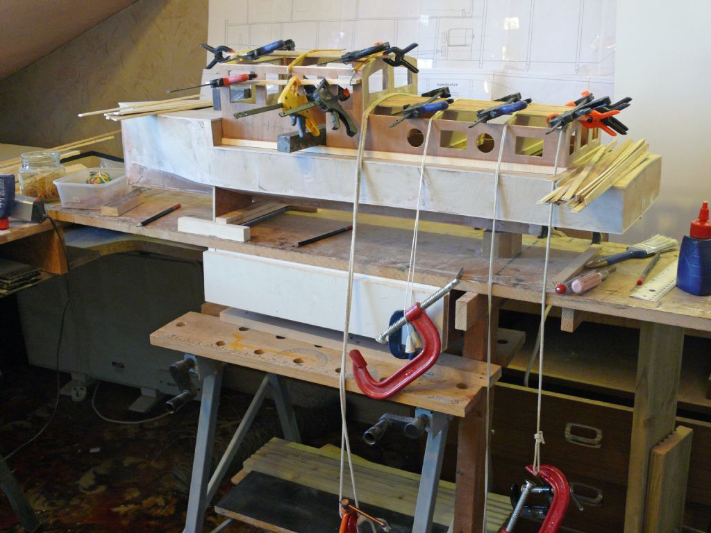

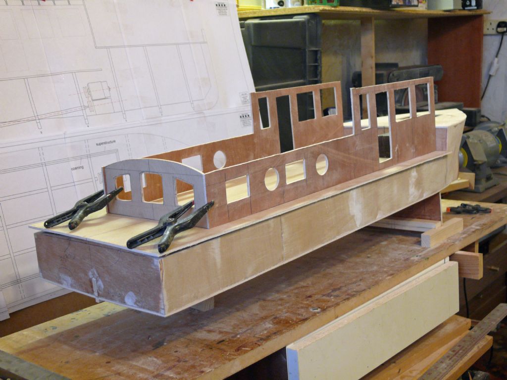

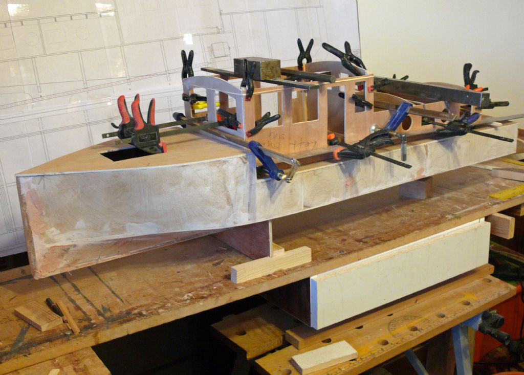

                                              Work in progress
                                              Won`t it be nice taking all these clamps off in the morning?
