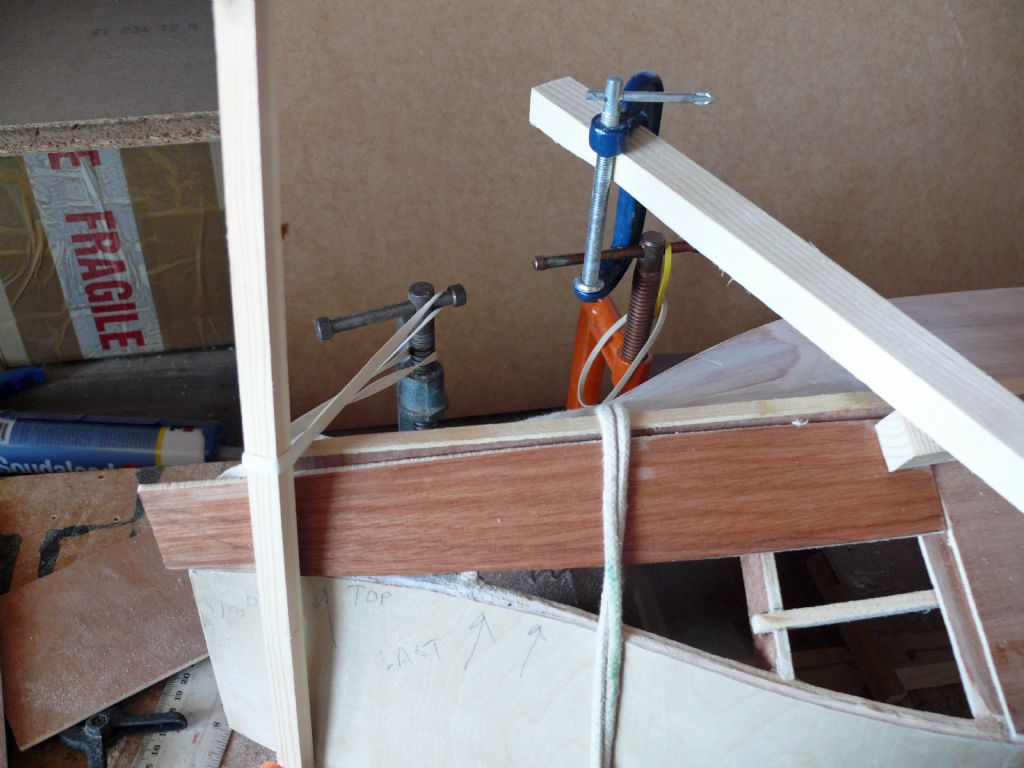

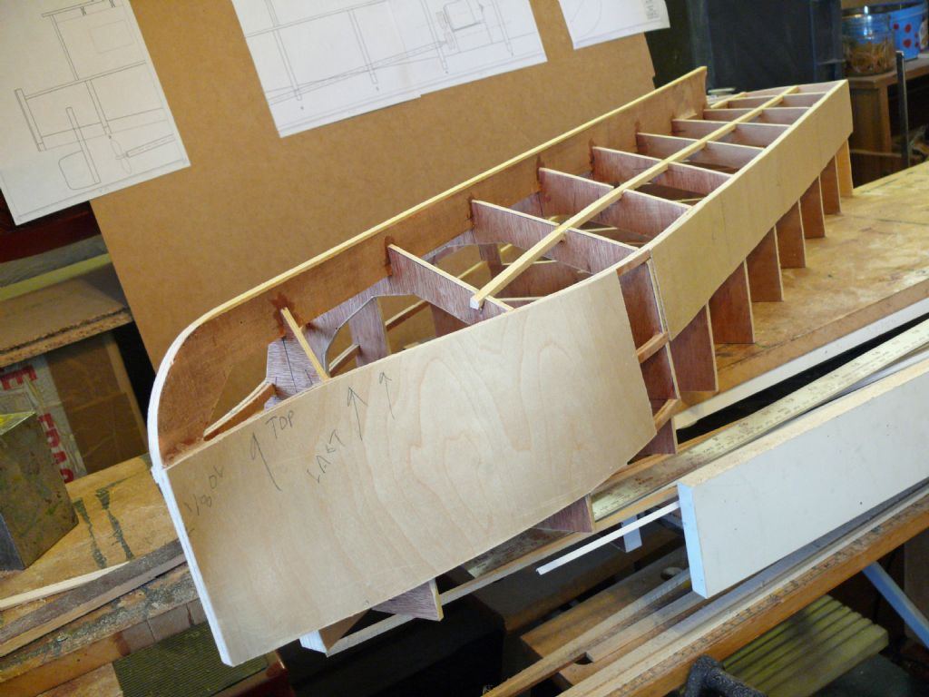

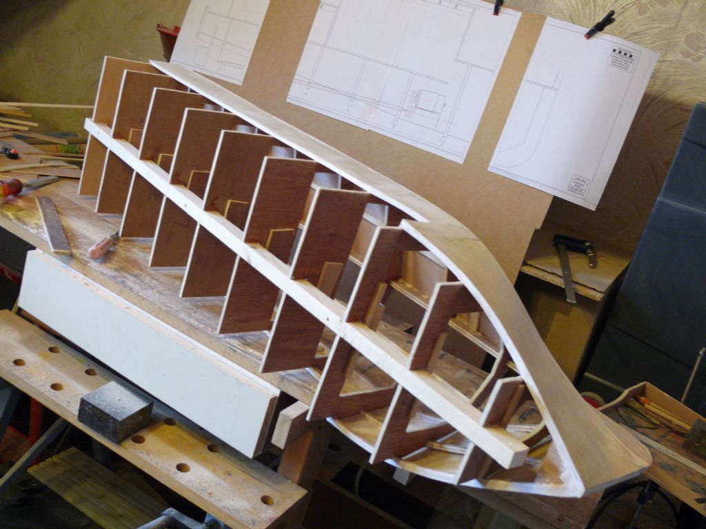

              #71590
                …….." then do what you want!"
                So I did……..Here`s my solution to the problem…….A thing of beauty is a joy forever

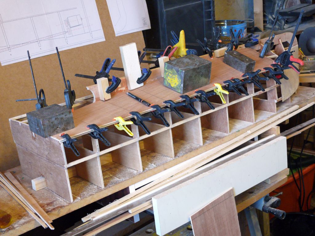

                #71600
                  I`ve called this photo……Friendly Persuasion………He He He…….(Fiendish laugh)
                  The Bow sheet is on the Rack at the moment with a good dousing every now and then
                  And is slowly coming round to my way of thinking!
                  Further sheeting work is under way at the stern, by that crowd of builders yonder, wearing blue jeans and orange safety hats……( Looks like it, anyway )
                  #71602
                    Hi Bob
                    I much prefer your nicely curved gunwhale stringer now, rather than you earlier concave job to the stem, perhaps you would enjoy double diagonal planking ? with thinner strips to achieve the compound curve at the bow, and does away with the built in stresses in the ply which really wants to be flat !! It might also slow you down and you wouldn't have the sheets to join in the topsides. What thickness ply are you using ?
                    #71605
                      Thank you, Ray
                      I haven`t created the run of the stringers……..I just joined up the notches in the formers
                      The top stringer was a little severe and since adding the 1mm ply sheet, the top edge has not followed the stringer too closely……..But looks ok to my liking
                      The hull sides above the waterline will be covered with decorators wall lining paper, as I did with the original Lady Joyce model
                      See original posts, on this thread for the nice effect, the paper created
                      Edited By Bob Abell on 27/06/2017 09:31:33

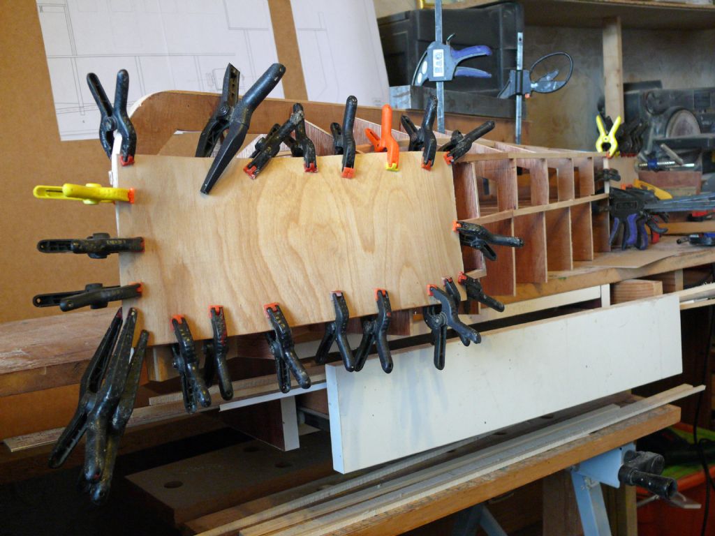

                      #71608
                        The Bows sheet cleaned up
                        #71619
                          Work in progess
                          Progress is relentless at the moment……….The 3mm bottom skin fitted easily over the framework

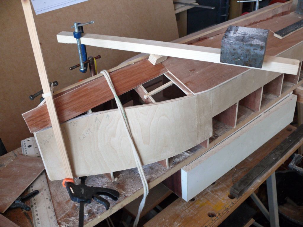

                              #71645
                                Hi Chaps
                                It`s Warts `n all tonight
                                Managed to sheet over the pointy bit……..And has turned out quite good, surprisingly
                                I`ve used 3mm soft ply and in parts, it was under tortuous forces of persuasion!
                                Only hope it doesn`t spring apart in the night
                                #71657
                                  Hello Captain Bob
                                  The ply should be ok providing it doesn't de-laminate. I didn't include this advice on the drawing but I always make sure the ply stays in place by using mechanical fixings as well as epoxy glue.
                                  Small brass screws counter-sunk into the ply and fixed into the frame not only make it easier to fit the ply, as they do the job of clamps, they also guarantee that the part won't fail when the boat is out on the water.
                                  #71658
                                    Thanks, Captain………That's good advice
                                    I'll put a few in, now that the forces have died down
                                    Welcome home Geoff………Like the new boat?

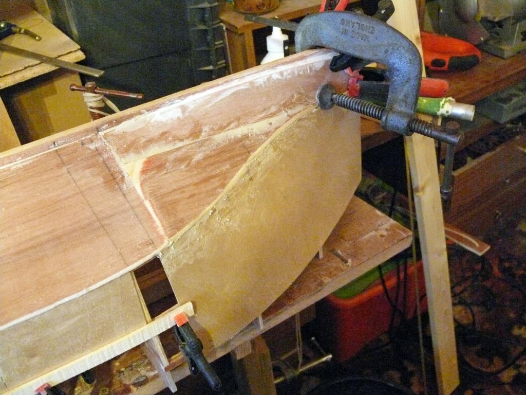

                                      #71678
                                        Hello Captain Bob
                                        Its looking very good especially from your first 'cleaning up photo' from this angle the bow looks as sinuous as I hoped it would.
                                        Could you take some more photos of the bow showing the curves please.
                                        #71679
                                          Hi Paul
                                          I`m pleased that the kinky Bows shape meets with your approval, it`s worked out really nice
                                          I`m working on the other side now and all the usual clamping areas are now covered over!
                                          Having to invent reliable alternative methods……….Will bring tears of joy to ones eyes!
                                          Pictures to follow
                                          #71680
                                            Hi Paul, Geoff and others
                                            The first piece is being wetted and twisted, but there are no gripping point now
                                            Having to resort to levers!
                                            The wood is under heavy pressure at the moment, I`m quite pleased with the method
                                            #71682
                                              To the Works Manager from the Design Office
                                              Not wishing to tell you how to suck eggs but you can use small screws as temporary fixings whilst the glue dries, after the glue is fully set remove the screws and fill the holes.
                                              With this method there is no danger of Heath Robinson being hit by flying elastic bands so the elf and safety man will be happy.
                                              #71684
                                                Small screws will not be strong enough
                                                Levers and heavy weights are best at the moment
                                                Nuts and bolts may be ok?
                                                #71686
                                                  You might be surprised to know that the 'pull' force required to make a 20 x 3 screw fail in ply is 0.6kN (135lbs)
                                                  #71688
                                                    Ground Control to Major Thom
                                                    There's no material in the hull to screw into………That's why I suggested nuts and bolts
                                                    The first piece being twisted at the moment, is as tough as old boots and refuses to knuckle under
                                                    The normal plastic clamps can't squeeze hard enough
                                                    But we shall overcome one day

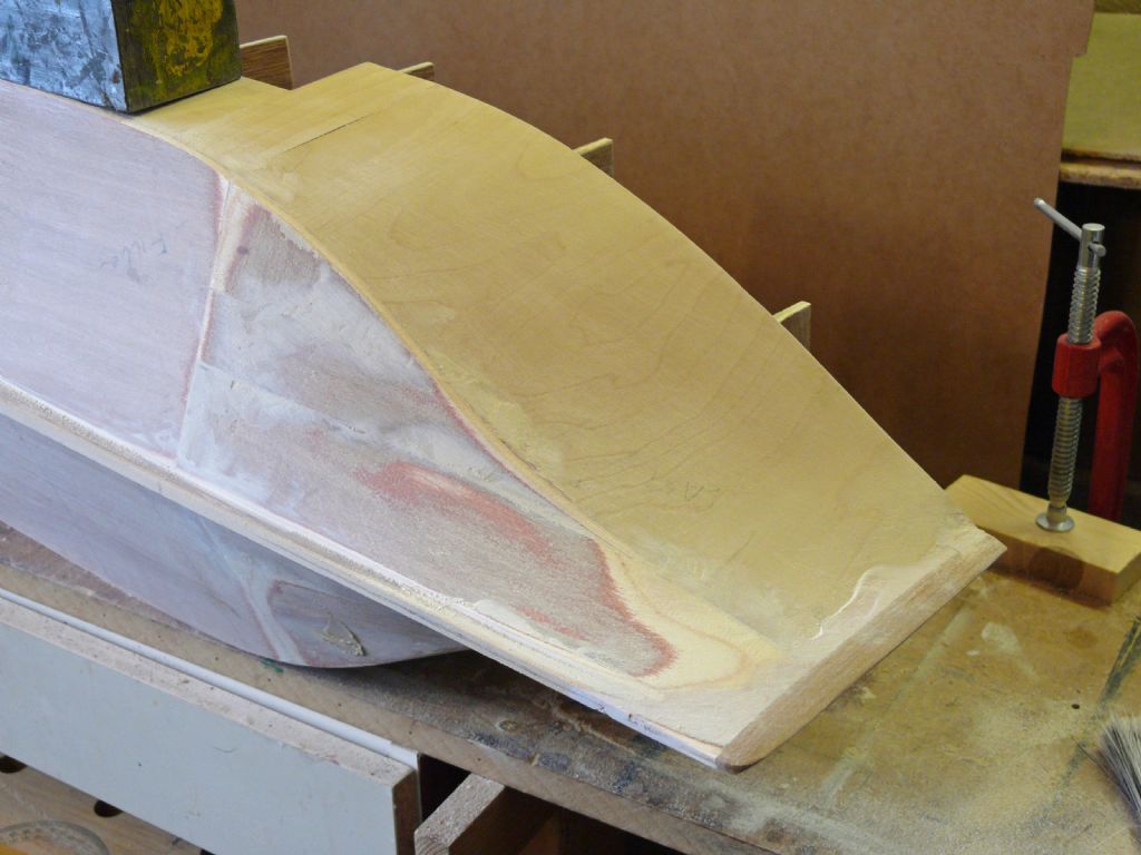

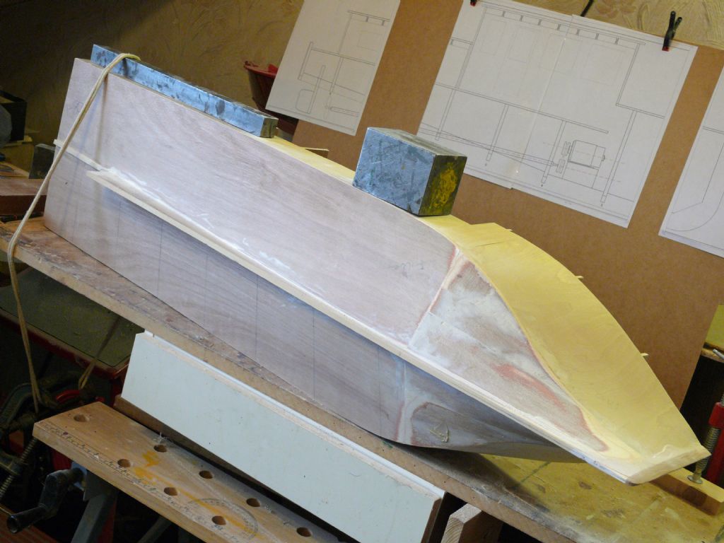

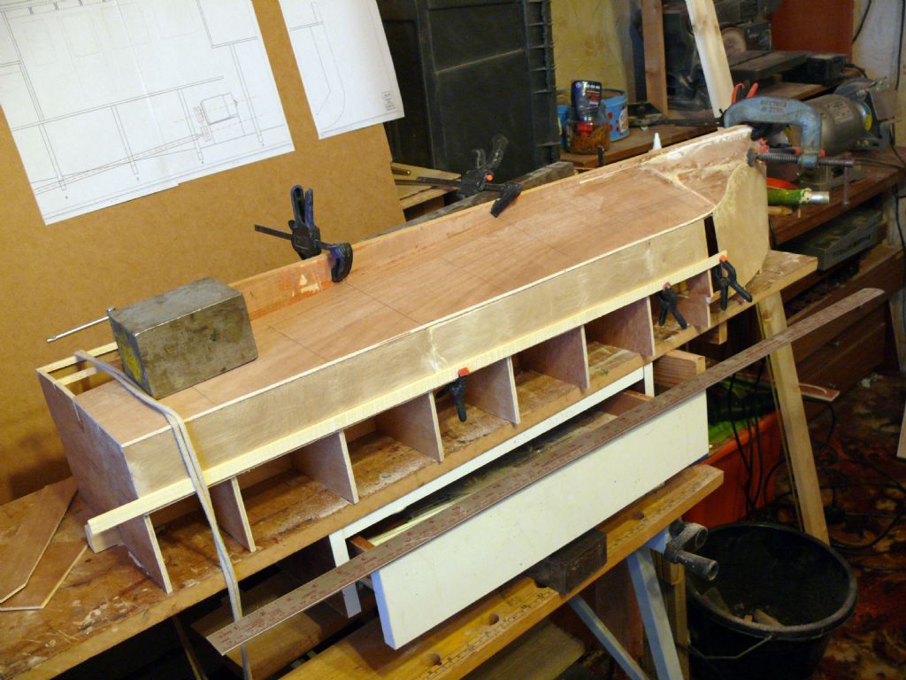

                                                    #71725
                                                      Work in progress
                                                      The smooth flowing contours are hard to make out at the moment, due to the camoflage effect
