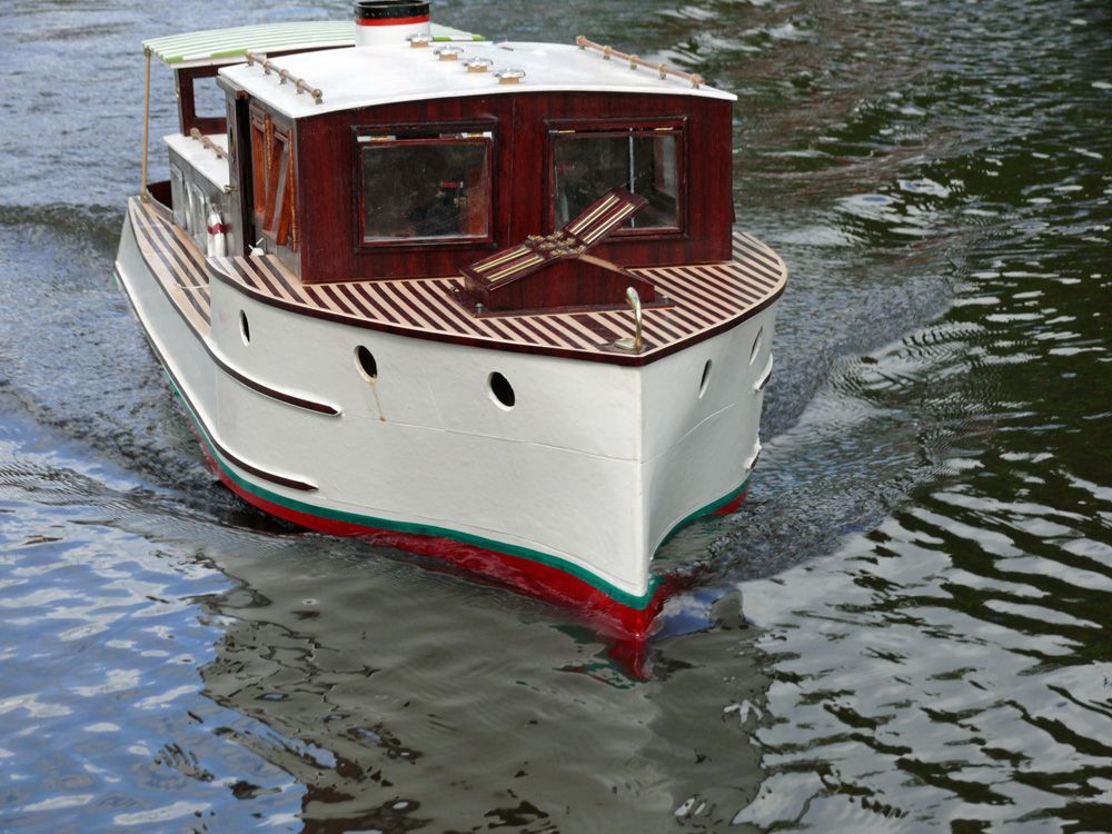

      Hi Ray
      Proof of the pudding……..
      Lady Joyce is galloping along here, but the bow wave is hardly breaking into a sweat………Nautical term

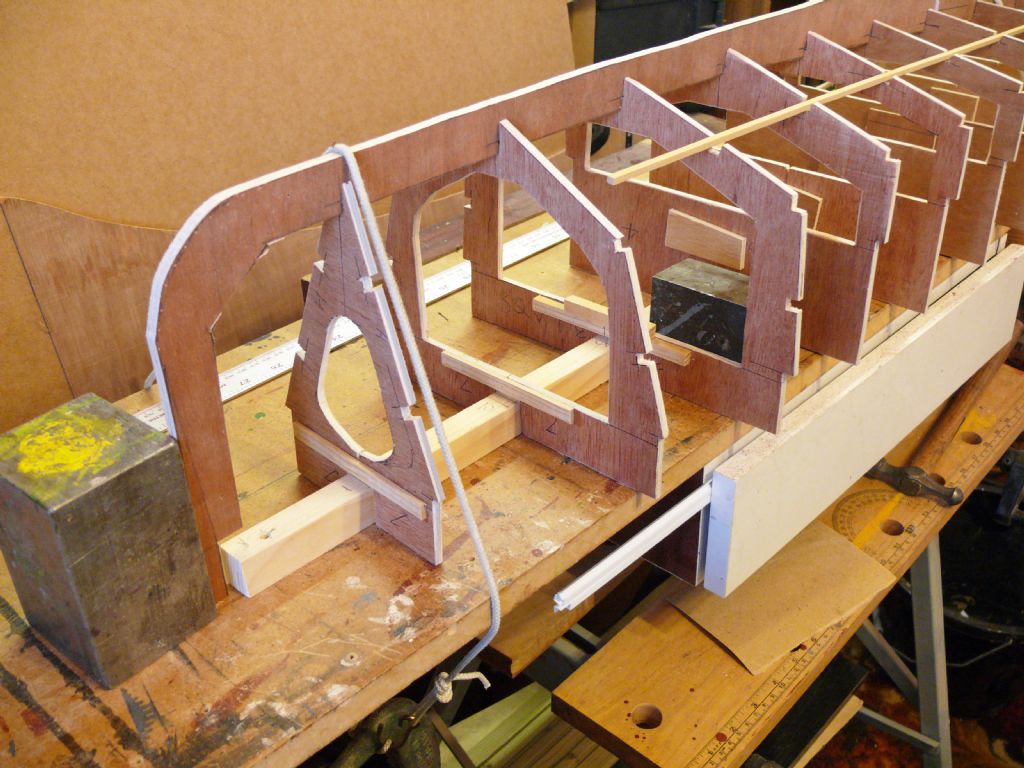

              #71495

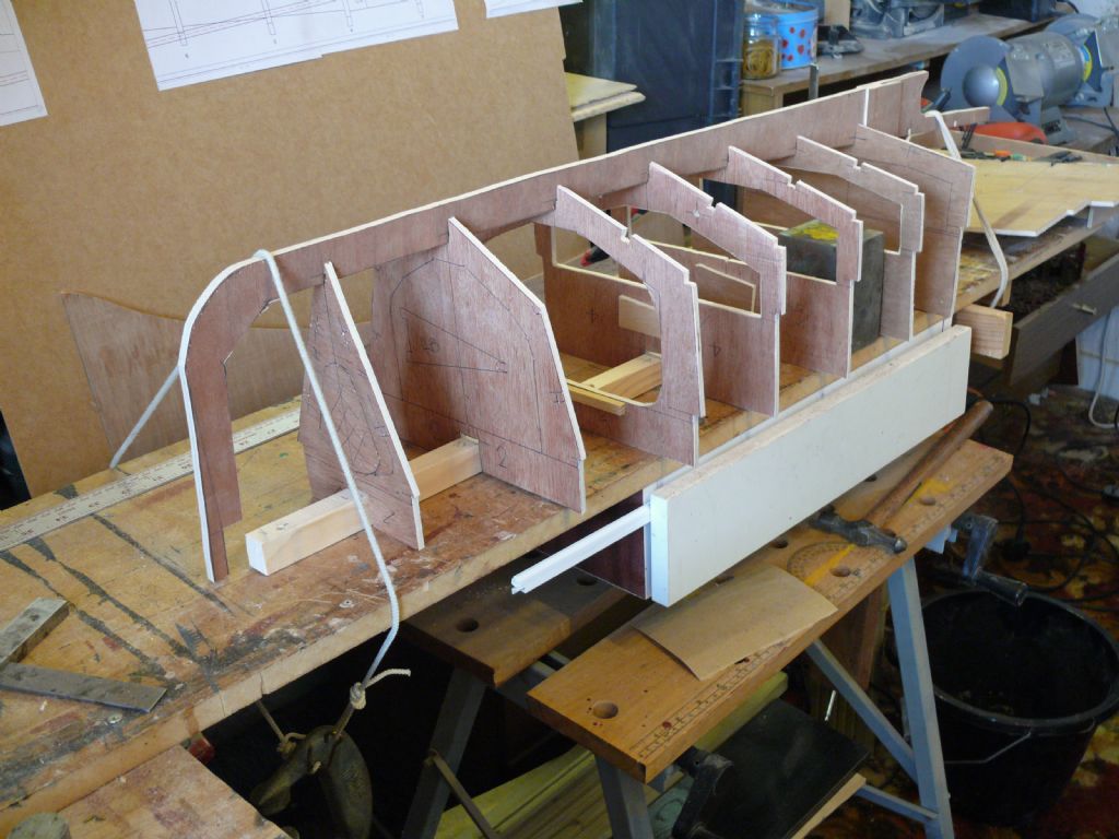

                Just a work in progress post
                Working down the framework, trimming up the formers and checking for squareness
                I like start off right
                Squareness, parallelism and true alignment etc are essential ingredients to the build
                Sorry to keep harping on about it, but this advice is for those out there who like to see attention to detail

                    #71513
                      Sweat Shop to Sweet Shop Manager
                      Former 2 is crying out for another stringer notch……..See photo below
                      What would Kevin do, in this instance?

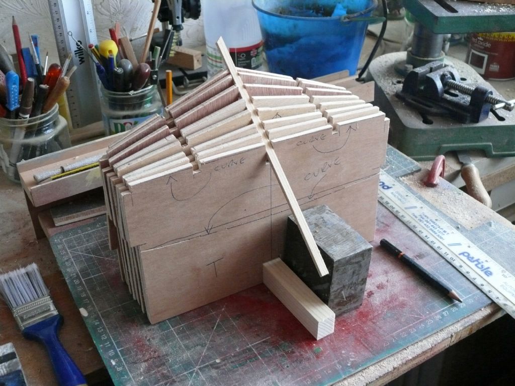

                            #71535
                              It`s a good idea to gang up the Formers into a block and check for discrepances
                              But in the days of CAD, faults apart from builders errors, are quite rare

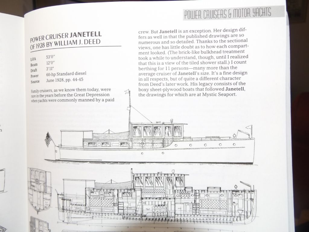

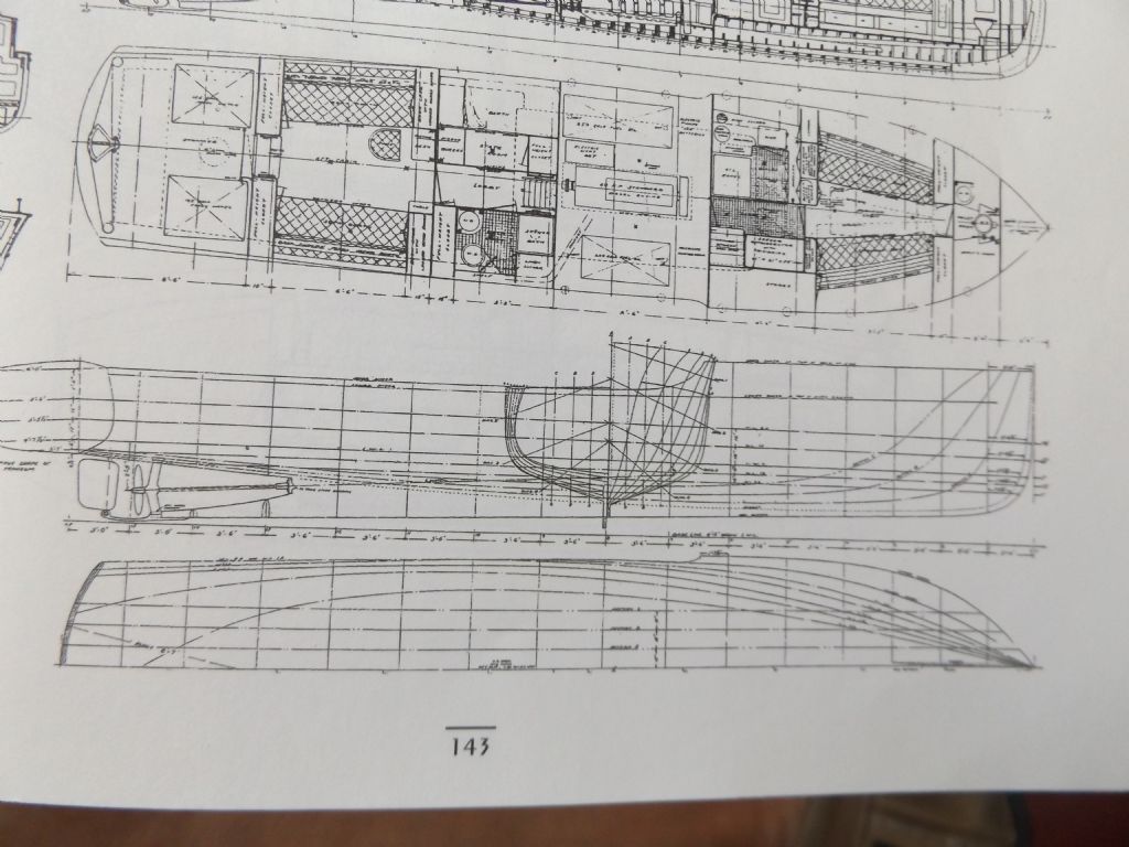

                                hms belfast visitors centre june 17 020.jpgHi Bob
                                These drawings are of a cruiser that's a close relative of you boat, taken from an excellent book of American boat designs from 1897-1942 "Designs to Inspire" by Anne & Maynard Bray. So many boats to build and so little time
                                #71537
                                  Thanks for the info Ray
                                  The upper drawing looks very similar to the VGC
                                  I suppose in those days of cruiser design……..That was the style of the times?

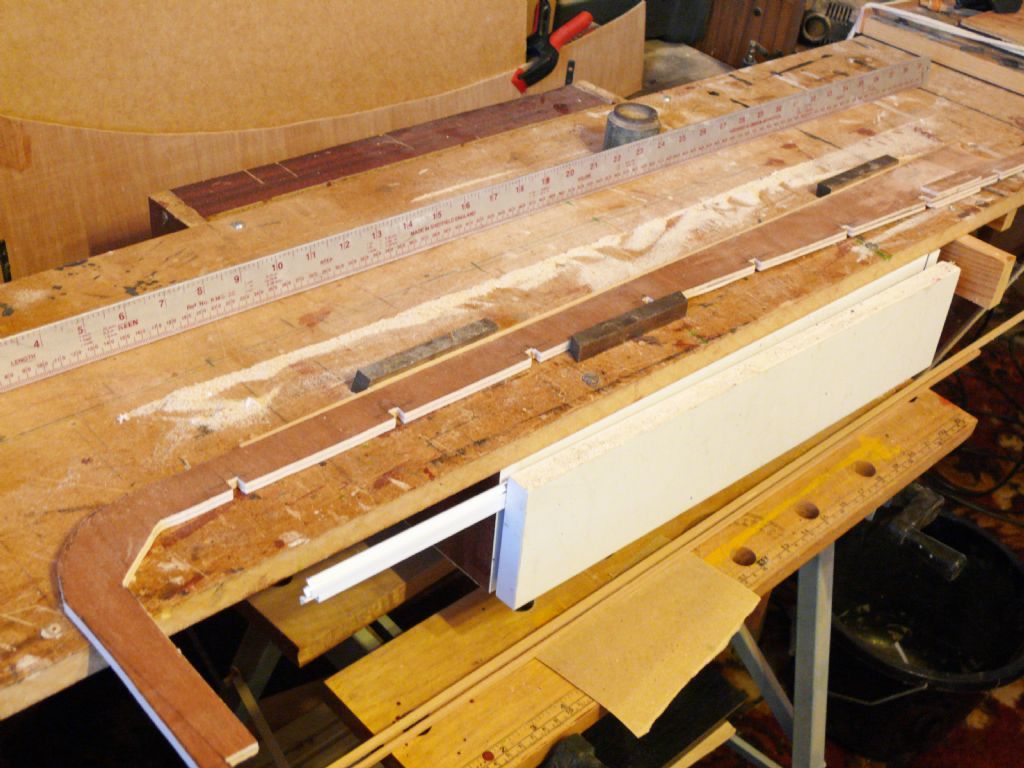

                                  #71538
                                    Hi Kevin
                                    I needed a true flat surface to produce the keel bottom edge, as I intend to glue a hardwood strip along the bottom edge, to hide the ply layers
                                    To check for flatness, swipe a straightedge across the surface and if the surface is flat, you will hear a squeal
                                    I`ve sprinkled some sawdust to illustrate the action
                                    To some members, this may sound a bit OTT, but what`s the point of a Datum edge, if you can`t trust it?

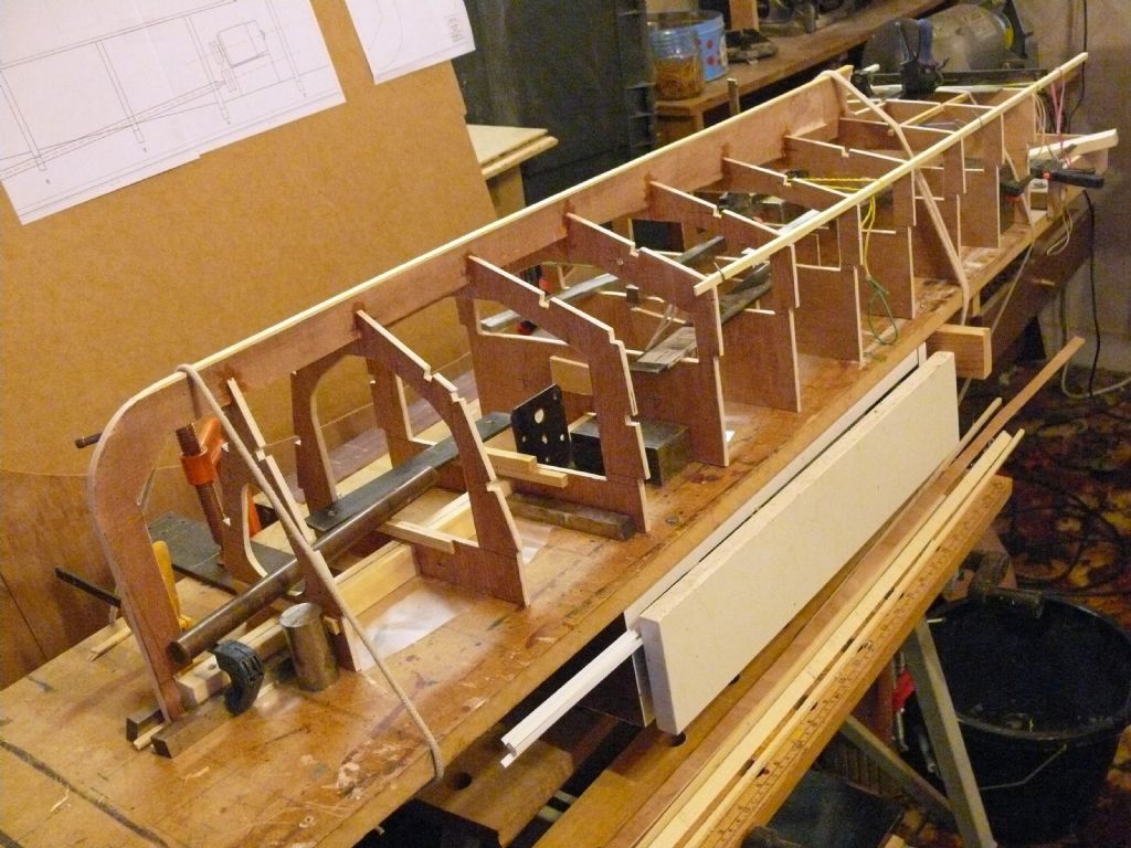

                                    #71543
                                      There we go, boys……….The Third dimension sorted and glued
                                      I like the idea that the setup is not screwed down at the moment

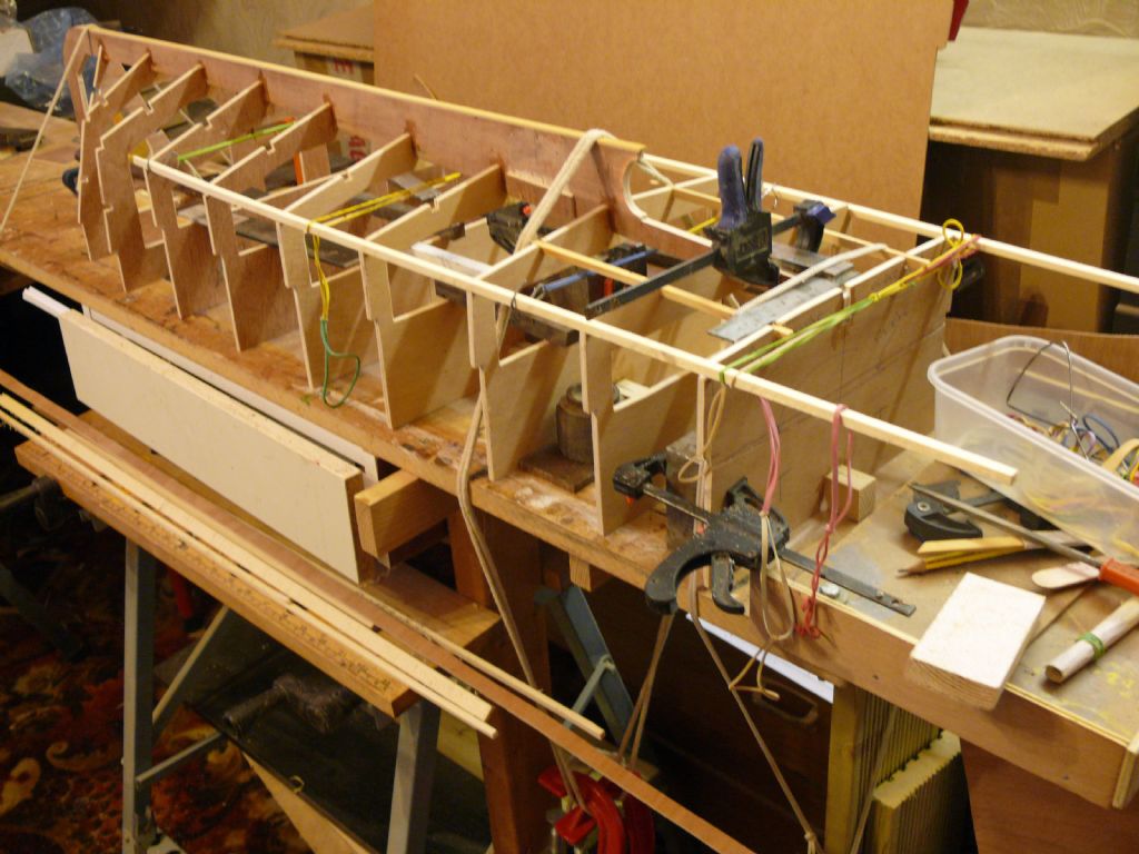

                                      #71549

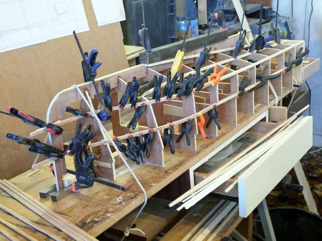

                                        first stringers 1.jpgManaged to fit a couple of stringers to firm up the framework before the glue dries

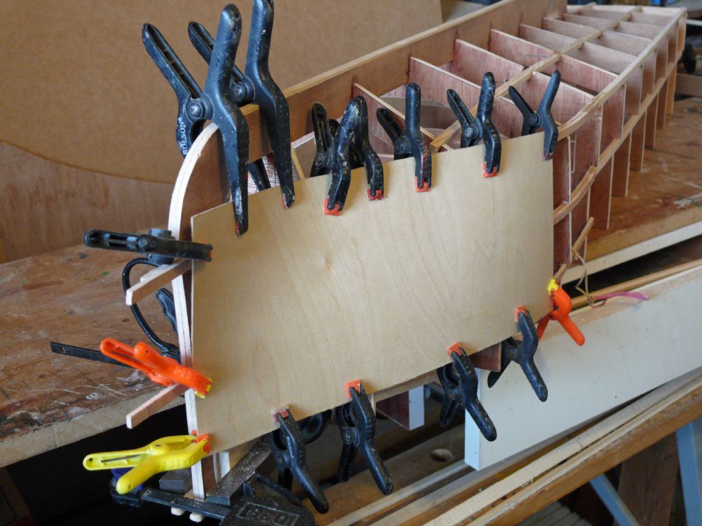

                                        #71558
                                          Not a pretty sight
                                          The forward stringers are shown as Breasthooks on the plan, but I`ve gone for laminated stringers
                                          The ply stringers are quite fragile and one needs to talk in whispers, during bending sequence!…….Shhhhhhh
                                          But once the glue sets, they`ll be as tough as old boots!

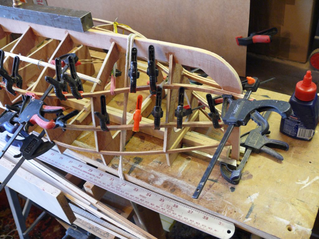

                                          #71562
                                            I can see a tricky area looming in the bows area
                                            The upper stringer is acutely concave……..For Paul's silent running idea
                                            The middle stringer is slightly concave and liveable
                                            The bottom stringer is not fitted yet, but is convex!
                                            Can you imagine a sheet of thin ply coping with that?
                                            I know Lady Joyce worked out ok, but I think I had a magic wand at the time!
                                            Need to try a ply sample and see what's what
                                            Fingers crossed
                                            I think Paul is hiding under the blankets at the moment?
                                            #71565
                                              It`s looking reasonable
                                              The bottom stringer actually collapsed under the load!………Will try a different material for strength, next time

                                                  #71577
                                                    Censored photograph
                                                    Blood Sweat and Tears have been erased
                                                    The stringer planks are strips of 6 x 3 Fairy Dust ply
                                                    #71578
                                                      Now you know why breasthooks were specified, there are a lot of forces acting on the bow and the breasthooks are intended to alleviate the problem by spreading these forces over a larger area.
