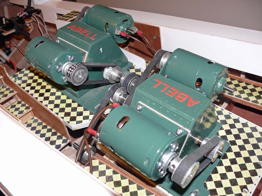

      For the members who are not familiar with the unusual motor drive, here it is…….
      The video says they are 540's but they are actually 4 x MFA Torpedo 850's
      They either run as 2 X 2 or 1 X 4

        I had forgotten how pretty the VGC looked on the water especially when making a bow wave, I appreciate that the 'pinched design' of the bow looks odd but it does produce a very nice swim.
        The Abell Drive certainly works well pushing that mass around and they even overcome the drag caused by the trolley wheels.

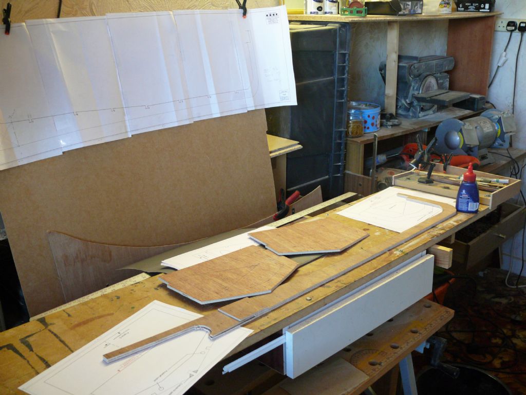

                    It was far too hot to make any sensible progress today
                    Just posting the work in progress for the interested members and I always like to look back at the embryo stage
                    Cut out the two layer keel and a couple of formers
                    Edited By Bob Abell on 17/06/2017 20:03:49

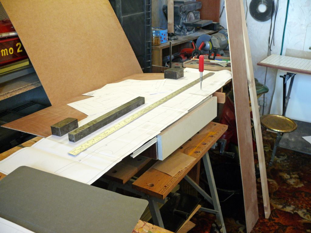

                                This is my method of reproducing the Former shapes onto the plywood
                                Spread the paper drawing over the ply and pop through the salient points with a Bradawl
                                Then join the dots up with a Biro and the job`s a good `en
                                Only got two more formers to cut out, then we can move into the 3rd Dimension!
                                Today`s tip…………..Get yourself a Bandsaw for an easy life……..You won`t regret it

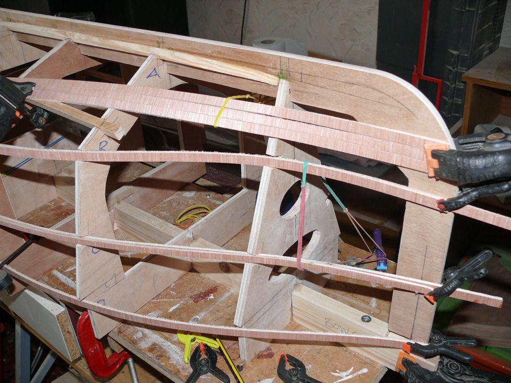

                                    Here we go Boys, bravely into the 3rd Dimension!
                                    A rough assembly of the chassis for first imppression
                                    Seems ok

                                      I'm glad to see you have a new project on the go And not wishing to try and teach you to suck eggs, I'd review the shape of your first bulkhead, you seem to have lost the chine angle, and you would end up with a straight stringer from the second bulkhead to the stem. This is why many designs have a breast hook at chine level to achieve a nice curve on the chine to the stem.
                                      Kind regards Ray

                                        Hi Ray
                                        Take a look at Lady Joyce……….Problem solved!
                                        Paul likes tricky shaped bows

                                          Hi Bob
                                          If you happy, good show, but I've never seen a fullsize hull that shape
                                          What did you think of my Wild Duck ??

                                            Thanks Ray
                                            I know it's a tortuous snout, but that's how Paul has designed it
                                            It's almost the Axe edge shape like Brutus

                                                      Hi Ray
                                                      Paul say`s he designed the bow shape in order to glide through the water with minimum wake
                                                      As was the fashion in the Roaring Twenties
                                                      Looking at the video of Lady Joyce…….He has succeeded
                                                      We are not building a speed boat, but a classic launch with elegance …..par exerlaunce
