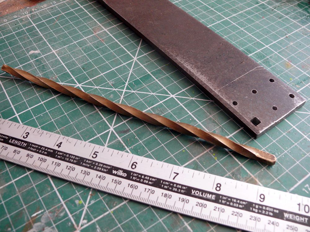

      #60149

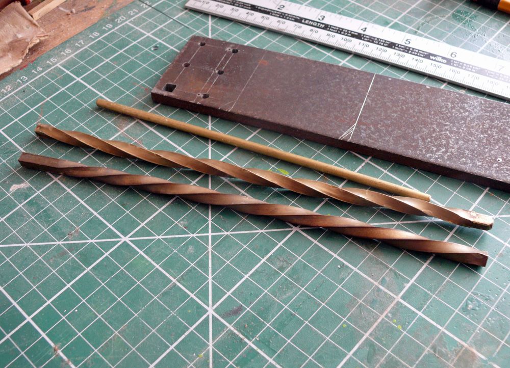

        Ha!…….Surprise, surprise!
        I think I may have cracked it?
        Gripped the end in the vice and wrung it`s neck with the special spanner
        With the brass not being annealed……..There was about 180 deg wind up before it started to bend
        Might give it a few more turns yet
        Dave C…….You may have been correct after all…………Thank you
        Will try your method on the next one
        #60188
          I found this exercise very challenging and interesting………And now wondering, where else could we have such ornamentation?
          #60191
            You know Bob, that looks just like the shank of one of my Archimedes pin vice drills!
            #60192

                #60196
                CookieOld
                  @cookieold
                  Hi Bob , Glad you got sorted with the barley twist , When you said my method might not work i just had to try it with some 3/16 square mild steel and it worked a treat , i even did one at 20 rpm in back gear and that worked.
                  P.S Dont clamp the tailstock to the bed as when the bar twists it gets shorter end needs to drag the tailstock up a bit.
                  Best Regards Daveyes
                  #60198
                    Thank you, Dave
                    I would have gripped the tail end in the tool post…….How did you grip the the bar at the tail end?
                    My lathe would blow the micro fuse at slow speed for some reason?

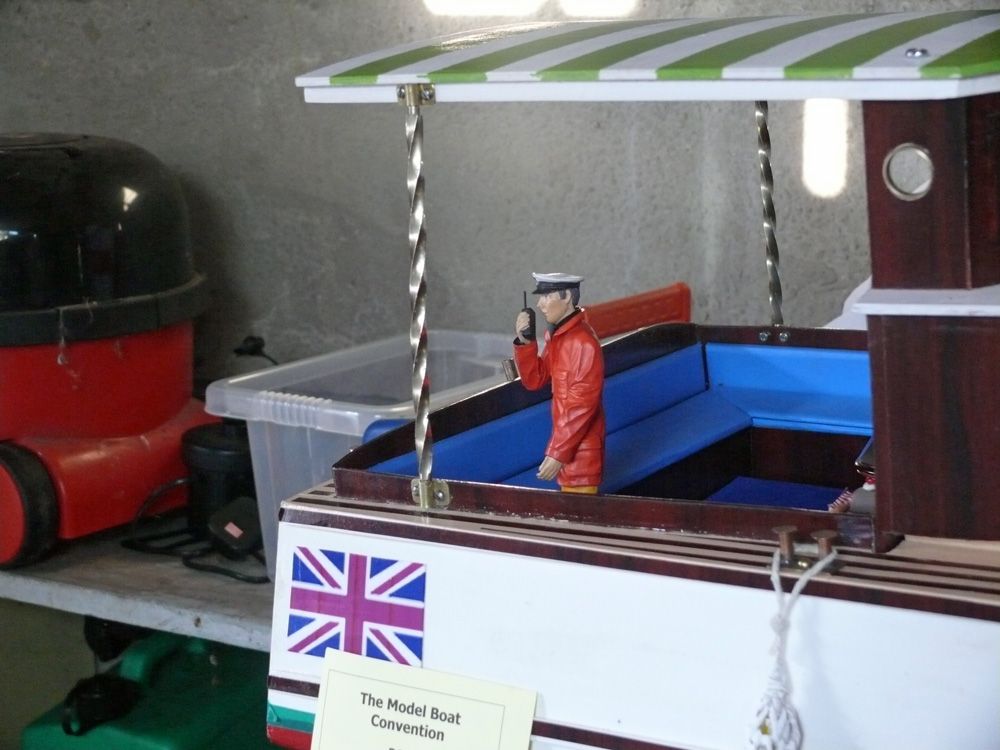

                      Bob. Excellent work. Are you going to polish and varnish them?? They will go dull otherwise.
                      Is the geezer a bit small or is he just perched on there for effect on the `twist?
                      #60205
                        Hello Ashley
                        Thanks for the Barley Twist compliments
                        As for the figure……He measures 5 1/4" tall which makes him a 5'-3" short house
                        I'll make him an Orange Box!

                          Latest picture, showing the port holes and Barley Twists fitted……..Real handsome?
                          There were a few Fly Catchers today!

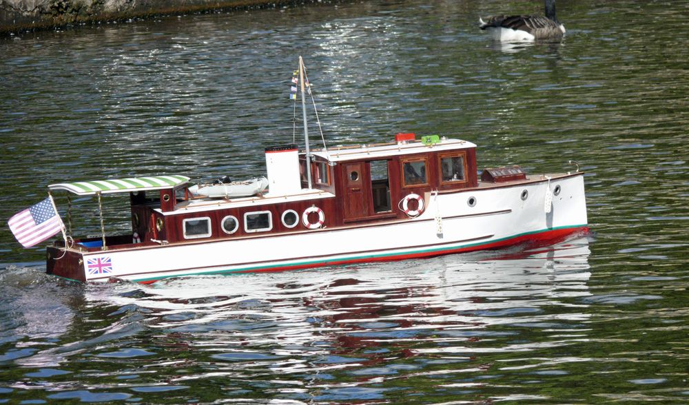

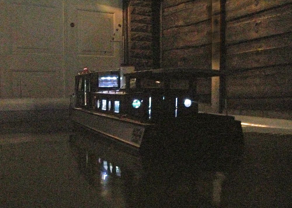

                          #60433

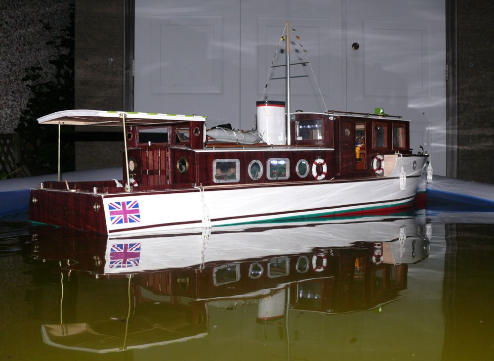

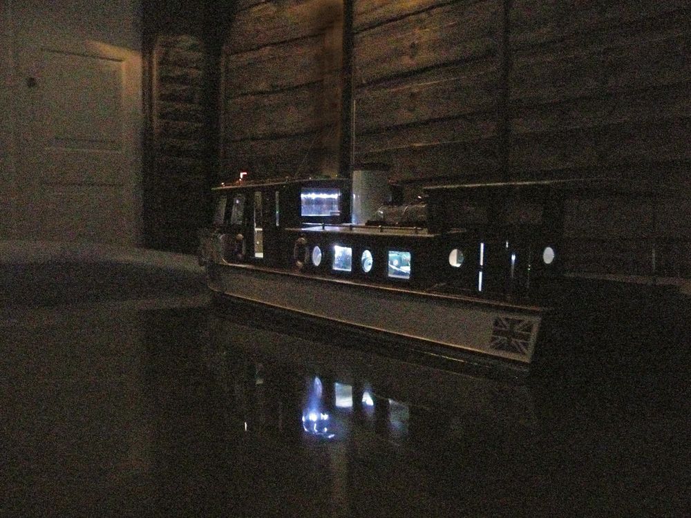

                            Had a visitor tonight to see the boats
                            Demo`d Brutus first…….which behaved very nicely
                            Since we missed the Club`s Venetian Night, last week……….We held another Venetian Night on Coniston Pool!
                            Took a few photo`s too…..
                            #60437
                            Andy C
                              @andyc56856
                              Really nice Bob. Loving the lights. Are the nav lights also working, difficult to tell on the pics.
                              Andy
                              #60438
                                Thanks for looking in, Andy
                                The Nav lights are working……See top picture……….Green light

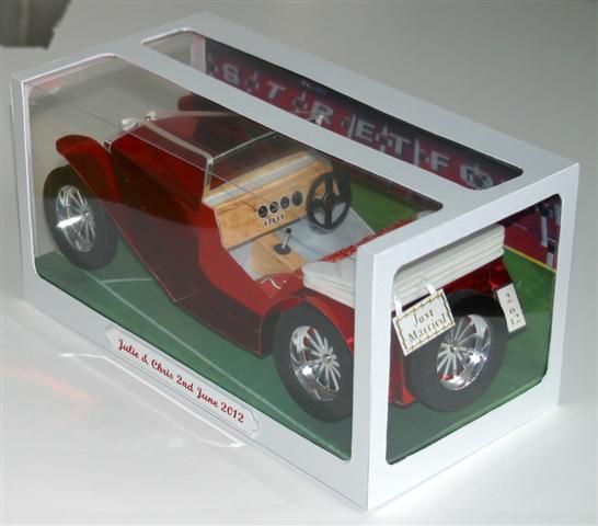

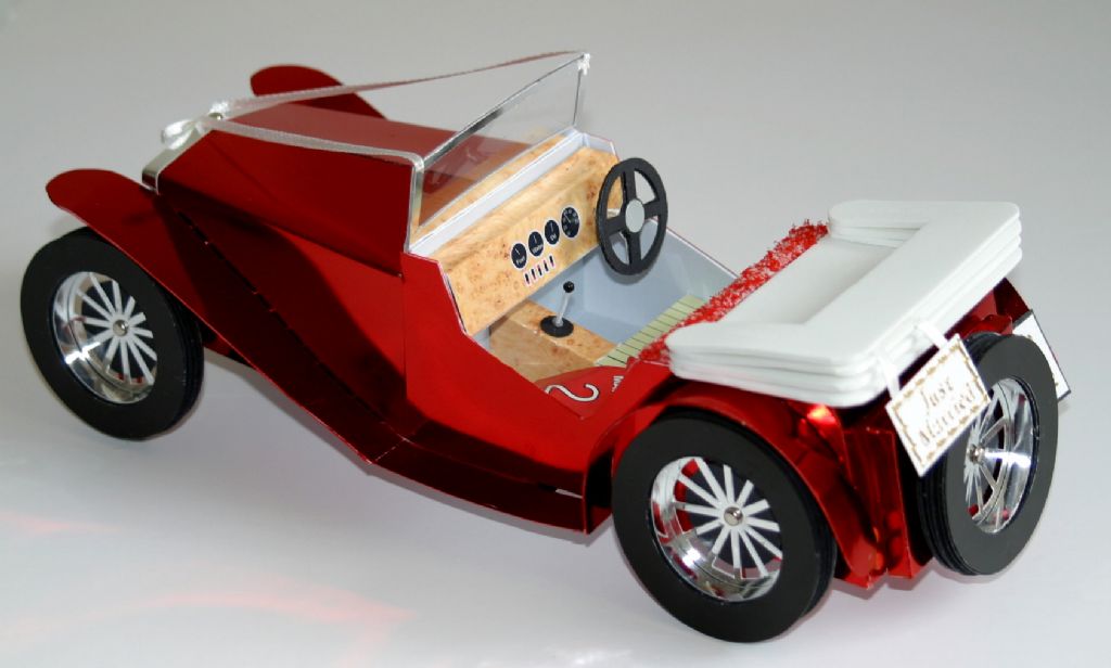

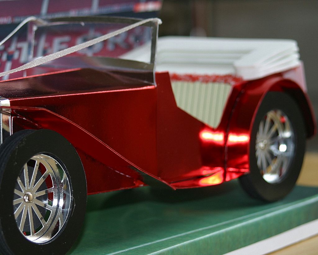

                                                  #61225
                                                    Hello Captain Bob
                                                    Just like you I have lost interest in designing and building another model, Jane puts it down to the overkill of producing so many designs/models in such a short space of time.
                                                    I am back designing card craft items and currently working on a Christmas train, a recent project was a card model MG for a wedding.
                                                    The groom is a Manchester United fan and the wedding was at Old Trafford.
                                                    #61226
                                                      Hello Paul
                                                      Nice to see that you are keeping a watching brief on the Forum…..I'm quite pleased about that!
                                                      I like your model of the card MG and I'm very impressed!
