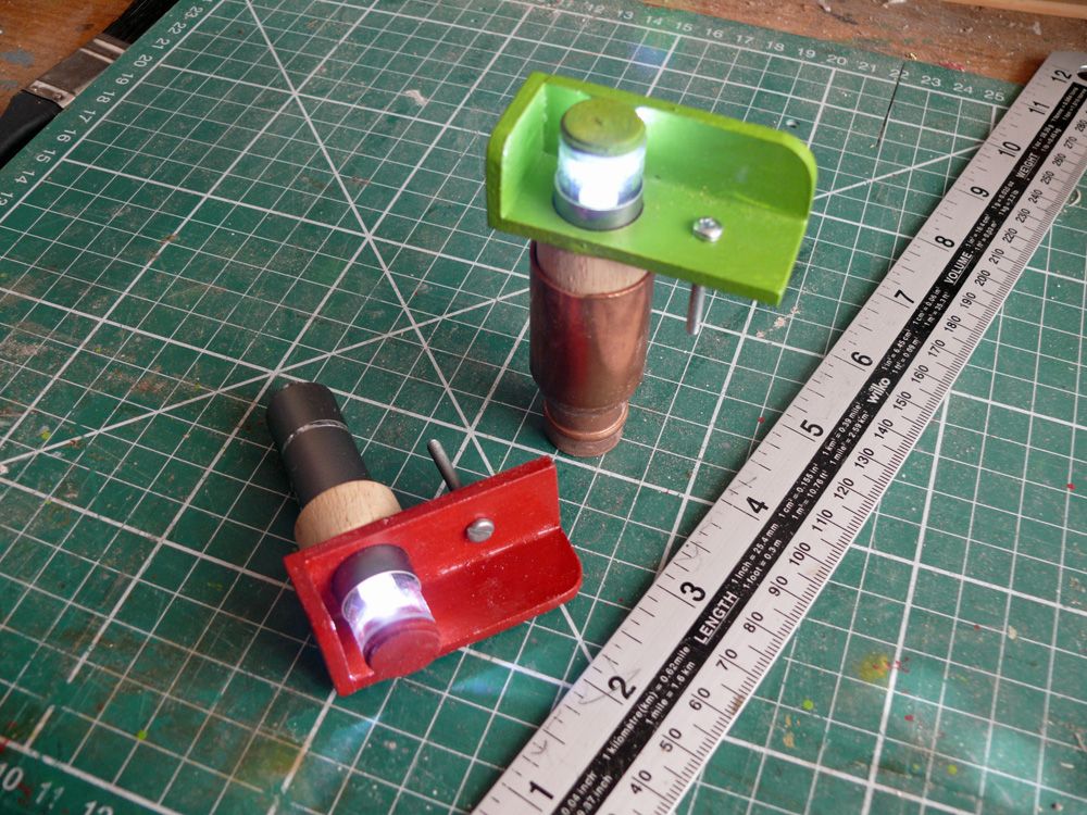

      Sorry hav'nt been on for a while, been a guest of the NHS, tempus a pest.angry As a regard to nav light, l use plastic beads from a local haberdashery stall in the market, l drill a 3mm hole in the base, place 3mm LED and glue in. The facets in the bead make it look like a lantern. 200oms for red, 150 for green, or 430 red 310 green. Hope this helps.

        Have made the two red and green boxes…..Will sort something out tomorrow

                      Found a source of mini torches and used them for the Navigation Lights

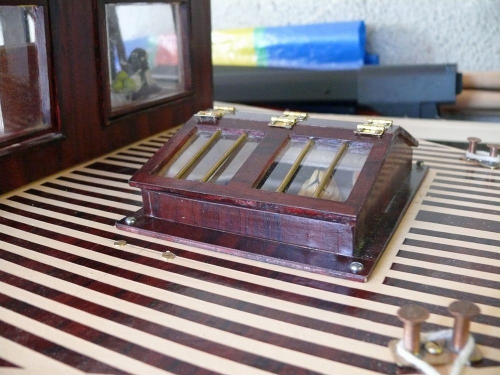

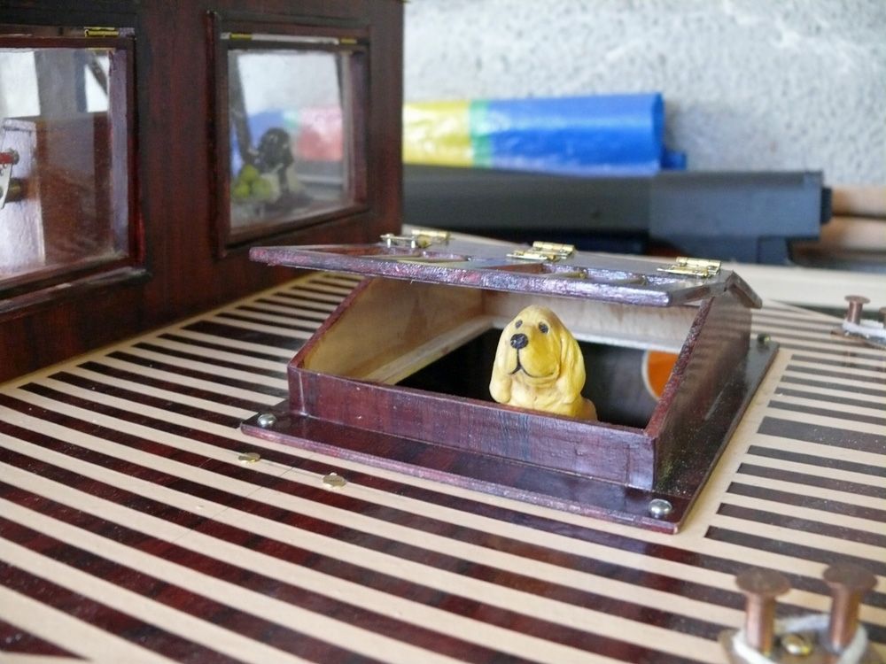

                        The Animated Feature……..For the young at heart?
                        All together now, shout………" ARTHUR"
                        "WOOF"

                          Like the nav lights Bob. Bright thinking young man!
