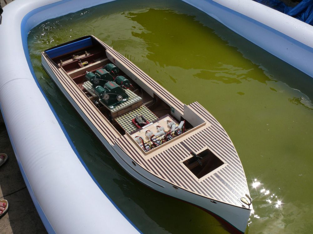

                        Just another test session in Coniston Pool
                        It`s really nice having your own lake, close at hand………Especially in the sunshine
                        With instant sailing display for visitors

                          You didn't need to go to such detail in re-creating Etherow lake, I refer to the water as most of us would just have used a hose pipe.

                            Hello Paul
                            Just amusing myself with the novelty of having the facility
                            Lady Joyce should be most impressive, next time out……Now that all the pulley`s will be in action

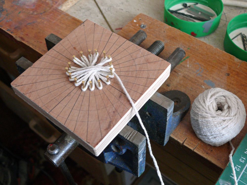

                                                    Just been informed via a PM that a rival mag has just published an article on fender making…..Using the French Knitting principle
                                                    What an amazing coincidence?
                                                    Will have to call at Smiths for a crafty look see!
                                                    #59488
                                                      This is my first attempt at the Fender Weaver, but at the moment, things haven`t worked out too well
                                                      I can see now that the stitches need to be more orderly and accessible somehow
                                                      An interesting project, none the less
