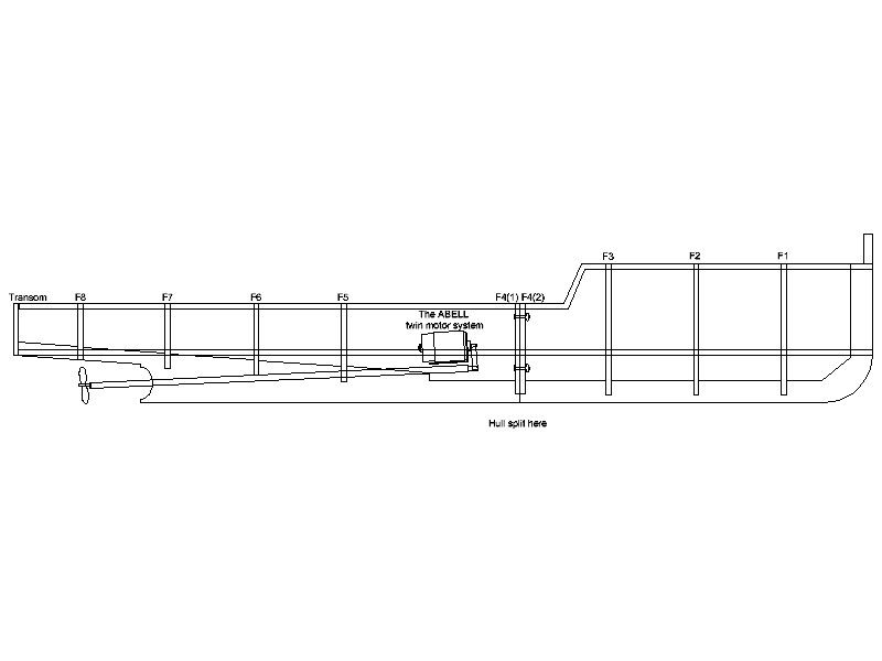

                #49403
                  Will you post a typical cross section, please?

                    #49405
                      Typical longitudinal cross section
                      #49407
                        Thank you, Paul
                        I like the ABELL drive combo………But oh!….Those jagged lines!
                        Propshaft looks a little puny?
                        #49410
                          Chief Designer to workshop chappie.
                          I like the ABELL drive and I'm looking forward to seeing it in action.
                          Jagged lines….how many of those sherbets have you had today? and yet my lines are squiggly and I haven't had a drink in ten years.wink
                          Puny?? its a 12mm tube with a 10mm shaft all in 316 grade stainless steel with custom neoprene seals and mid length bearings. It will take a real engineer to build it….do you know one?

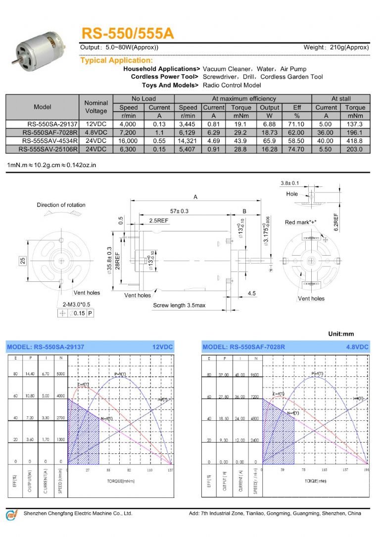

                              I suppose the latest pair of MFA700 may be a suitable combo, but they are a bit expensive
                              Have you noticed the strange timing adjustment?
                              We'll se how they perform
                              #49462
                                Bob. I was given a special little 500 sized motor in a dinky fitted wooden box, and this has adjustable timing. I probably need 60A amp wires for it but ..
                                I wonder why you didnt just buy the normal 600 sort instead of these things?? they are quite expensive and my guess is they are right hot items….?
                                #49463
                                  Hello Ashley
                                  We can blame the Chief Designer for this extravagaze!
                                  We were having plain old 600's, but he said….."Why not splash out and get MFA700's?"
                                  Got a feeling he didn't know what they were!
                                  Anyway, we may have got the ideal motors, in this case due to the limited space left by the Brushless rubbish!
                                  No problem, Paul……We like surprises!

                                                #49486
                                                  Subcontract drawing office to Head Office
                                                  Can`t locate exact dimensions with mounting bracket for 550 motor
                                                  But have got a 555 motor and bracket in Ellie, which I could use?
                                                  They only cost £11.00 the lot
                                                  Shall we use a pair of 555 then?
                                                  #49487
                                                    Chief designer to drawing office apprentice.
                                                    On the face of it there is no difference in the mounting brackets between the 550 and 555 motors
                                                    So I don't see any problems in using the 555 and shall include it as an option in the specifications
                                                    Edited By Paul T on 06/06/2014 19:28:36
                                                    #49489
                                                      That`s excellent, Paul…………OK Boss
                                                      Can`t find dims for "A" and "B"…?
                                                      Doesn`t matter……I`ll measure mine
