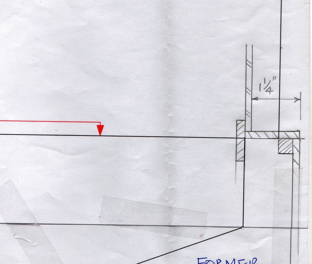

                                OK!…….Here is the proof, my little Coffee Bean
                                Looking at Former 4
                                With the coaming on the inside of the hull opening and the cabin wall, up against it and with 3mm hull wall thickness
                                The remaining dimension for the walkway is……….1.25"………That`s 15" in real life!
                                With a handrail, this leaves about 13"……….You won`t get thru that Mr Fat Controller!
                                On second thoughts……..I`ll have a shot of woskie in mine old Bean!………….Jim Bean, to be exact!…..lol
                                Now folks………Just read how he gets out of this one?
                                Innocent Bob

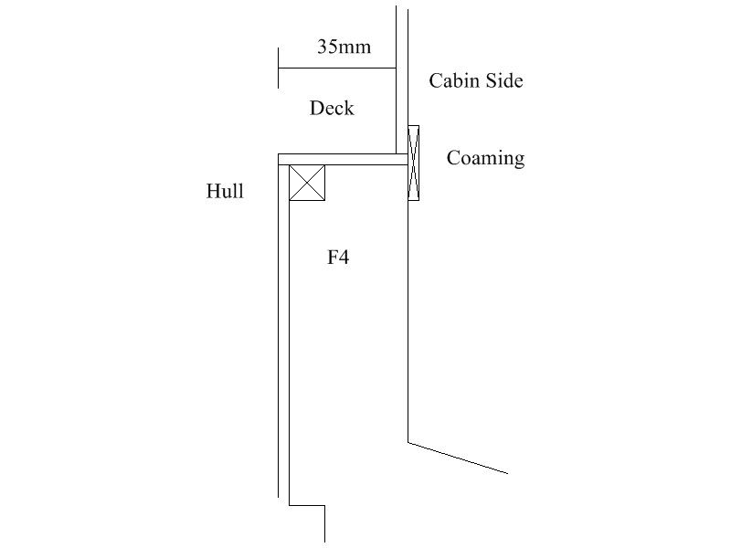

                                      Hello Capt.
                                      The designers response
                                      As you can see this is a detail taken from a cross section at F4.
                                      Both the section and plan drawings show the same information.
                                      Perplexed of Lymm

                                        Hello Perplexed of Lymm
                                        My drawing shows 35 mm from the coaming to outside of hull
                                        But your figure of 35mm is still on the narrow side……Which is 16.5"
                                        Is the designer happy with this figure?
                                        I`m not saying the drawing is wrong…….Just a bit narrow to get the railings in?
                                        Edit………..Like I said earlier………Fit the handrail stanchions on the outside of the hull?
                                        Bob again

                                          #58524
                                            Hello Captain Bob
                                            I am still confused as I cant see any dimensional problems or construction errors either with the drawings or with your boat
                                            The one significant exception to the original drawings is that my design didn't have any handrails and so movement along the narrow side deck wouldn't be a problem.
                                            I think this means that I win the wager and look forward to drinking my double espresso at Haydock.

                                                    Hi Bob
                                                    Going back through the progress photos everything seemed to be in order and the cabin looked to be sat at the correct distance from the hull sides.
                                                    The dimension check that you did today confirmed that your build is fundamentally the same as my drawings, and I have to say that I didn't expect anything else from one of your builds.
                                                    Just to clarify the situation are you happy that everything is now ok or do you still think that there is an error in the drawings.
