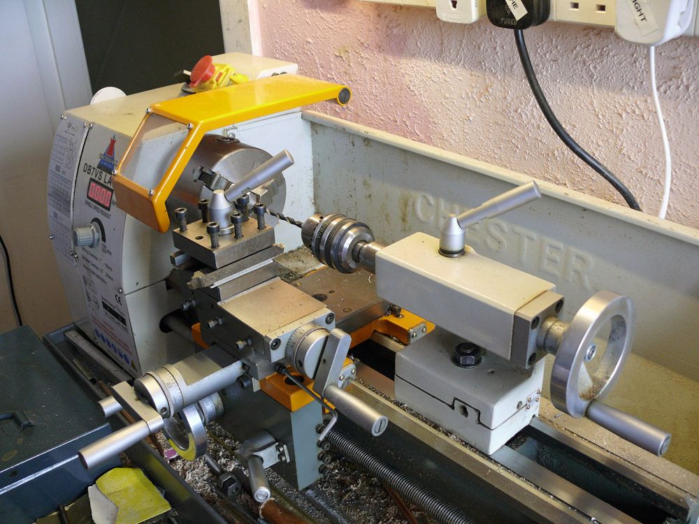

                    #58251
                      Ralph or anybody with a Chester lathe
                      I am turning the lifebelts on the lathe
                      I need to fit the outside gripping jaws………I have done this a few times in the past but the jaws are not marked 1…2…3 and causes hours of utter time wasting……By trial and error
                      The jaws are supposed to be stamped on the inside the guide slot, but mine only show part numbers
                      Any advice on this please?
                      #58259
                      Keith Long
                        @keithlong89920
                        Bob look at the back of the chuck jaws where the teeth that engage the chuck scroll will be visible. Jaw 1 will have the inside tooth nearest the contact face of the jaw, no 2 will be a bit higher and no 3 will be the highest of all.
                        I find the easiset way to get the teeth into the chuck is to look into a jaw slot, and turn the scroll until you just see the outermost part of the scroll thread come into view. Turn the scroll back slightly so that the jaw that you've identified above as "1" enters and then engage it with the scroll. Move on to the next slot clockwise looking at the front of the chuck and do the same as before but insert jaw 2. Then move on to the final slot and insert jaw 3. Then try tightening the chuck up and see if the jaws meet centrally. If not adjust as required, you should have the jaws in the right order but may have either missed the pick up on the scroll or picked up too soon. If the chuck feels tight opening or closing it's probably that the jaws are not in the originally designated slots, in which case, you need to move all the jaws round by one or two slots keeping them in the correct order. Some centre punch marks on non critical part of the chuck body and jaws identifies the slot and jaw will save a lot of time in the future.
                        Edited By Keith Long on 08/06/2015 18:32:15
                        #58262
                          Thank you Keith
                          I will try that……Thanks a lot for your quick responce
                          #58265
                            Hello Keith
                            I`m almost ashamed of myself!
                            I tried doing it your way……Then my way…….Then any way!……..It just wouldn`t finish up in the correct manner
                            It could be a multi start scroll of something daft?
                            Got round the problem though!
                            I measured the scroll pitch……Which was 6mm……..Divided by three gave me the packing thickness of 2mm per jaw!
                            So I packed out the jaws!
                            Good enough for four wooden life belts?
                            A tip worth remembering?
                            An Engineers solution to a total mystery!
                            #58266
                              About turn on the packing idea, Keith
                              I tried setting the jaws again and it worked out OK
                              Many thanks
                              #58267
                              Keith Long
                                @keithlong89920
                                Pleased it worked out for you. It can be tricky.
                                Keith.
                                #58274
                                  Hello Keith and others
                                  The confusion continues!
                                  It seems the handbook is incorrect, regarding jaw numbers
                                  The solution is to follow Keith`s advice and just study the serrations and start of chuck spiral and load the jaws in succession
                                  #58275
                                  Ralph Pinch
                                    @ralphpinch41762
                                    Hi Bob, sorry have not been on for a couple of days, my jaws have not been out yet so I don't know if they are correctly marked, normaly on the shop lathe I do as Keith, but that can be hit or miss as well, glad to see you have got them fitted correctly.
                                    Ralph.

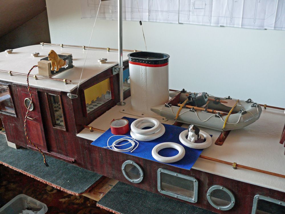

                                        #58318
                                          Work in progress
                                          Making the lifebelts is a slow business……..Due to the time it takes for the paint to dry!
                                          #58321
                                          Ralph Pinch
                                            @ralphpinch41762
                                            Looks good, when I made the same for Sprite I masked off for the red quarters, its a waste of time, any bleed and it stands out like a sore thumb, your better off freehand.
                                            when I finished turning them I showed them to the wife, "their nice love but why did you not use wooden curtain rail hoops" I checked some that we had and they were near identical size………talk about thinking out of the box!
