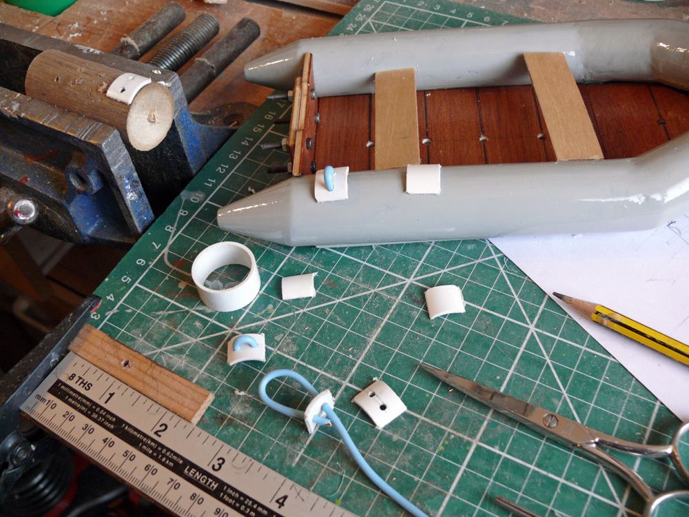

                            I gave the rope loop patches a lot of thought over the last few days and finally came up with this simple idea…
                            Plastic tube cut into rings……Then cut into arcs……Then marked out and drilled
                            For the loop I`ve used wire flex……Pushed through and snipped off
                            Will be painted black and glued on
                            Dinky idea, eh?
                            #57952
                            Andy C
                              @andyc56856
                              Very innovative Bob. I like it!

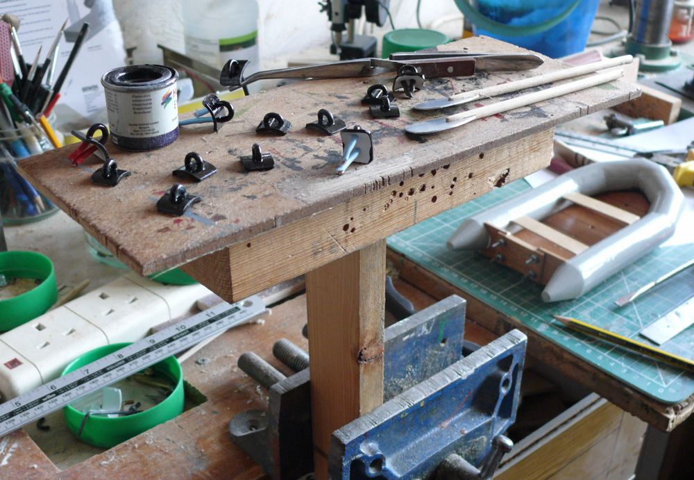

                                      Here`s a handy tip for when working on fine detail
                                      The famous………"High level work table"
                                      Just a board on an upright, clamped in the vice, that raises the work table area to eye level
                                      I wouldn`t be without it

                                        Bob. Great colour on the dingy now wink
                                        A true workmans vice….loads of saw and file cuts on top!!

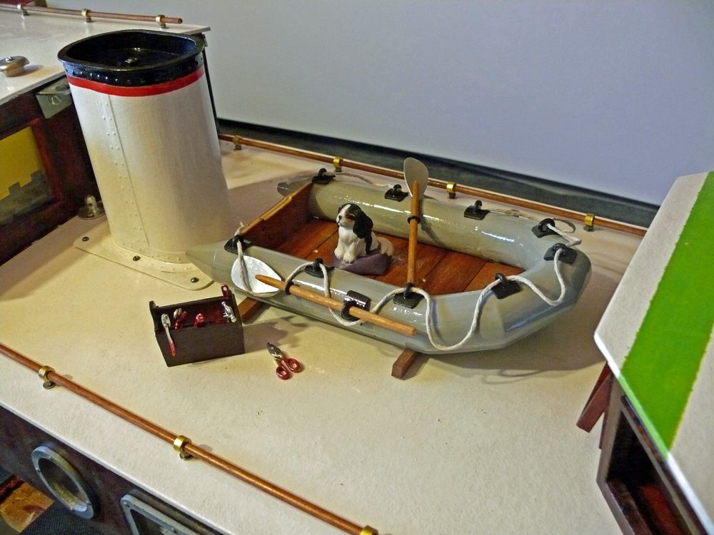

                                              Still not finished yet, but there are a few Kevins out there, who like to be kept up to date
                                              Can`t blame them really…….This thread is nearly as good as a daily soap prog
                                              Only joking

                                              Ralph Pinch
                                                @ralphpinch41762
                                                Just seen a close up of your hand rails Bob, very nicely machined and the 12th scale bits and bobs like the tool box! like it.
                                                Yes this build is very time consuming but enjoyable at that.

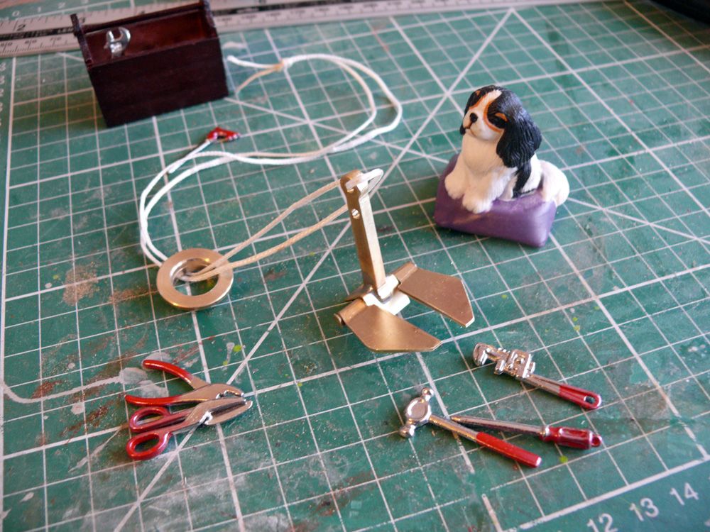

                                                    Wow, Bob, now THAT is a nice ship's boat! It really looks the part now, and the crate and scissors are a nice touch as well. Although I wouldn't leave that scissors on deck when sailing, before you know it it'll puncture your rubber boat wink

                                                      Just made the Anchor today………….Another little job, ticked off the list
