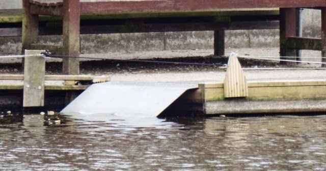

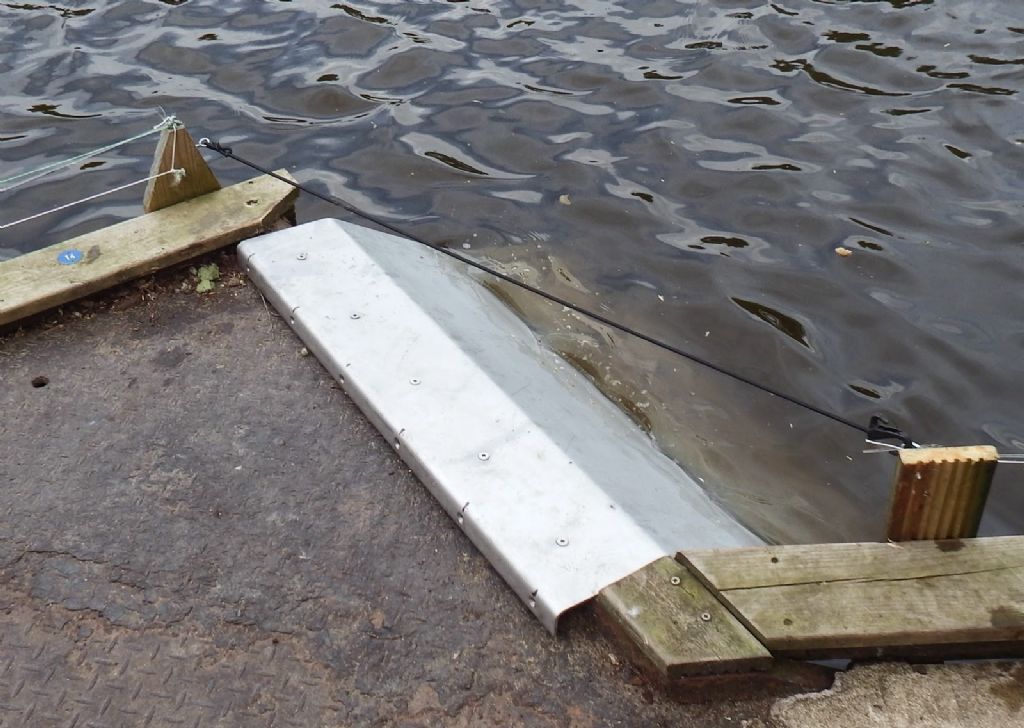

                      How thoughtful of the Club Committee to install a special launching ramp
                      I'm sure they've built it with Lady Joyce in mind?
                      Thanks to Mike the Fixer

                        That looks good Bob should make launching Lady Joyce a piece of cake, is that a black bungy rope I see ready to fire her into the middle of the lake!!

                          The cords around the landing stage deter the Geese from soiling the area………It works well too
                          Another good idea from our Mike the Fixer

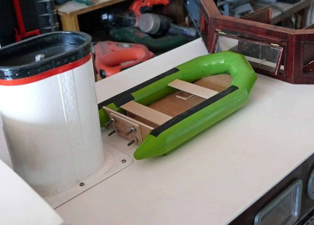

                              So this will have to do for the time being…..The Dinghy project, still in progress at the moment

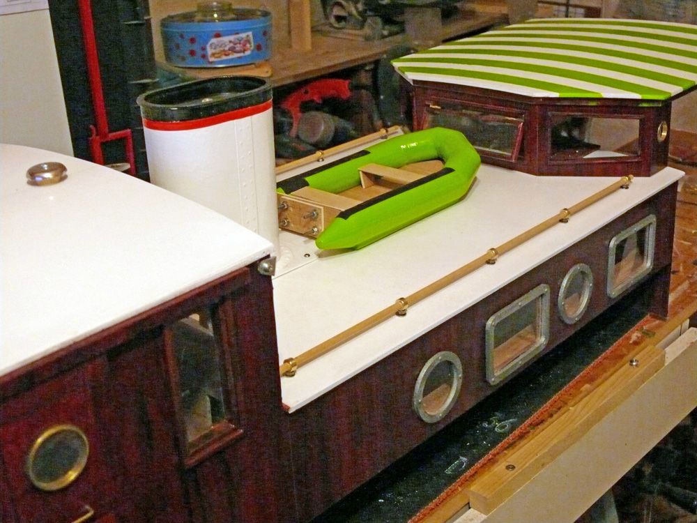

                                Just added the cabin grab rails
                                #57870
                                Diede van Abs
                                  @diedevanabs87670
                                  Hi Bob,
                                  Nice little boat you have there on the roof, although green would not be my personal choice of tube material. Grey or orange would be more realistic I think. But hey…
                                  What I do miss though, is either a pair of oars or an outboard motor fitted. Also a grab rope along the tube or handles would be handy. And please do cut off these bolt ends! It hurts like hell when you try to board a boat over the stern wich such steel bars protruding…
                                  Your handrails look lovely! That's definately an advantage to building large-scale; you can actually make the handrails and other items like the real deal.

                                    What are you on about?…….I've already said, the dinghy is still on the production line
                                    Why don't you rissen?…..lol
                                    I really wanted a yellow dinghy, but didn't have any yellow paint!
                                    The oars are in the pipeline and even a mo'or

                                        Will be fitting a pair of grab rails to the other cabin roof now
                                        The narrow walkway has been legging me up for months……That's why the main hand rails have not been fitted
                                        But with the grab rails, they now make some sense

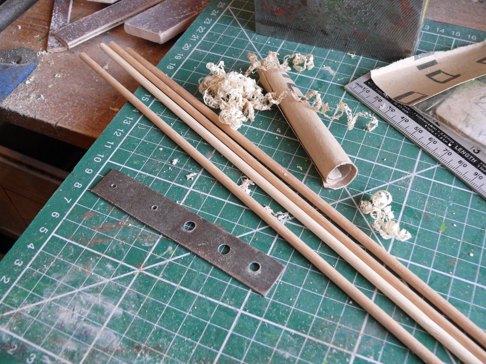

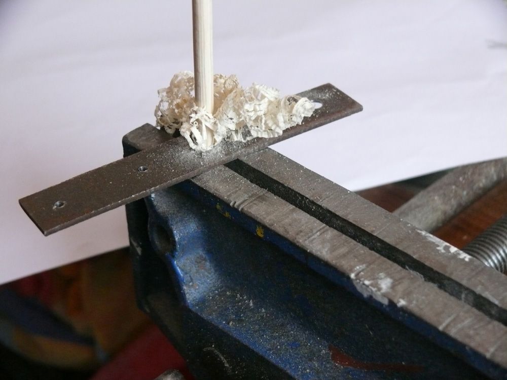

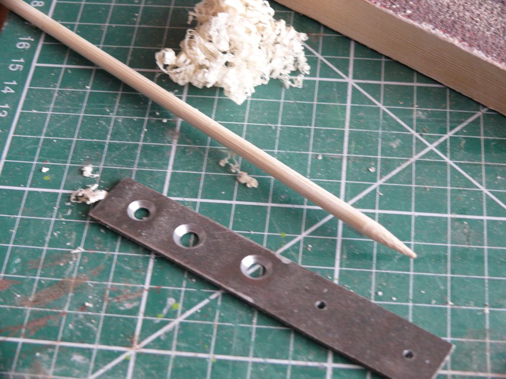

                                            I was short of just one 5mm dowel for the cabin roof………Drat!…..Only had 6mm in stock
                                            I had previously noticed that as I pushed the grab rail through the eye bolts, a tiny slither of wood was shaved off
                                            This gave me an idea!………So I drilled a few holes of various sizes through a piece of 1.5mm sheet metal…..6mm…..5.5mm…….5mm and countersunk the holes on one side…..and got a very sharp cutting edge
                                            Starting with the 6mm , I tapped it through the hole and a nice shaving was skimmed off…..All the way down!
                                            Which was quite interesting and pleasing……..I also noticed that pushing the dowel through again…….More wood was shaved off
                                            Repeated the process using the other smaller holes and ended up with a perfectly round 5mm dowel
                                            I put the other grab rails through and they were all standardised to 5mm………Nice!

                                              The drawplate method of producing dowel is incidentally the one used and reommended by the late, great Harold A. Underhill in his seminal "Plank on Frame Models and Scale Masting & Rigging" (**LINK**) …

                                                That is a good way of creating dowel indeed. I'll remember that one!

                                                  Bob. Let you get away with the green on the other boat, but the dingy is just too much. Stripes I can live with, but..
                                                  Ashley (disclaimer..personal opinion only)
                                                  #57896
                                                    Thanks Banjo And Diede?……BTW……Do you two know each other?
                                                    You are not the first to pooh poo the green dinghy
                                                    I'll bow to public opinion and paint it orange…….When I can get some paint
                                                    Not many shops sell those little Humbrol tin lets these days
                                                    May have to go Mail order!
                                                    #57897
                                                      Hello Captain Bob
                                                      You could paint it grey then it wouldn't detract from the main boat
