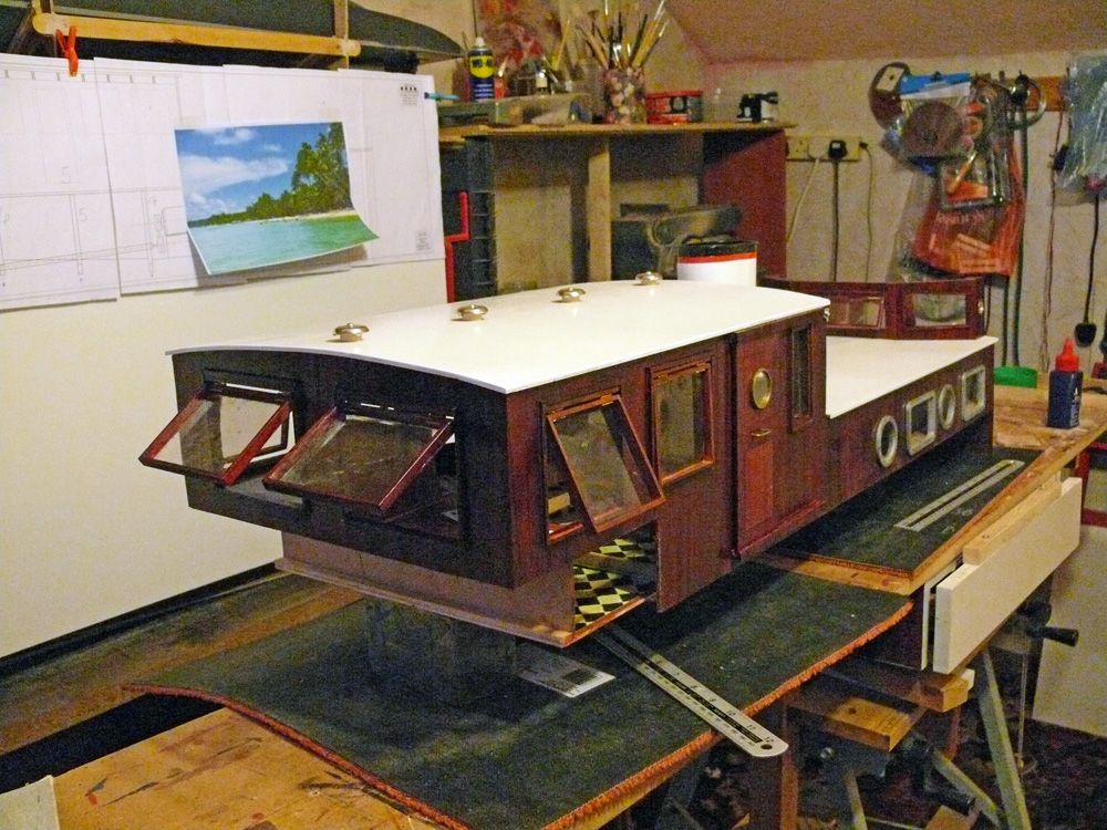

                        Work in progress
                        Finally finished the windows!………They are all open, as I need to keep moving them to prevent the varnish setting in the hinges!
                        Next relaxation job is to make a pretty rubber dinghy for the cabin roof

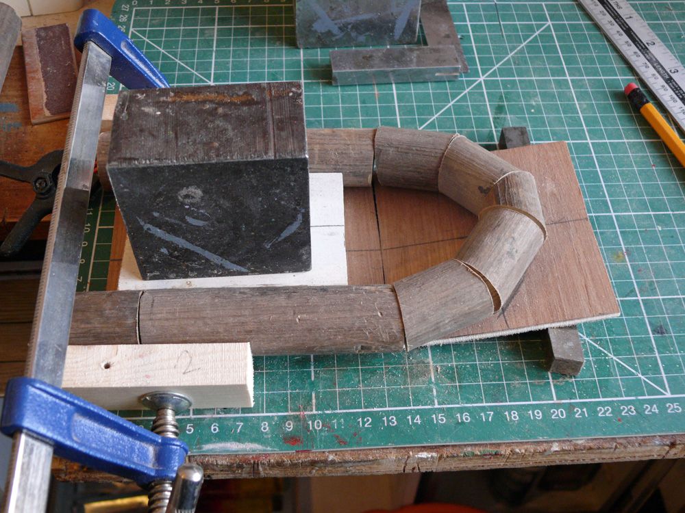

                          Work in progress………The makings of the rubber dinghy
                          Got to admit, it`s not a pretty sight, but a novel approach?
                          All the segments are threaded onto a length of flex and are now nicely under control!
                          Now for the P51 to the rescue

                                      The dinghy construction had a few large gaps to fill
                                      P38 and P51 are both fillers……That's all

                                              The filler with chopped strand bits in it (the suppliers call it a "bridger" paste) is Isopon P40 – just in case anyone wishes to buy some. It's excellent for fitting prop tubes, rudder tubes, motor mounts and bow-thrusters to GRP hulls. P38 is a smooth filler-paste which would be more the one to use on your inflatable dinghy.
