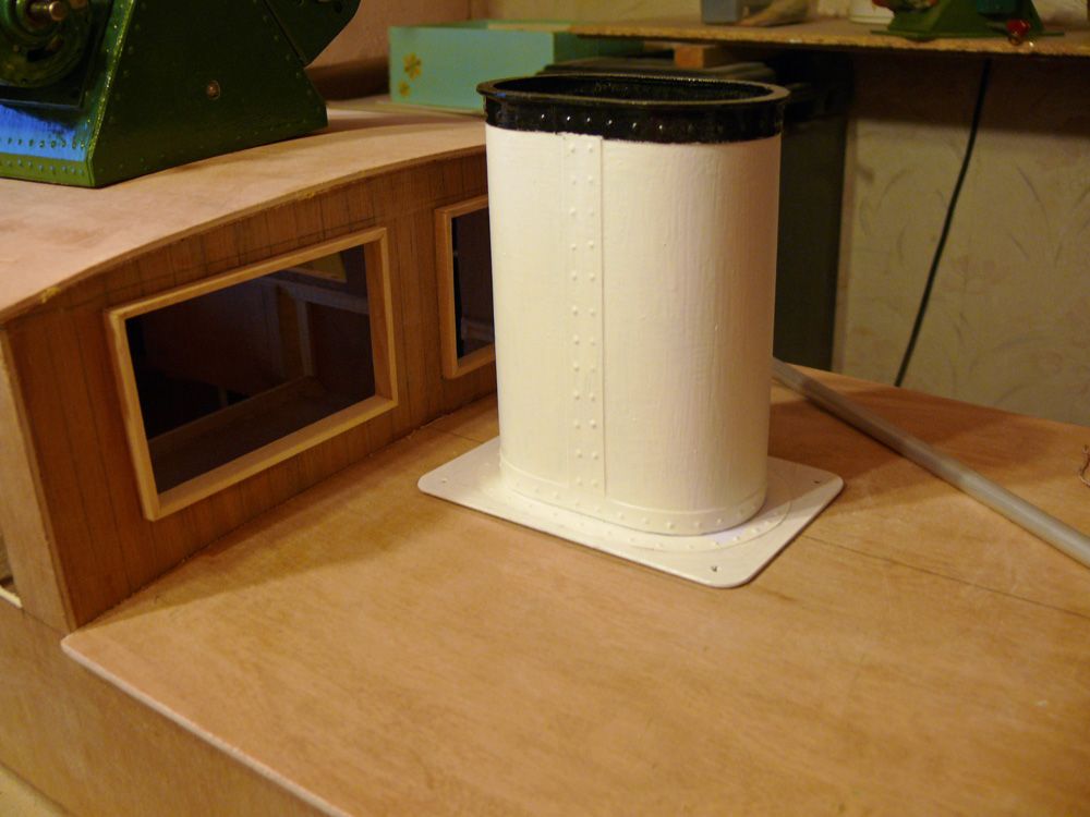

        Just a few pictures to keep Paul up to date………Unfortunately, Paul is not so well at the moment
        We hope you will feel better very soon, Paul……….Your presence and comments are sorely missed

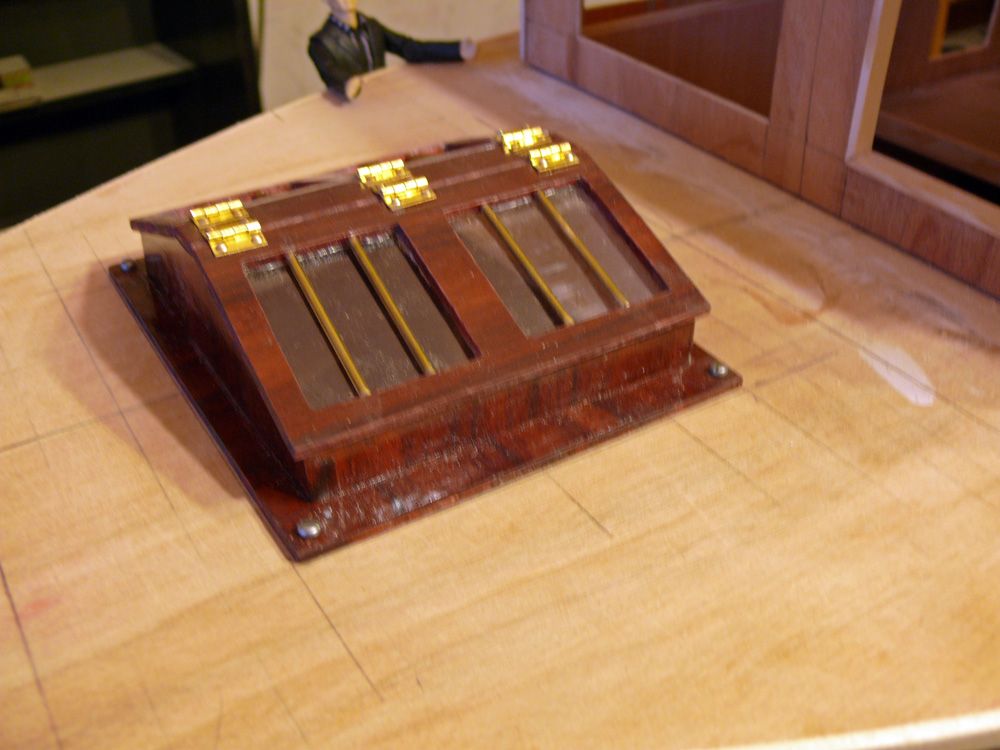

        First picture shows the finished skylight

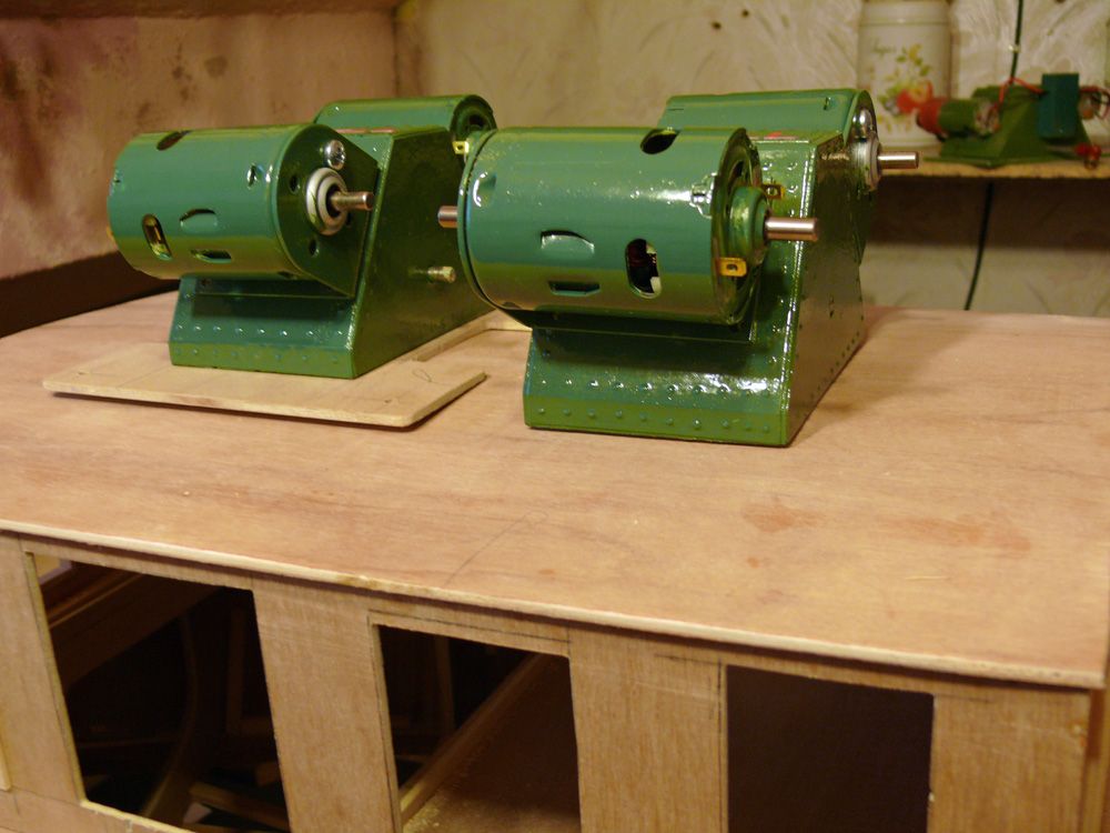

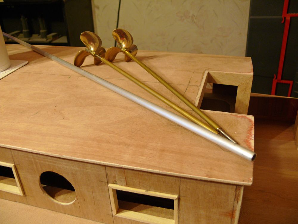

        Third picture shows the short propshafts with aluminium extension tube to make up the length……Novel eh?

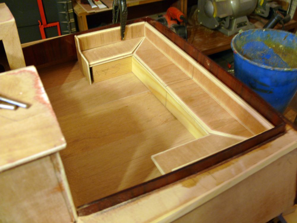

        Next comes the rear seating construction

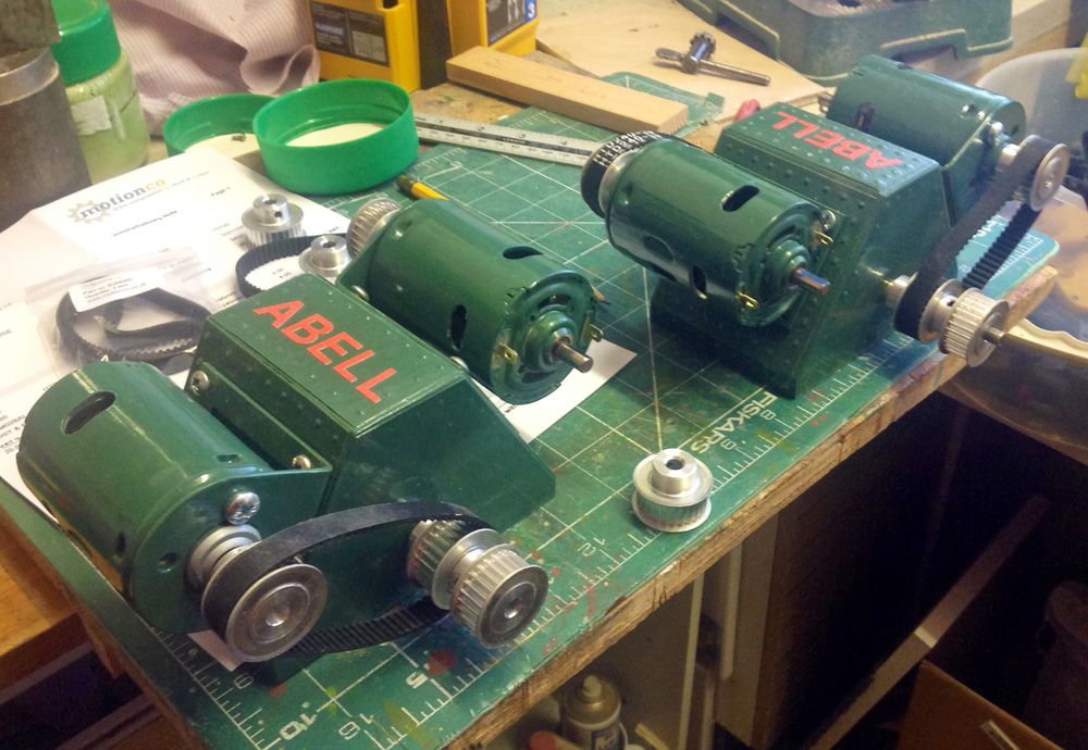

        Finally the motor drives awaiting the timing belt drives……….The pulleys and belts are costing the handsome sum of £135.00…..which is an early Christmas present

                  How do your aluminium extension tubes work? I have been trying to make sense out of your description and photo and just cant figure out how you are doing it.

                    I have two M4 prop tubes about 12" long, which are too short for the job
                    I`m hoping to extend the shaft only to the length required, by using a length of 8mm aluminium tube with suitabell end fittings that fit the propshaft….A simple 4mm bore at the propshaft end and a 6mm stub shaft for the timing belt end……Complete with a brass bearing assembly……..Should look nice and also, unusual
                    So, looking at the motor drive we will see a rotating ali tube for most of the drive, disappearing into the rear section somewhere
                    All will be revealed shortly

                        The ally tube sounds like a good idea but it might need supporting mid way to prevent whipping.

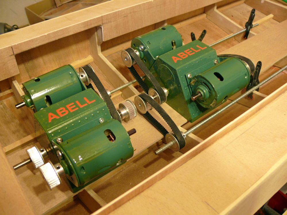

                          The Timing drives have finally arrived!……….Christmas has come early
                          Fit for purpose too!
                          The motors will have packers beneath the bases to adjust the belt tension
                          Fan blades will be mounted on the motor shafts
                          All great fun…….Bob

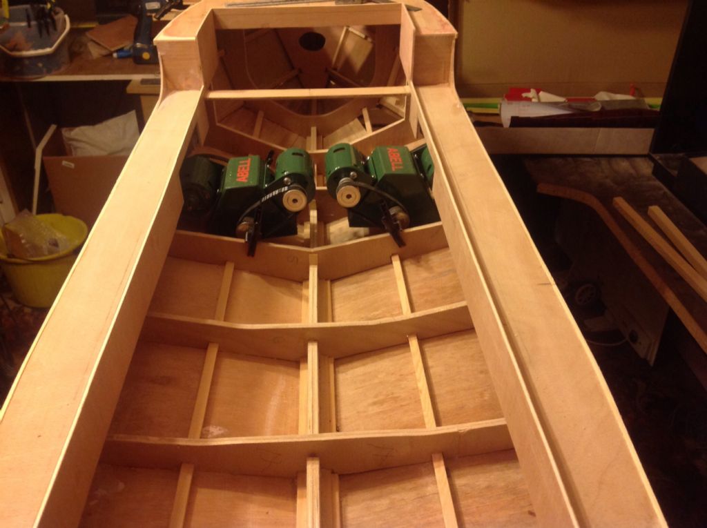

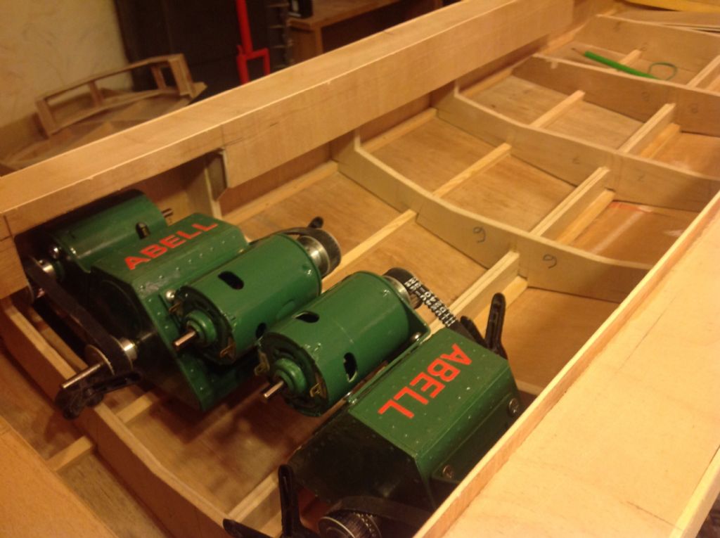

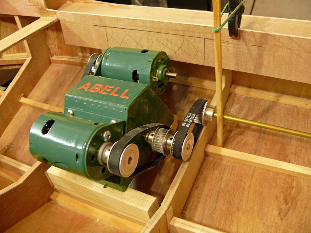

                                        The moment of truth………..Bit of a tight squeeze………I thought we had plenty of room!
                                        The coaming needs to be cut away at the moment, then we`ll get a better idea of the space required

                                          #53904
                                            Thanks Paul
                                            I do remember your layout, but I didn`t like the housing shape
                                            I`ve cut the coaming away and it looks ok now………Don`t think I can get the propshaft belt drive in though

                                            What was the designed propshaft pitch again, please?
                                            #53907
                                              The propshaft angle is 2.60deg.

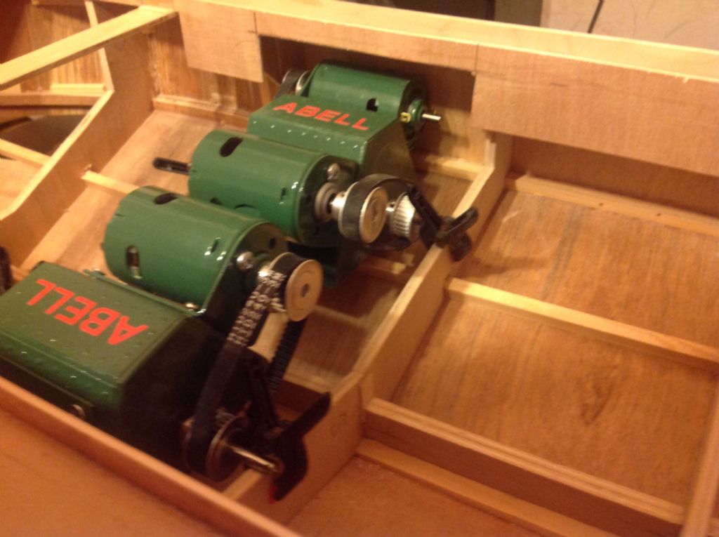

                                                image.jpgYou Cheeky snotty nosed kid!……..Don't be too hasty in mocking your superiors!
                                                Such is the fun obtained form this build, I have temporarily abandoned the moronic footie nonsense, gone upstairs and assaulted the coamings and placed the tackle in position!
                                                Here's the proof!…….

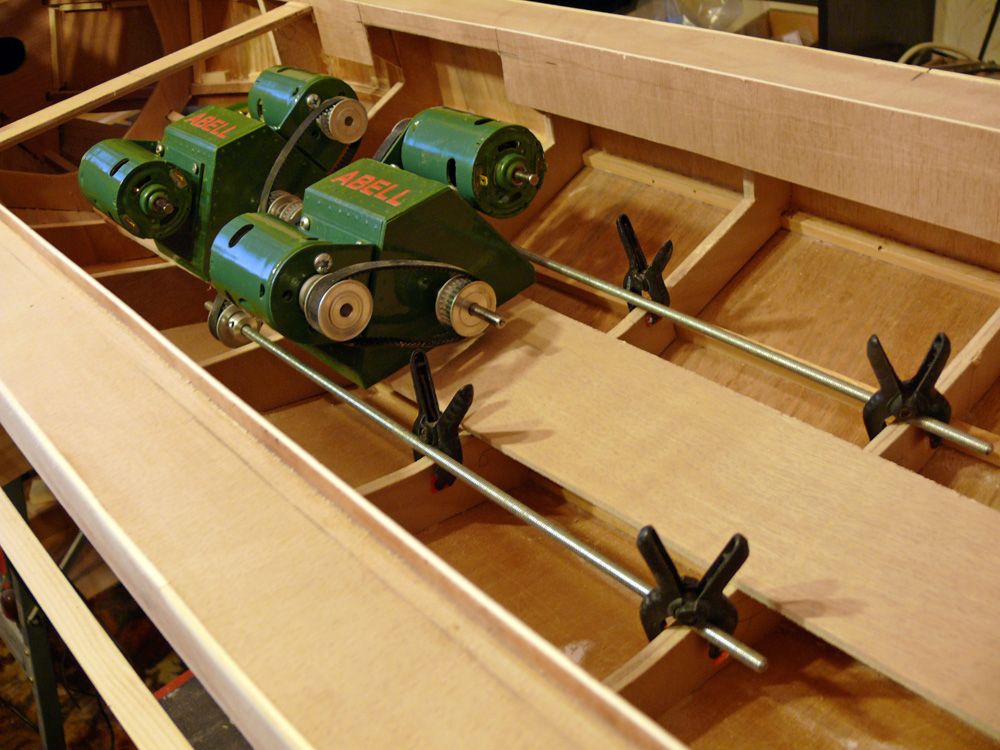

                                                      Did some lateral thinking this morning and came up with the ideal layout!
                                                      Plenty of access space and nicely positioned?
                                                      Just need a pair of longer belts now
                                                      Paul, what was the propshaft pitch again please?
