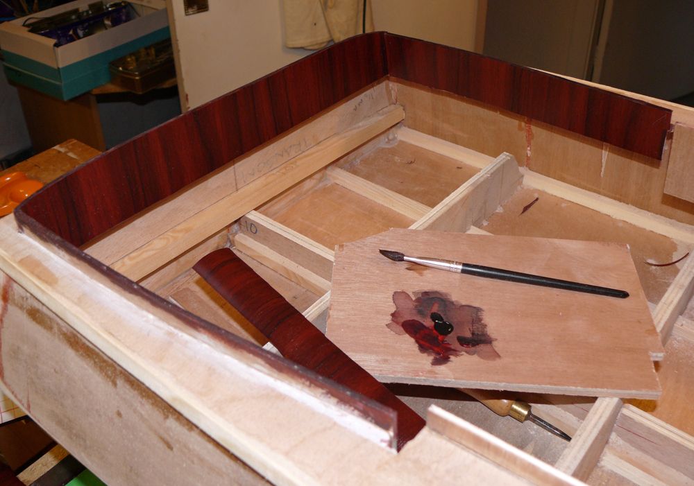

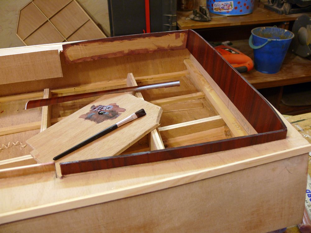

        I am highly delighted with the Fablon solution to the cabin structure……The varnish has taken well and has done a very pleasing job in making the covering material easy to work and makes the covering acceptabelly durabell
        We like to experiment with new ideas, it makes the build all that more interesting!
        Before the Fablon is applied, all tricky areas and edges need to be painted with a good colour match of acryics
        The edges can be firmly secured using a plastic ruler
        Followed by a few coats of varnish
        I am now thinking about covering the deck with a suitabell pattern…….Even light brown with ink planking
        The hull will have a traditional filler and multicoat paint finish
        Any comments, you chaps out there,, concerning this new finish?
        Bob and Paul

          Hi Bob
          Have used Fablon, its superb but, can't make out in the pictures weather you have turned the edges over. This is a problem if the Fablon gets warm like in the sun in the car, it shrinks and becomes soft.
          Try not to stretch the film as this makes it even worse.
          Talking of gold lettering, why not cover with clear film, no mixing of materials and makes a very nice finish. Used this on my Huntsman for name boards and transom.
          Used Letraset on the Fablon with book cover over, very good finish,
          Hope this helps
          Mark
          Edited By Mark Jarvis 2 on 13/11/2014 09:46:20

            Many thanks, Mark
            It's comforting to know that it's been done before!
            The raw edges are a source of trouble, but I'm hoping the varnish will cure the problem?
            I'll put the test piece in the sun and see what happens

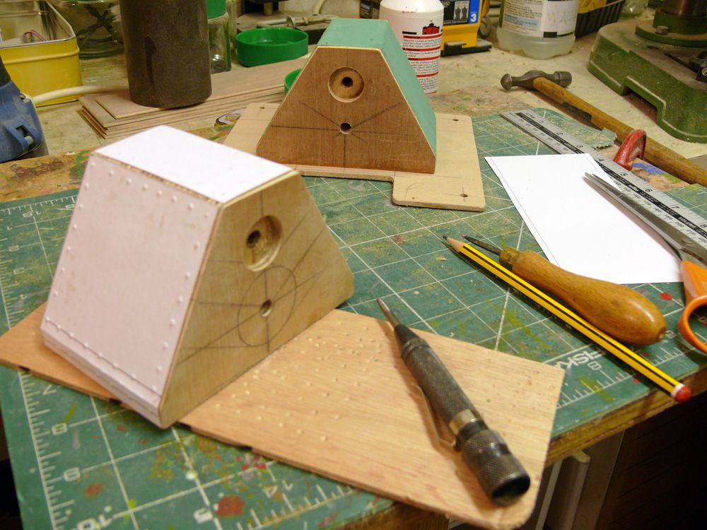

                Back on the motor drives again……..The base is a bit oversize at the moment, as we don`t quite know how they will fit the hull
                The pitch of the assemblies is 200mm
                Timing belts will go from each motor shaft to the central shaft, front and back
                Another Timing belt will go from the central shaft, down to the shallow angle propshaft….In the scuppers

                  My suggestion of rolling the Fablon over the edges was to remove the need of varnishing, removing the possibility of reaction of the different types of materials.
                  As an alternative you could varnish to feel the ply, then apply the Fablon, belt and braces, wood sealed and finished in one go!!!!!
                  Mark
                  #53637
                    Thanks Mark
                    You have just jogged my old memory box!
                    I will certainly pre paint the rest of the cabin!

                      Those motor mounts are very chunky.
                      I understand why you have 'top and tailed' the motors but are you fitting bearings on the central shaft?

                        I will be fitting ball races on the counter shaft…….Since I`ve got some in stock
                        As mentioned earlier, the closest the drives can be, side by side, is 200mm
                        To get 160mm, the drives could be staggered…..But wouldn`t look very nice

                        More progress pix………For my telephone admirer

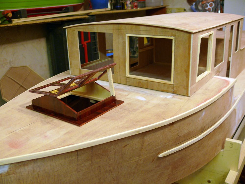

                        The forward hatch is a taster for the forthcoming bling!
                        Bobabell
