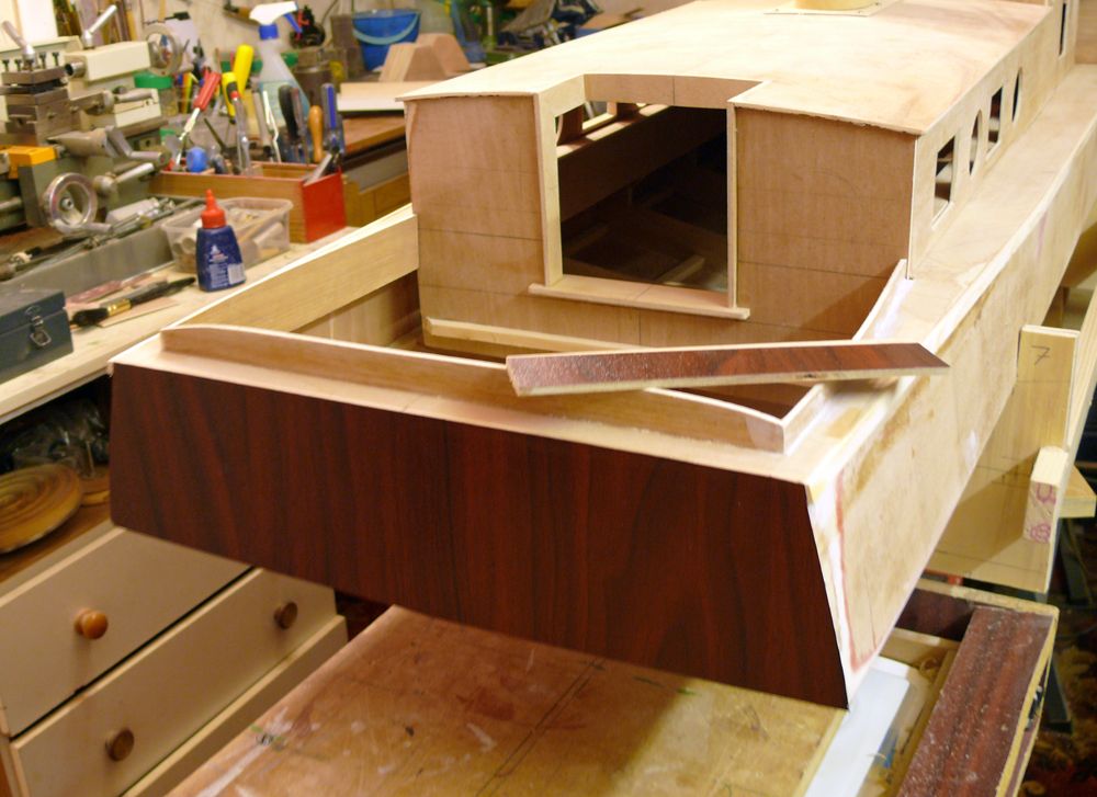

      Is that an optical illusion or on that last picture show the cabin raise to the rear..?
      Ian

        As the grease monkey has pointed out the pictures are actually of 2 different boats both of which were used in the assembly of the Lady Jane design
        #53420
          Hello Ian
          ProbABELLy an optical illusion, but it does look a bit funky gibbon?

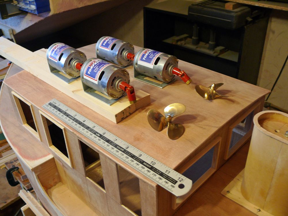

                              Came away with four MFA 850's and two 60mm brass props
                              The motors look handsome beasts and should look very nice once installed

                                Here are the legendary MFA 850`s and 60mm props……..As recco by the Prop Shop chappie
                                Not yet decided on the motor layout yet….Inline or broadside?
                                The Timing belt drives will be pointing rearward, down to the shallow angle prop shaft and out the back
                                We`ve got plenty of time to think about the final the moment……Don`t want to even think about the ESC`s!
                                Thinking about adding some cooling fans in the set up……..Just out of curiosity

                                  I see that you had a good time at the show and hopefully spent large amounts of cash. I trust that the trip down and back again was uneventful except for the singing of rugby songs and stopping at every pub.
                                  My personal opinion is that the motors will look more impressive when positioned side by side but this is just an opinion.
                                  Will you actually need cooling fans or are they just cosmetic?
                                  #53505
                                    Hello Paul
                                    The side by side option is probably the best looking format, since they would look more like engines, when mounted on the Abell housings?…….Not forgetting the compulsory rivetted construction of course
                                    The spare shaft end is ideal for adding a pair of cosmetic fans too
                                    I believe the capacitors are already built in, which is a nice tidy feature
                                    When we get the timing belts, the fun can start!…..Two pinions driving a single large propshaft pulley would look the biz?

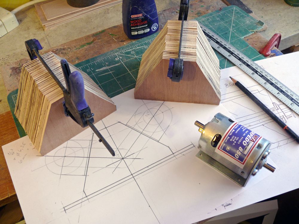

                                            Since you are the Inventor Extradinaire of note……….Can you suggest a method of controlling two pairs of 850 motors from two F14 stix?
                                            #53527
                                              Bob. Unless ACtion do something to handle the expected 20A+ per pair of motors, and assuming by "F14stix" you mean pair of wagglers on your Tx set, then perhaps an Mtronics W-tail mixer might do combined with two 30 or 40A ESC.
                                              This would mix the left and right motor pairs for manouverability and also give you an output for rudder?
                                              OR simply getting a Y-lead for normal one stick throttle operation, controlling two speed controllers..to split the load. I am a bit wary of high power single ESc`s and their ability to dissipate heat, unless watercooled.
                                              This is also a situation for one of those little watt-meters I found. Connect the motors up with shafts and so on, then simply try the pairs of motors in boat in the water with either just a battery across the leads or any handy esc of more than 30A capacity and measure the actual current consumption. So easy with one of these meters. Will give you more idea of the likely load and so equipment requirements and even the need for cooling.

                                                I think one Tx stick per pair of motors and each pair controlled by one chunky ESC…..80 amp?
                                                I hope to use 8.2v stick batts…..One per motor………Have some 12v sticks….(a bit old)
                                                Paul…..Made a start on the ABELL DRIVES at long last….
                                                Need four sets of ABELL letters….20mm high…please?
