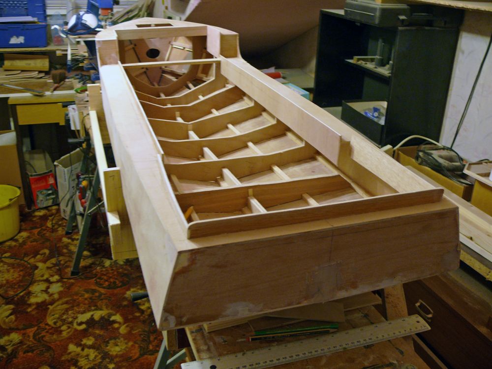

                Made a few lightening mods to the carcass and fitted the coaming

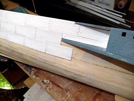

                          Most of my hulls are never…"Nice and smooth"…..Especially on an old type of model like a tug or trawler
                          The easiest way of covering up the scabs and sores etc is to cover the hull with riveted card plates
                          The riveted appearance looks lovely
                          I use thickish card, (about 0.015&quot and glue them on with PVA
                          The riveted effect is punched through from the back, using a hand pressed centre punch…..Accurately lined up
                          Hope this helps?……Bob

                            That looks great what a great method to cover and make the affect of rivet plates.
                            I am tempted to give that a go, it would look more like the real thing.

                              Bob – However nice and great these riveted plates look, I strongly urge you to finish this particular hull as smooth as possible.
                              On "the real deal" usually a hefty layer of filler is used, covering all irregularities and making for a nice high gloss finish…

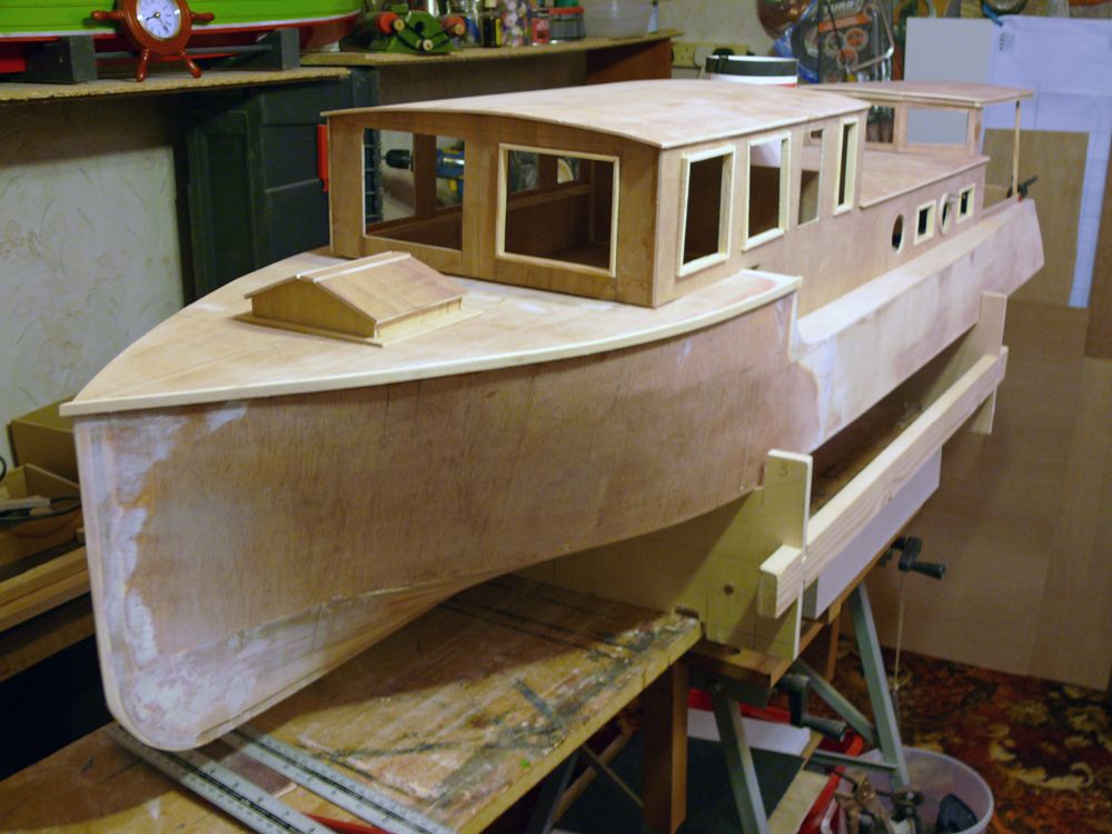

                                  Just a WIP picture for Head Office
                                  Tidying up here and there

                                    I know that you are a keen gardener but is there any need to put a cold frame on the foredeck.
                                    The boat is looking fine.
                                    Have you tried the Abell unit in the hull for size etc.?
                                    #53249
                                      Hello Paul
                                      The original Abell Drives are too wide to go as intended, I could make them fit, by some jiggery pokery, but I could also mount the motors in tandem and then I would not need the timing belts?
                                      Not a bad idea?

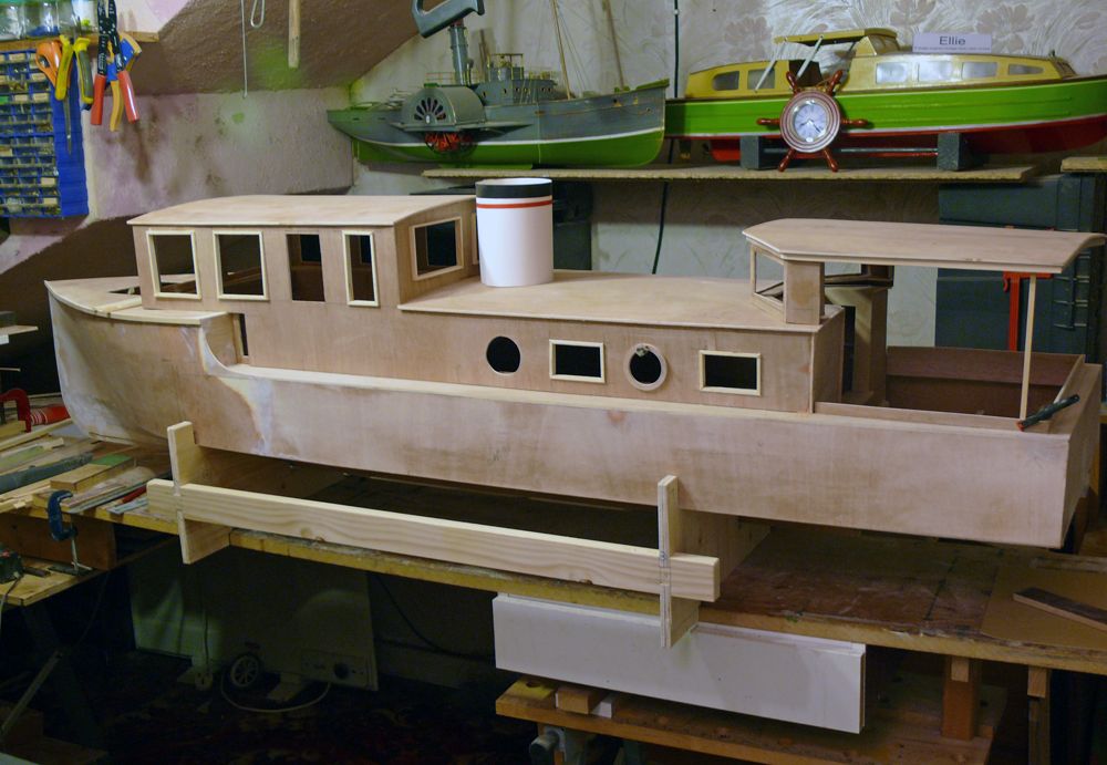

                                                Lookin' good, Bob, that little vent light on the foredeck is a nice touch. (how do you call that in English? In dutch it would prolly be a "bovenlicht&quot
                                                #53262
                                                  Thank you, Diede
                                                  They are called Skylight hatches or skylights or skylight vents…….So you were almost there
                                                  Just waiting for the hinges to arrive at the moment

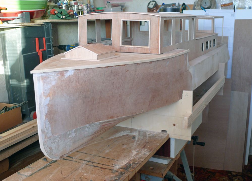

                                                      Made up some of the window frames to see how it will look……"Through a glass darkly"…..hey, Geoff?
                                                      Also chopped the rear canopy down
                                                      BTW Paul…..With the inline motors idea, we`ll still need the Timing belts…….To get down onto the prop shafts of course!
                                                      You should have spotted that and got yourself a few Brownie points!
