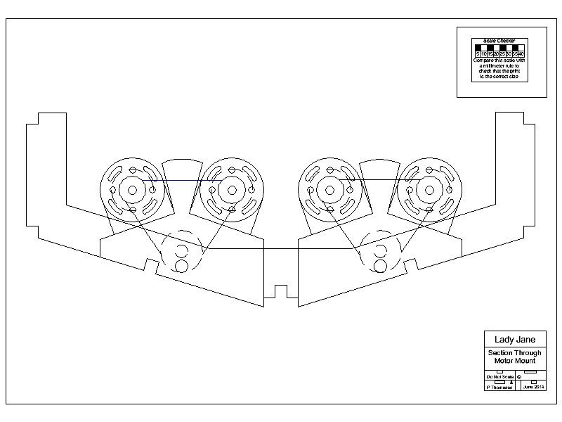

          This is a section through the 6ft version showing the hull split and motor positions.

            Have you got a cross section at the motor position?
            What motors are you using and props?
            What motor is shown on your drawing?
            #52971
              The motors shown are 800s
              I will be using a pair of 600s and I haven't decided upon the props yet.

                Are you aware that the motors can be mounted in several different ways?
                They could be four in a row, with feet horizontal
                Or two pairs of Abell drives
                Or two pairs mounted on vertical walls….etc
                Are you having four motors?
                Reading elsewhere, the MFA 850 motors are not the brightest knives in the box……….Are they good enough for us?

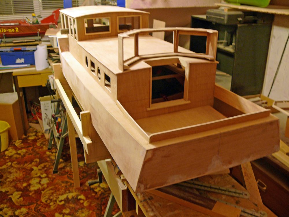

                                    Some progess on the stern section today
                                    It makes a nice change working on interesting detail areas
                                    I like the doorway…..Drat!…..I`ve omitted the chimney!

                                      Great rear deck area Bob, really nice. Great proportion. I would want to be there sitting on a buttoned leather settee sipping a nice cold beer and facing a stack of popodoms and chutney with a gorgus woman opposite whilst watching the sun go down over Molesey lock or somewhere equally exotic. This is of course AmyJ`s lifestyle downunder, only they always have nice weather.
                                      You will need some lights behind that rear doorway Bob, make a feature of it. Great woodwork. A master at work.

                                          As usual your craftsmanship is impeccable and you are to be congratulated on the precision of your woodwork I honestly wish that I had your level skill.
