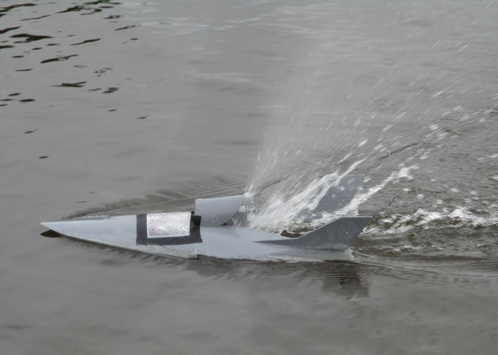

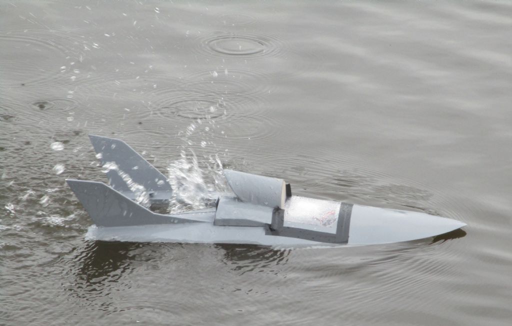

                                            sigh, Sonic performed much as I thought. A lot of spray….and not much else!
                                            neither disc produced anything remotely like "thrust", other than to inch forward, and in fact the aluminium paddles (10mm by 10mm) actually bent, such was the awesome power of the brushless moteur.
                                            I have made two new paddles, and put 20 by 20mm brass blades on….its not ALL blade, the paddle sits 10mm inside a slot in the 12mm wide ply, but its a decent area increase. On the old discs I have shortened the paddle tips…you never know how these things work, to re-test.
                                            We tried a couple of chuck launches and for a few yards it got me hopes up, but it was not to be.
                                            It floats a bit low as seen, but i couldnt make it any lighter. The 2s 2200mAhr battery is probably virtually half the weight ….

                                                  Chris E
                                                    @chrise
                                                    There are just so many variables here. Do you have a dimensioned plan to follow. Do you really know how well the original worked?
                                                    Coming from an aeromodelling background I would suggest that you might start by adding as much lightness as possible.
                                                    Then rotor speed, blade size & shape, blade immersion, c of g – the list just goes on.
                                                    This might well be a long term hobby!
                                                    #101888
                                                      Ultimately, I think that weight will be the issue. The original had nothing but a glowmotor in it.
                                                      The boat as it stands weighs 350g with a 2200mAhr 2s Lipo (200g) so I am not sure I could have made it much lighter UNLESS I used foam exclusively.
                                                      Trevor has a smaller Lipo and I will beg him to see if he will let me try the boat with it. I might save 75-100g !
                                                      At the moment the entire hull sits in the water, that’s some drag.
                                                      I am using a plan, it’s printed out slightly larger than original 20 vs 17” long but if the boat was smaller more than half of it would be underwater!
                                                      Its a fag but I foresee a lot of paddle making looming to try and get some thrust.
