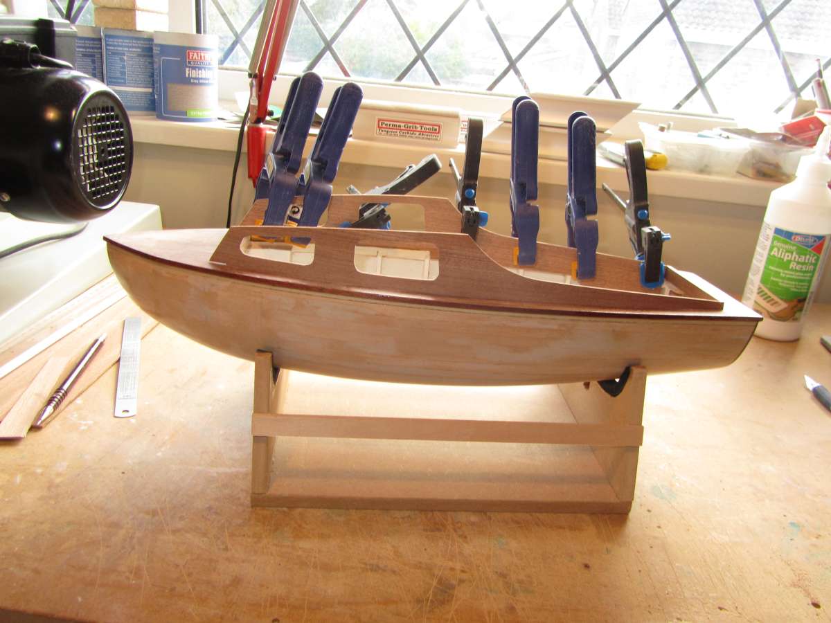

                  #126014
                    Back on the Faun and have glued the cockpit/cabin sides in place after removing some of the cockpit sides so that the hull will be visible as per the full-sized boat. First time I’ve built a fixed superstructure model. Access to the motor etc. will be via a removable cabin roof.
