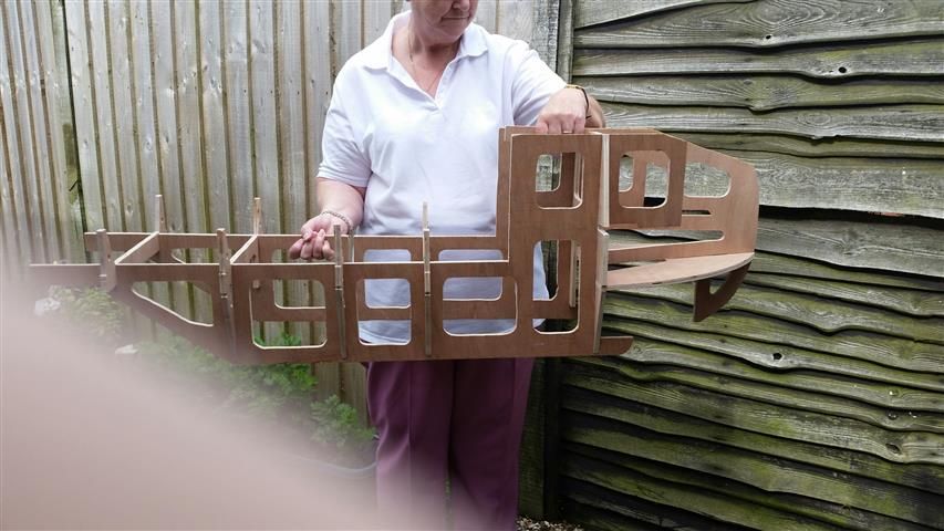

          These photos are of Mikes very impressive version of Thor, Mike has been lucky enough to have help from Elaine, his glamorous assistant and all round font of knowledge.
          The basic frame

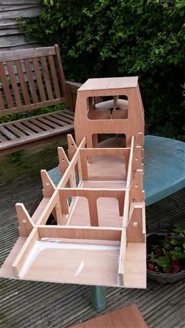

          Close up of the detailed woodwork in the forward section

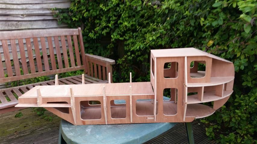

          A overall view showing the internal structure.

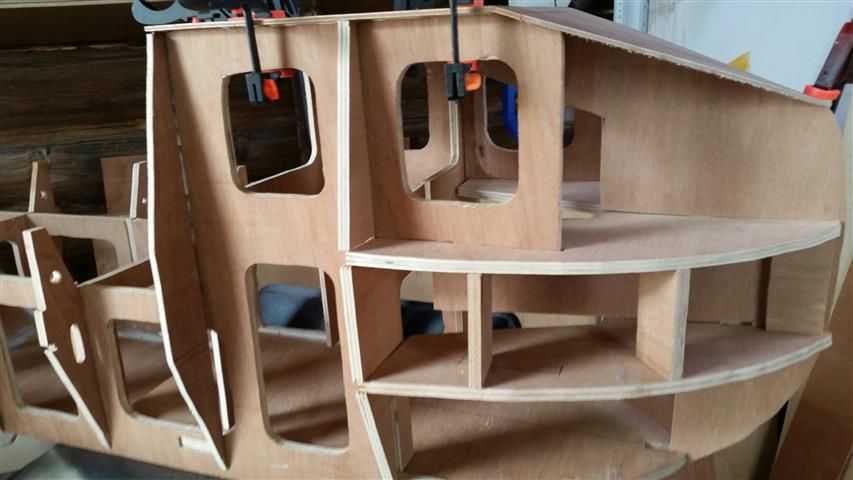

          A long view from the stern.

                        Now then all ,I followed Pauls drawings to the letter and any good comments should go to Pauls complicated design.
                        Picture 1 shown ,the skeleton held by Elaine has no glue holding it together as if followed the design will all hold together with one part as in a jigsaw
                        when sure of the design I glued all parts.
                        This is a heavy weight boat -my local metals expert questioned the amount of Lead I ordered (4 stone) until he saw the frame
                        All but one piece is in 9mm ply .The lower parts of the hull will be skinned in 3mm ply . The upper and superstructer will be in 1/32 ply
                        The lights wires for the port and starboard are hidden in the hull and in the upper super stricter .It will carry search lights and inner lights
                        I was going to carry port hole windows but made them (outside frames) too heavy so scrapped them and may start again. Thanks again for your kind comments Michaelwink
