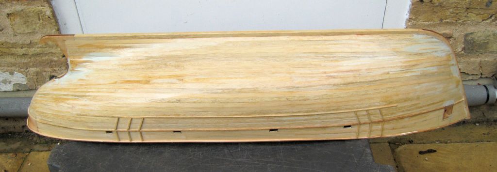

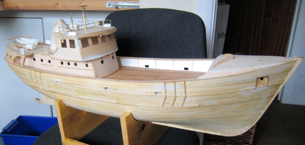

      Outside of the hull now coated with epoxy. I used Pacer Z-Poxy
      pre-warmed and undiluted. It’s gone on pretty thick and left a
      glass-like shell. I will now sand it with wet and dry to smooth out the
      imperfections and provide a basis for painting. I will be using
      Halfords aerosols, red oxide primer and Ford Fjord blue, followed by a
      satin varnish. The question is, do I need more than one coat of epoxy
      before painting? Any advice would be appreciated.

        Gosh you like asking controversial questions!!!    considering the conflicting advice so far I think you will have to make up your own mind!!!
        BUT 2 coats would be stronger that one….perhaps only applied below the bottom rubbing strake?
        Great hull shape. Nice job. Deserves to be taken into some rough weather to bob up and down a bit in proper fashion.

          I agree with Ashley about the number of coats, I only apply one, but 2 would be better I suppose, it depends what you plan on running in to
          The hull is looking good, and the deck planking is very effective, a good job all round.
