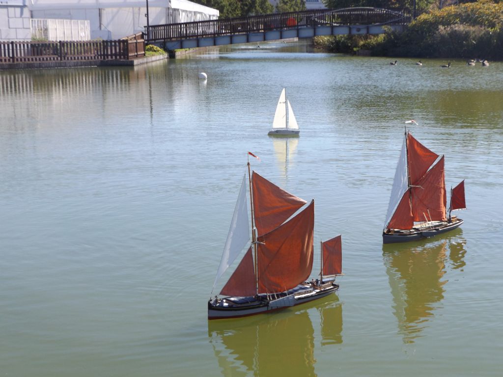

                Hi. Ray nice photo of the two boats, sorry about the caption of you three skippers, couln't resist itcheeky.
                Management is going to hairdressers tomorrow that means Roger and I can go to Hearne Bay for a mornings sail, then to Ramsgate on Thur. with the Tug, and a final morning at Ramsgate on Sunday morning before travelling home.
                Going across the wind the boat just goes sideways, I cannot get any foward drive to get the keel working, anyone any suggestions? even if it's the cr – -p helmsmanblush.

                  Hi Tim,
                  Trying to keep all the balls in the air, just received a couple of FMS 50mm fans from George at 4Max to build a Tony Nijhuis Jet Provost which was a recent free plan in RCM&E
                  Eddie,
                  If the winds coming directly from the side, your main sail should be let out to 45 Degrees and you will be broad reaching, that should work
                  If you had a separate vang control you could let the sprit out slightly aswell.

                      I am going to stop trying to keep up!!
                      Eddie
                      Expanding on Ray a little bit, it sounds like you are over-sheeted. The wind coming from the side should be the fastest point of sailing. The sail position on a reach (wind at 90 degrees) should probably be out even more than 45 degrees especially in light winds when the apparent wind will not go forward too much.
                      The trick is to just have the luff of the sail full. If it flutters the sail is too far out and if over sheeted the sail stall and stops producing lift (drive) and the drag goes up a lot.
                      In the real racing world people tend to relax on a reach and a run but the winners will all be constantly trimming their sails.

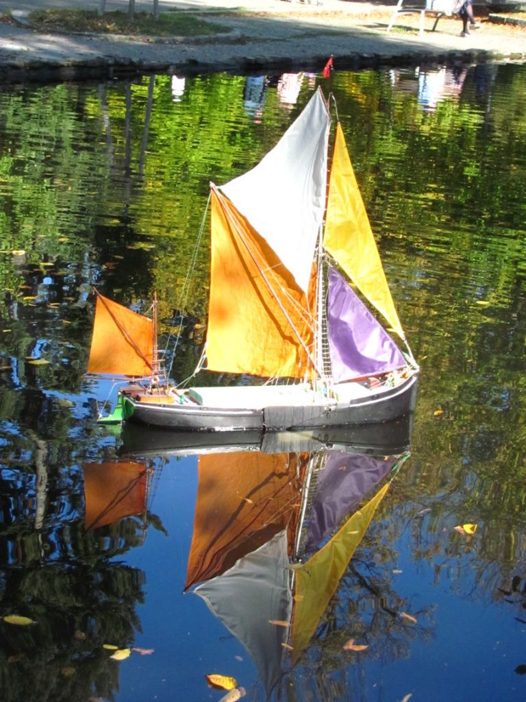

                                      Hi,
                                      autumn in the park – I took advantage of the very warm weather and went to try the tomcat in the park (while there is still water in the pond).
                                      after about half an hour the model stopped responding – I did not measure any battery voltage. Only then at home did I find out that it was a 1A fuse .. bad luck .. Next time I take more fuses with me.img_1865.jpg
                                      #84193
                                      tomarack
                                        @tomarack
                                        Hi,
                                        I put the photo once more

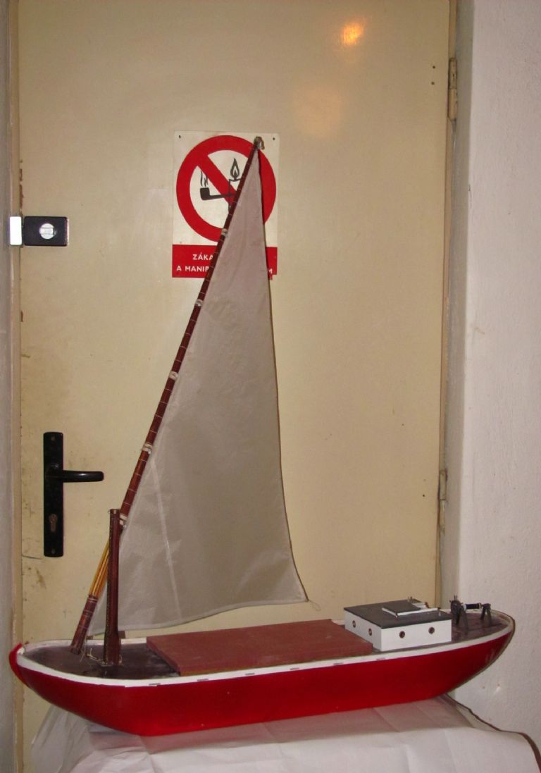

                                                  Hi,
                                                  I am slowly building the Piscataqua River Gundalow. today I tested rigging settings. But I still have a lot of work to do – finish spraying the hull, rudder, engine, electronics, fin with a lead bomb of about 850 grams ..
                                                  Photos are here on the album or on> **LINK**
                                                  #85464
                                                    Hello Tom,
                                                    The rig is good and simple with the single sail, rather like our Norfolk Wherries, our sailing barges are in hibernation, but must start preparing for the new season soon 😀
                                                    All the best from the UK
                                                    Ray

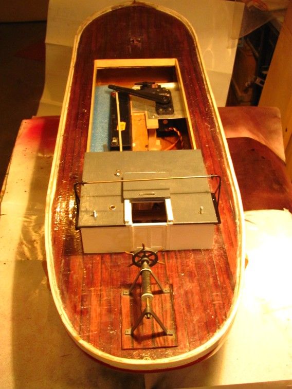

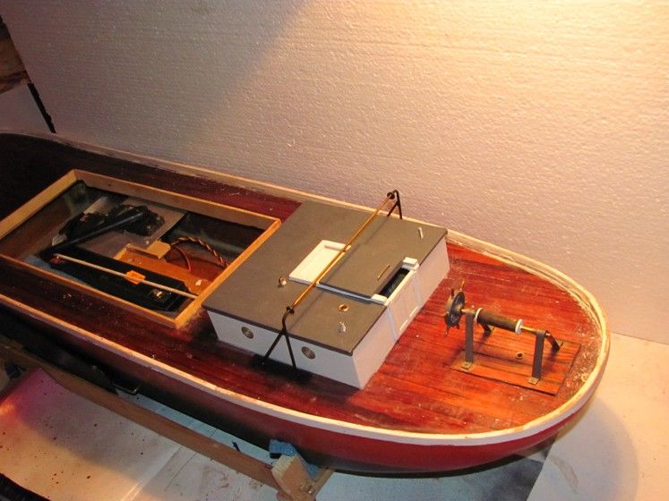

                                                      servos and main horse in placeservos and main horse in place
                                                      the construction of the model slowly continues. The worst thing is finishing the model and details. greetings
                                                      Tom
