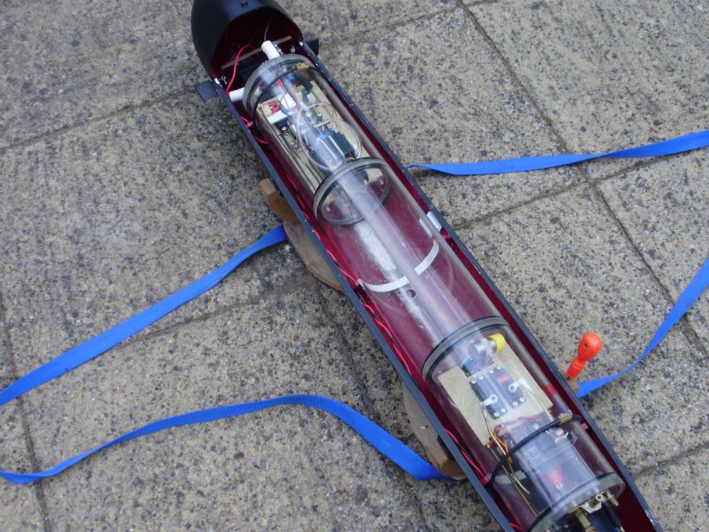

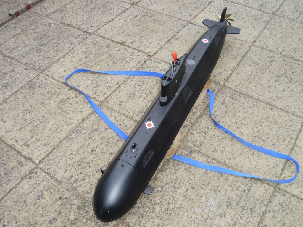

        I have obtained a Submarine however the Modeller passed away . could someone have a loo
        k at photos and let me have as much info as posible . how it works ,type etc i have made some presumptions but need assurance . eg trafalgar class , dynamic dive . thanks

          It looks like an upholder class with static dive tank. I think it is from OTW
          I would look on mayhem for more advice there is a couple of guys who are very experianced in submarines ad will guide you. I am unsure if they post here

                The sub in the photo is def an Upholder from OTW.
                All four were sold off to Canada to become their new Victoria Class SSK (diesel electric hunter killers)

                  …and also, I forgot to mention that the model sub is not a dynamic diver.
                  OTW fit a full ballast system into the clear tube, the middle tank is the ballast tank which can be filled or emptied to dive/surface.
                  Should be a nice little runner once she is ballasted properly.

                    thanks steve . after visiting gosport sub museum i sent to there archive , and they were very helpful sending info and photo of the actual hms upholder .
                    when i got back i took the plunge (well the sub did ) and it went great .i was a bit apprehensive has the water was dirty . but i managed has my first sail to submerge it but kept the conning tower above water . it did run nice and i was very pleased .regards Brian
