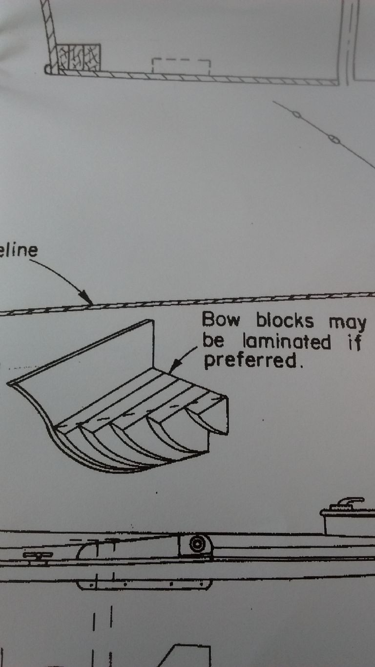

                Hi Steve no worry's I thought you had started ,choosing the right glue make all the difference ,my next project also shows solid balsa for the bow ,you could even make some profile templates ……markimg_20160326_124851830.jpg
