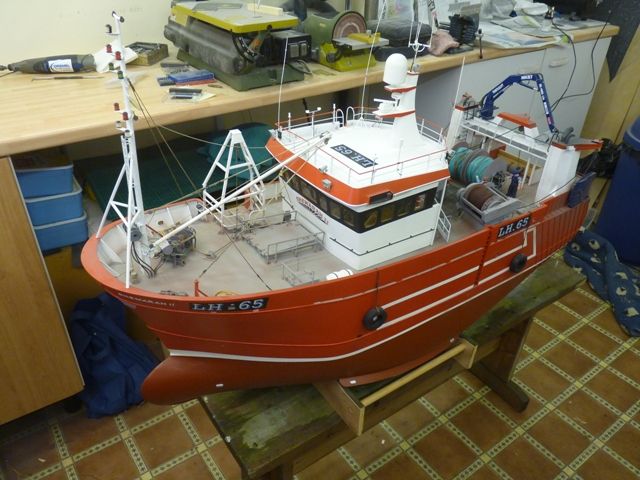

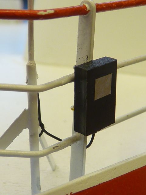

        I have managed to get a few more bits done over the weekend. I have fitted the black boxes that sit near the bottom of each tall whip aerial. I am not sure what they are, I guess its some sort of amplifier or interface box.

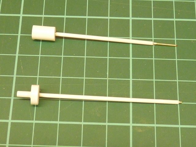

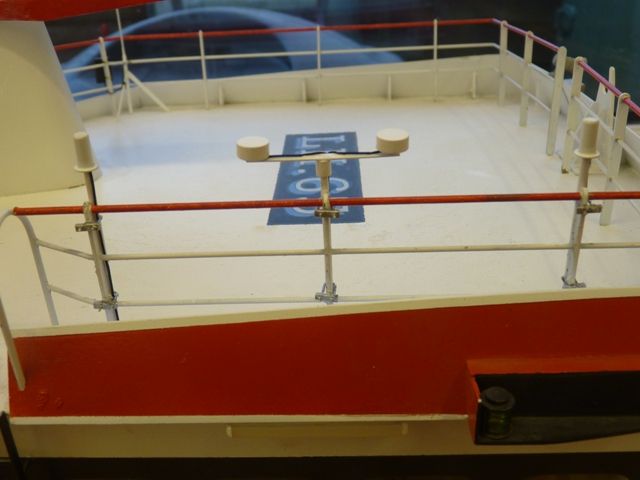

        I have made and fitted the aerials on the RHS of the wheelhouse roof.
        I have also made the ones for the other side but not fitted them yet, still waiting for the paint to dry.

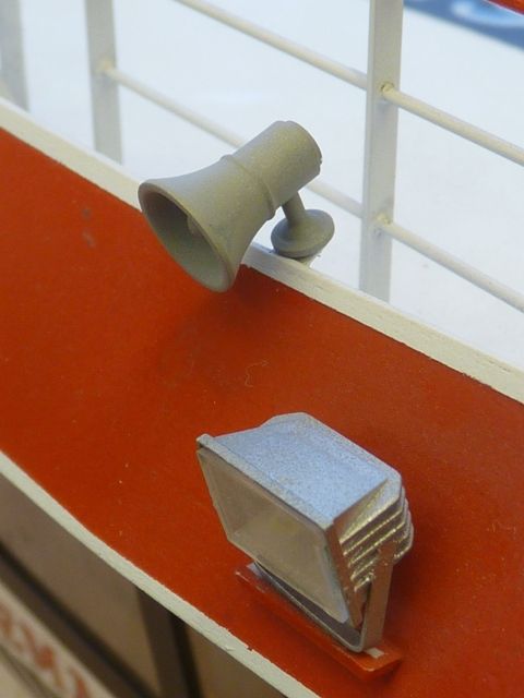

        I have fitted the loudspeaker that sits on the front of the wheelhouse roof.

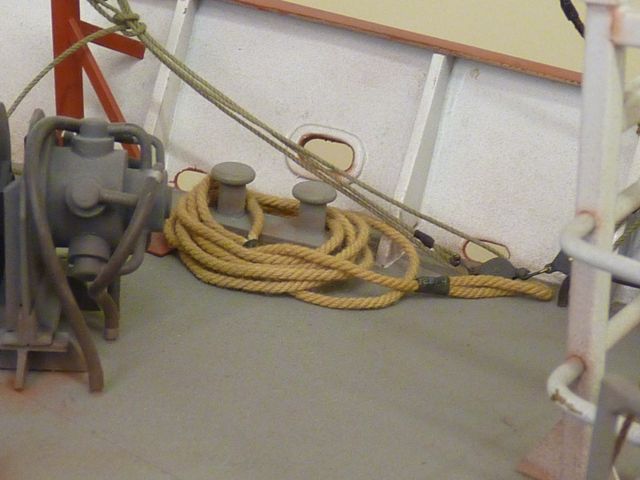

        I have also made and fitted the mooring ropes.

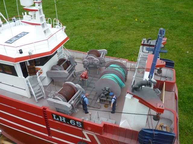

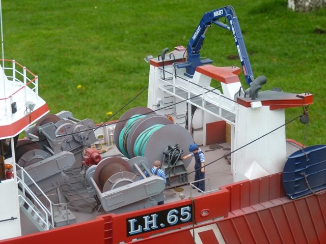

          Well after just over three years work Shemarah II is just about complete. Only the sound system to tweak and a few bits of touching up and weathering to do on the paintwork.

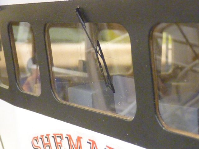

          I have added the windscreen wipers, front and back

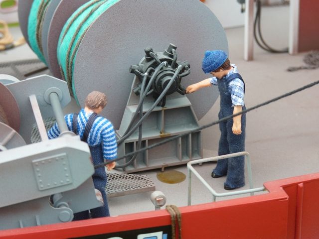

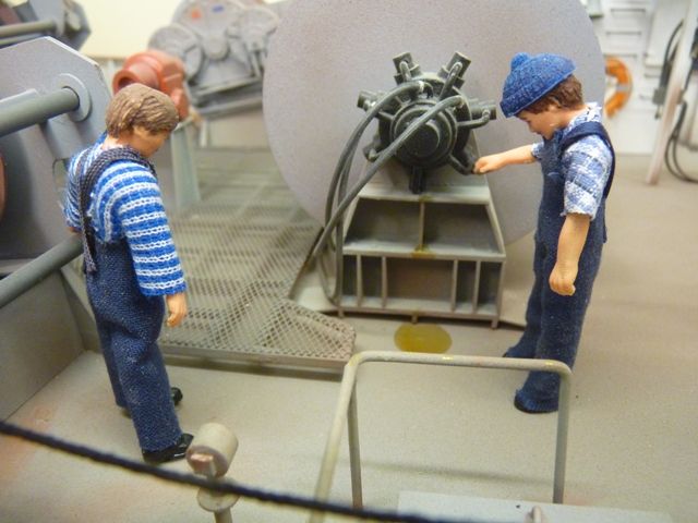

          Two of the crew are studying a bit of a hydraulic problem with one of the net drum motors.
          (it's not real oil, just a drop of old varnish)

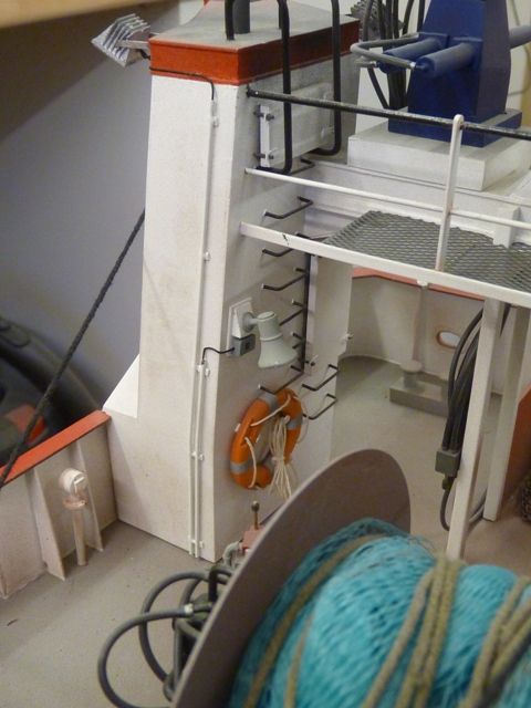

          The conduits and loudspeaker have been added to the rear gantry.

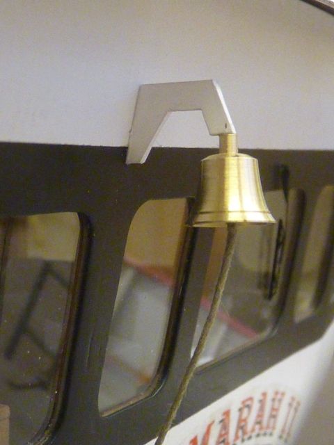

          And the final bit to be added was, symbolically perhaps the ships bell.

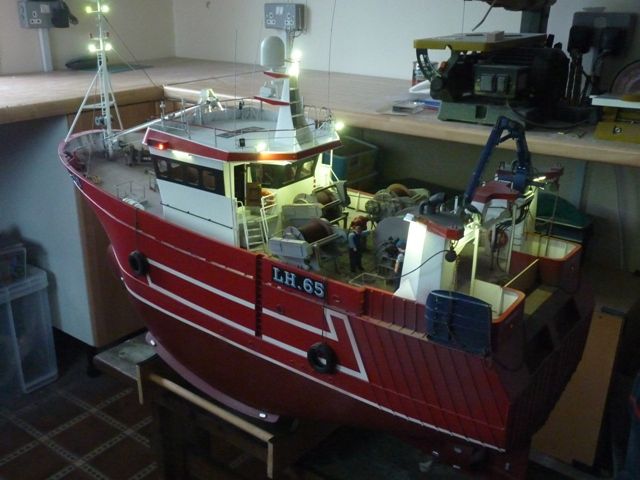

          Unfortunately its tippling down here at the moment and forecast to do the same tomorrow so you will have to wait a while for some decent sailing photos. However here are a few I took in the workshop this evening.

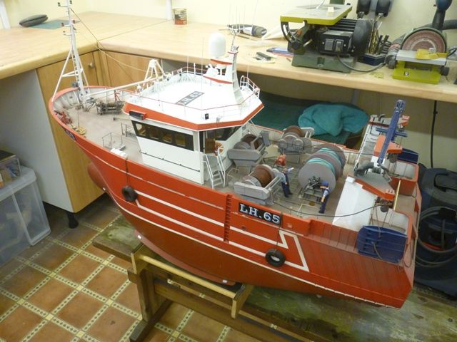

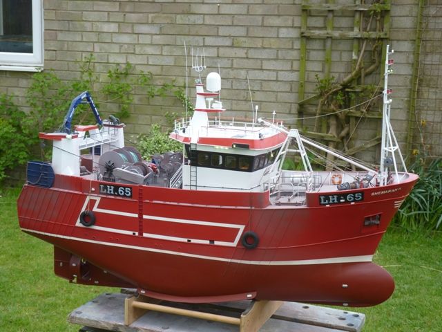

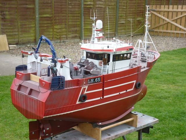

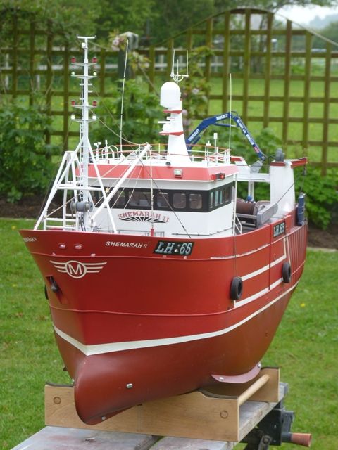

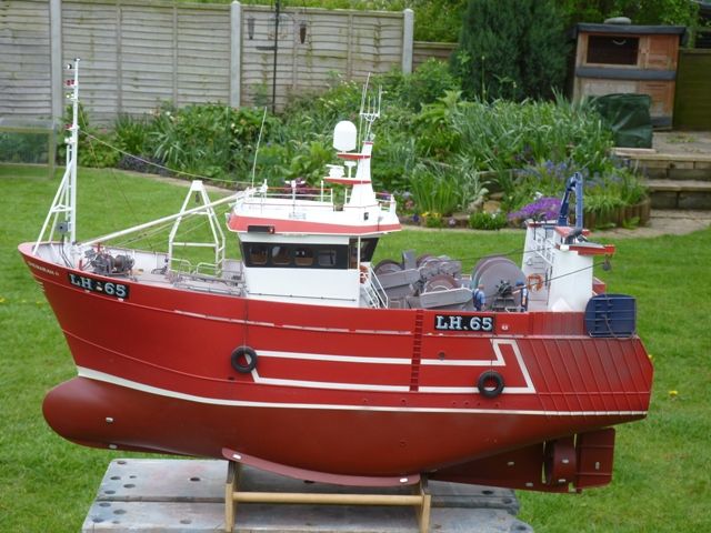

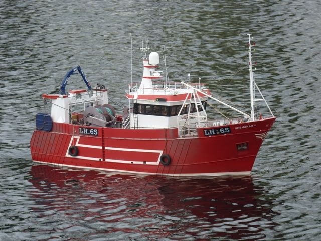

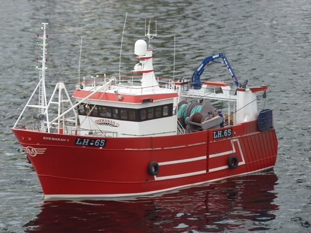

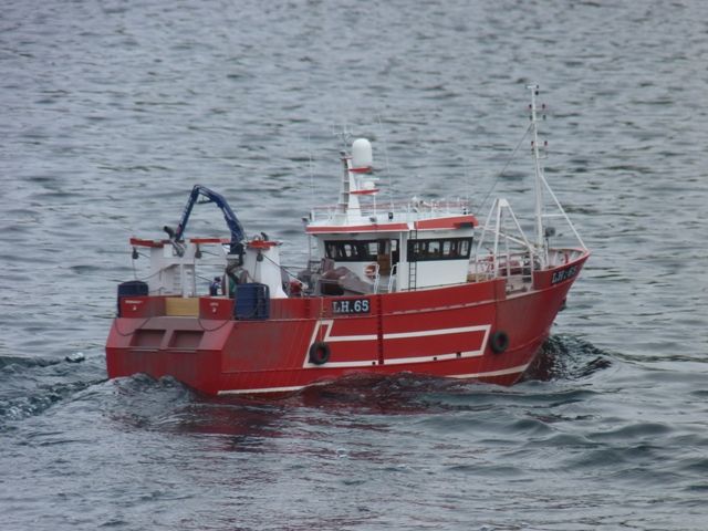

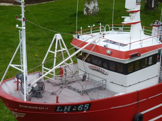

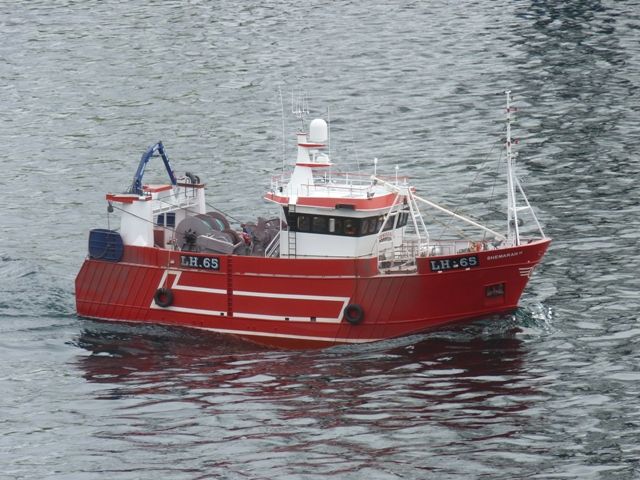

                Here are some photos taken of the finished version of Shemarah in our back garden plus a few on its outing to Sidney Park in Grimsby this morning.
                I have still got the sound system to tweak and add the supplementary sounds to the engine and I am still on the lookout for some better fishing nets, apart from that – its done.
                Thanks for all the interest shown in the blog, its been an entertaining few years and I hope you have all found something interesting to read and see. Maybe I will start another on my next project, but you will have to wait a while for that.
                Regards
                Gareth

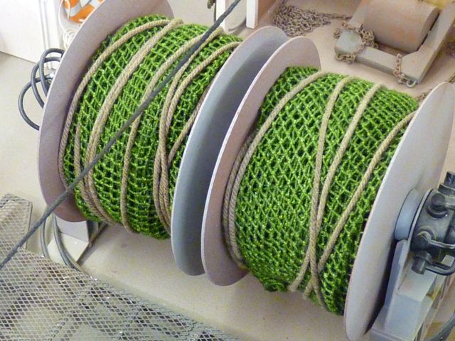

                    I have finally taken the plunge and ordered some filet lace for the fishing nets. The only source I could find was in Florida but after a couple of weeks its arrived and looks much better than the original plastic netting. Its made from cotton and literally is a knotted het, in this case with holes about 3.5 mm across. I have dyed it green and the colour has come out a bit vivid but with time it will fade and accumulate a bit of dust and general debris. The netting was quite expensive at $15 for an 18 inch square but does look much more like the real nets.

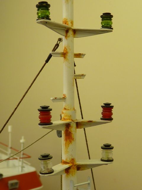

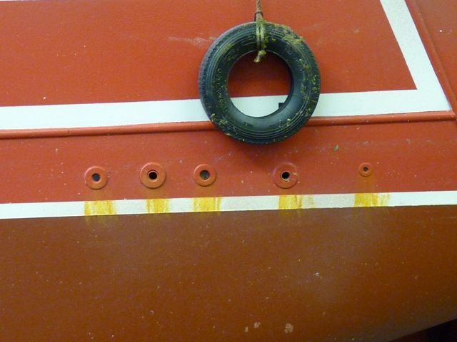

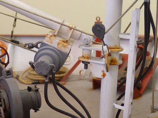

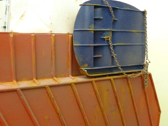

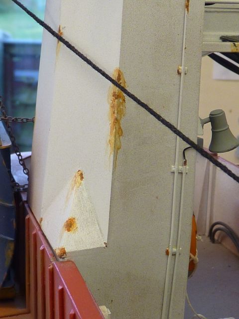

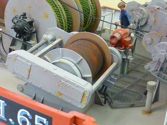

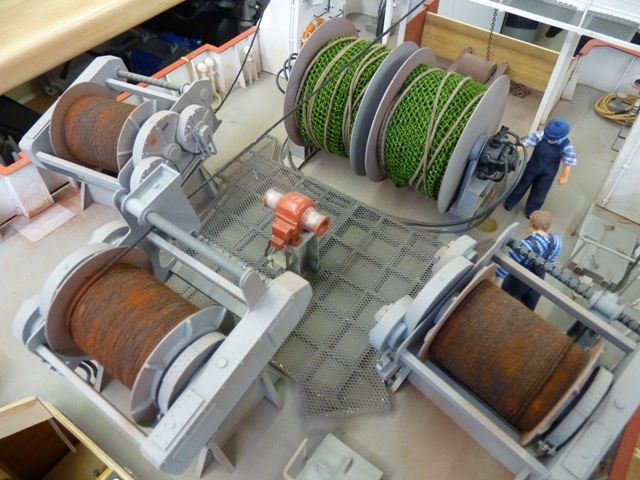

                      Somehow, no matter how long you spend on a model, there is always a bit more to do. I decided that Shemarah really neded to look a bit more weather worn than she did so I have spent the last few weeks adding a few rusty areas. I have had varying degrees of success with this in the past but after a bit of practice on my original model of a TID tug, I have come up with a process that seems to work.
                      The model is painted overall in acrylic paints. I add a few spots, streaks and patches of Revell rust brown acrylic in areas where the paint will get damaged and the underlying steel will go rusty, i.e. corners, edges, crevices and joints etc, working in a small area at a time. This is then left for an hour or so to dry. I then go over the same areas with a small brush, just spotting in a small amount of a lighter orangy brown Revell enamel. Before this has dried I take a slightly larger brush, dip it in cellulose thinners and dry it on a piece of paper towel, just taking the excess thinners off. Using this nearly dry brush I then wash the lighter brown over the area, working it downwards in the way that water staining would spread from a patch of rust. The underlying dark brown acrylic is not affected by this and remains visible under the 'stain'
                      Here are a few examples on Shemarah:-
                      The rust on the wire rope was done using Humbrol weathering powder.
                      The process seems quite good at producing localised rusty areas. Its perhaps less effective in a large area whre you need a combination of rust, water staining and general muck. So far I am quite pleased with the effect, just got a few more areas to attend to before Shemarah gets packed in the car along with my wife's collection of yachts to make the trip to Haydock Park next month.
