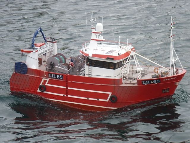

            Gareth Jones
              @garethjones79649
              Avia,
              I like to work in 1:24 scale as I find its possible to get a lot of detail in the model without getting too fiddley. You might like to look at my Shemarah II build blog and album before making up your mind. You might even be persuaded to build Shemarah. I don't know of another model built to that scale, although a few others were started using the same plans.
              https://www.modelboats.co.uk/forums/postings.asp?th=45819
              Gareth

                  Gareth,
                  I have those plans sat right here on my desk right now!
                  I also have your build log on Shemarah II saved on my laptop, all 33 pages of it!
                  I have to admit, she is a gorgeous sip and model too. You did wonders with the build of it too!
                  I wonder, are there any other trawlers that use the same Campbeltown hull as Shemarah II, as I'm looking at doing a different named vessel if I can find one?

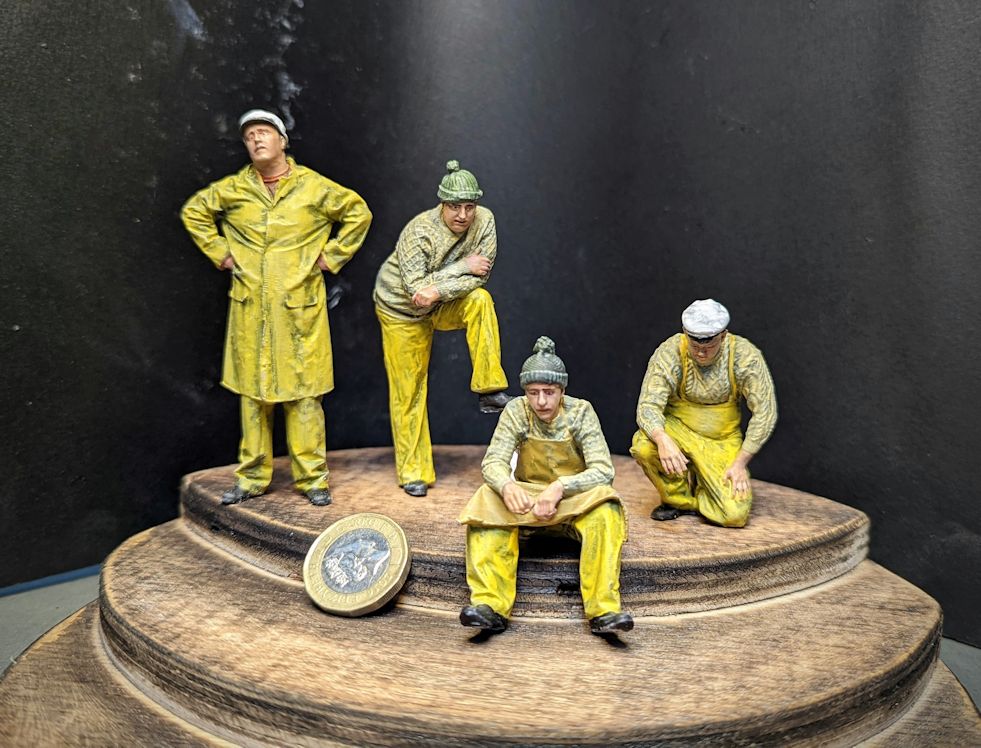

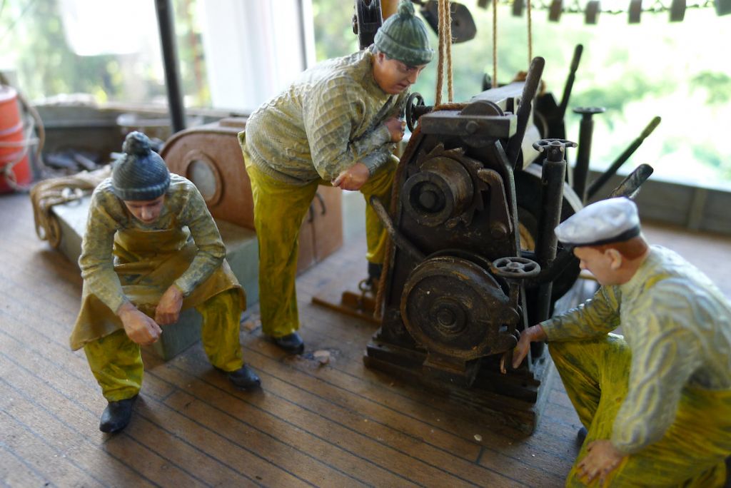

                  #104622
                    There are also some very nice figures from a supplier called ModelU, who will actually do figures to a bespoke scale if you ask them to. There are standard scales though as well. If you want to travel to meet them in Bristol they will do a scan of you and reproduce a figure of yourself to any scale you need. They also attend shows such as Model railway shows where you can get scans done. Check the website for show attendance.
                    ModelU trawler figures are here: ModelU trawler crew
                    They were reviewed in Model Boats Magazine November 2022.
