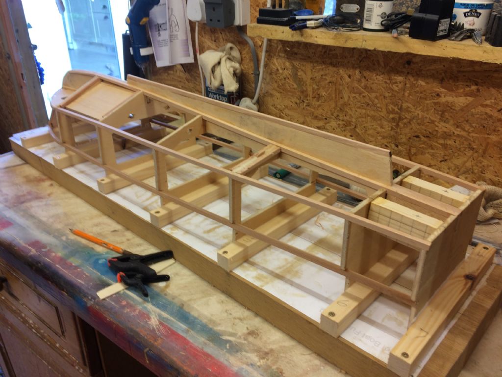

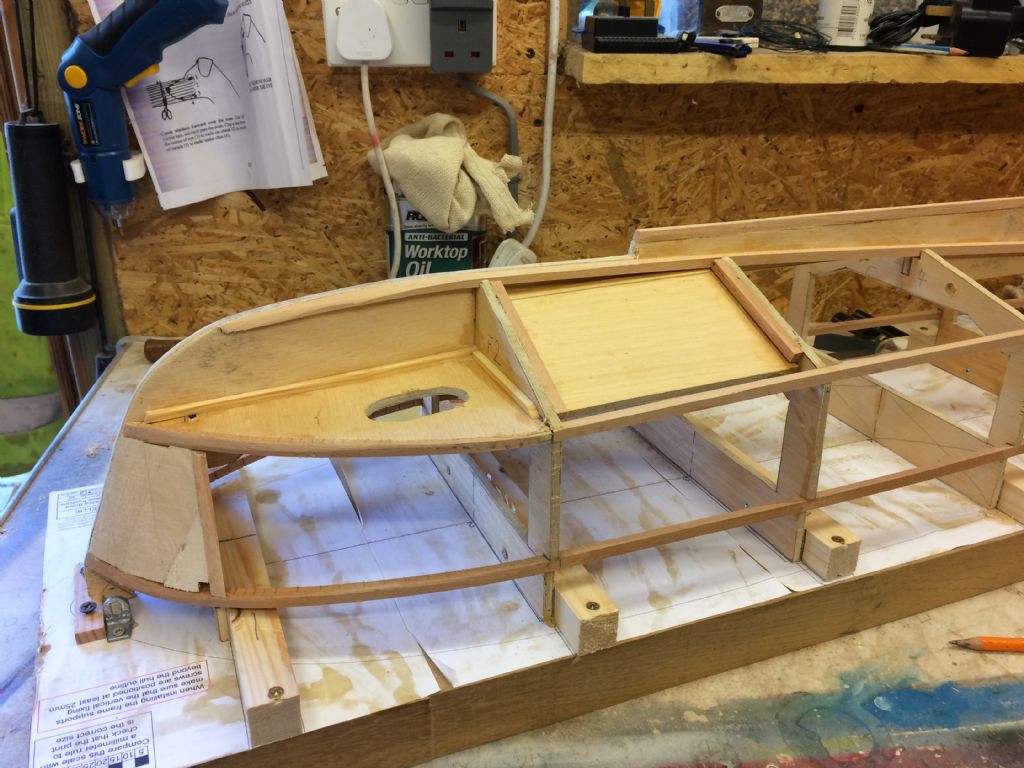

                            Guys just to let you know I finally got started on my Ellie build after getting "nearly finished" on Smit Rotterdam.
                            I have been building for a couple of weeks off and on and have nearly all the pieces cut out and the hull is coming along. The drawings are great and have made the build fairly easy. Many thanks.
                            I made the decision to fill the bow with balsa blocks and sand them to shape to give the 1.5mm ply something solid to follow when bending.​
                            In the end I bought one of the little Hoover steamers and it works a treat for bending the ply to shape but the balsa I feel helped firm things up during the process.
                            I opted for the twin motors as I have a pair of JP Pro 480's lying around which I am worried may be a bit "whizzy" so am have opted for a pair of Brass Propeller (A Type) 25mm R/H-3 Blade-M4.
                            If I can remember how I will try and post some pictures.
                            John

                              You are right about the 480's providing plenty of 'umph' but don't worry about them overpowering the hull as it was designed to accommodate up to three 500's.
                              I am looking forward to seeing the build photos.

                                Hello Paul
                                Finally got the bow sorted me thinks. to make sure I poured a dollop of Fast-glass resin into the space and stood the hull on end. Just as well as I had to tape the seam to stop it leaking.
                                Cut back the bulkheads and sanded down ready to coat with sealer. Intend using the Eze-Kote system as I have never tried it before in fact I have never coated the outside of a hull with anything but paint before!!

                                  Pulling the ply around the bow is the hardest task in this particular design and everything else should be plain sailing. You are not alone in your thoughts about the bow construction as my bow designs have been the subject of discussion especially amongst some of the more senior and distinguished members of our hobby.
                                  Eze-Kote is very good but being a skinflint I usually use a car spray primer/filler to seal the hull as it is much cheaper (usually from £1 shop) and is compatible with most cheap car paint spray cans.
                                  If I have a large boat to spray/seal I use the road marking spray cans that are available at Builders Merchants or B&Q, cheap as chips and easily rubbed down to a fantastic smooth finish.

                                                      Your pictures of the later stages show what appear to be gold-coloured studs on the skins at the location of the frames. Can you please tell us what they are?
