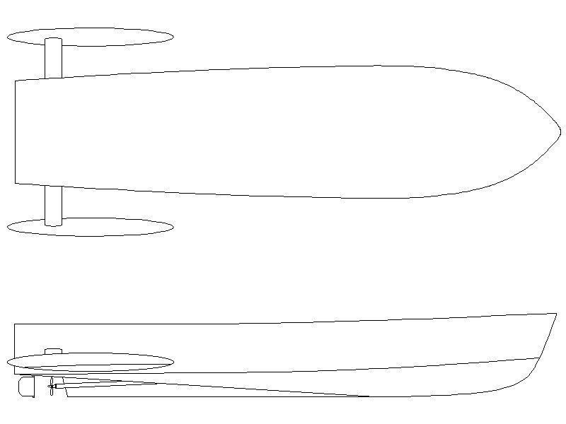

                I have been playing around with outrigger shapes and come up with this
                The outrigger sponsons are just in the water so they don't add any drag but they will help with stability when making tight turns.

                  Flash Gordon!! I can see now that we were right to insist on some fins and so on.

                    Very interesting add on?…….The floats look a bit small though?
                    The rudder on SloMo is about 50mm behind the transom…..If that is important
                    How do you think SloMo will perform as she is at present?
                    From memory, John Cobbs racer had something like these outriggers?…..I wonder why?

                      The floats are only to aid the turning and positioned in the correct place for your extended rudder.
                      Your Slo Mo should perform perfectly well in its present layout.
                      The Cobbs racer was a stepped hydroplane and had a different shaped hull (shorter and narrower) the outriggers prevented it from rolling.

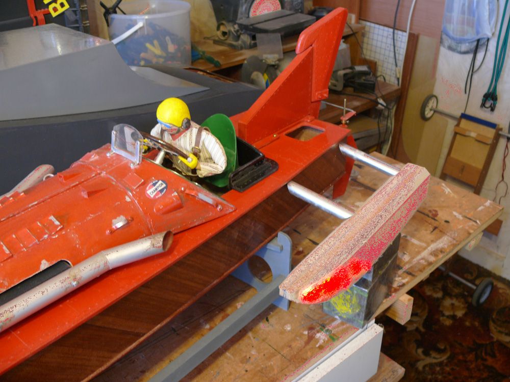

                              Just roughed out the sponsons and they are probably are too deep, but it`s a starting point
                              Got time to spare at the moment, while waiting for the prop shafts to arrive
                              One nice feature is that the support tubes can be horizontal and can pass through the hull for easy fitting!
                              Imagine the sponsons to be bright red with plenty of ali rivets showing through……….Nice!
                              Any comments?………Anybody?
                              The method of attachment is rather neat and tidy
                              As Paul says, they won`t increase performance but may be needed for high speed turns

                                Is it me or the photo, but they look a little high. Not quite in the water. Other than that, looking good, can imagine them in bright red, flashing through the water.

                                  Just not quite touching the water may be the correct setting?….According to the drawing office?
                                  But not to worry……I'll make the height adjustable!
