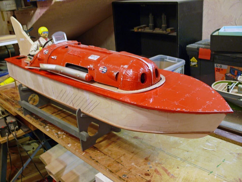

                      Work in progress
                      Covered the deck with riveted plates plus a coat of Santa Clause……..which is always`s a good crowd pleaser!
                      Made a start on the diagonal planking layout
                      What do you think of the show so far, chaps

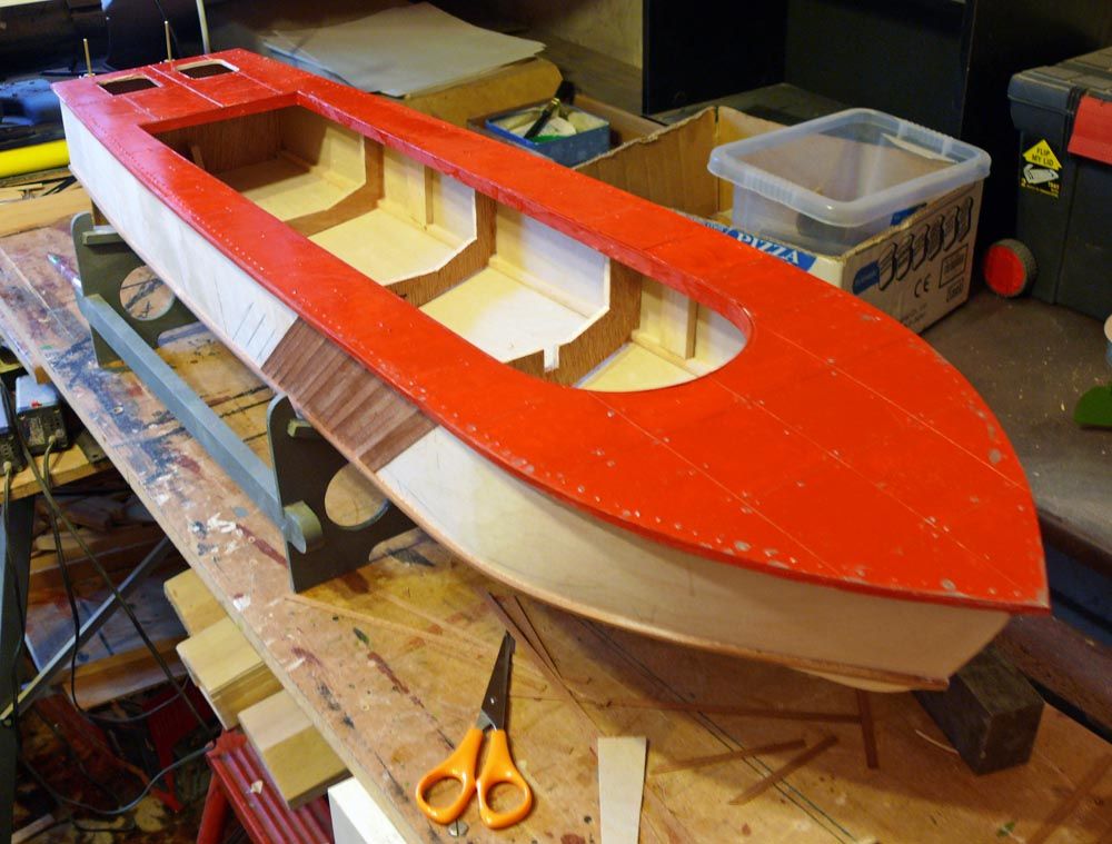

                      #45934
                        Special picture….Requested by a loyal Lurker
                        Also an early picture of the snazzy planking!
                        Like it, our Geoff?

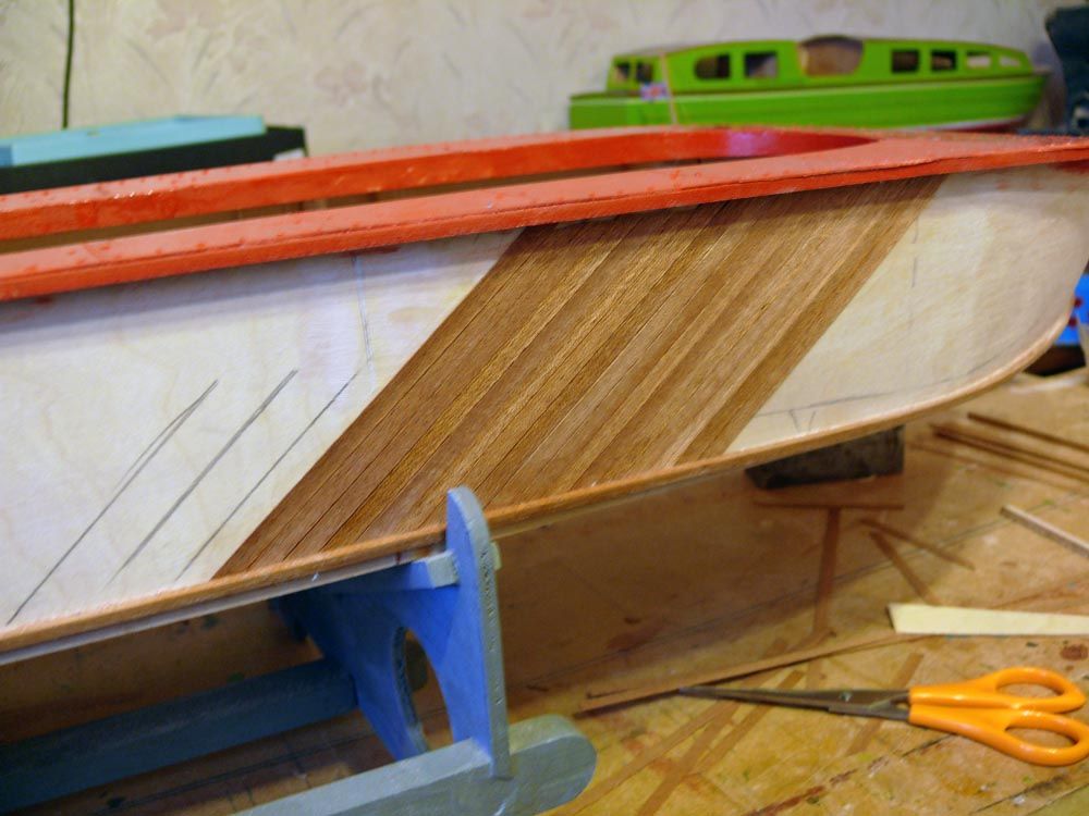

                            Planking the hull sides is very relaxing
                            Of course, I can`t wait to slap the varnish on!
                            Plus a few chrome fittings………That`ll be nice
                            Head Office is rather quiet these days?
                            Andy……..The rivets are very easy to do………I use an impact centre punch from underneath

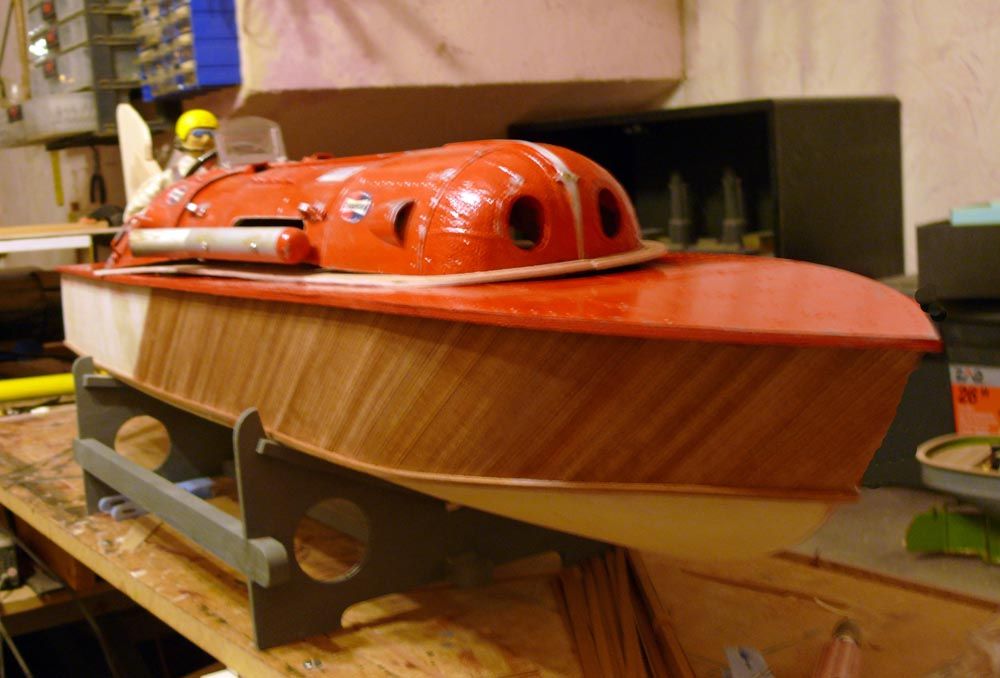

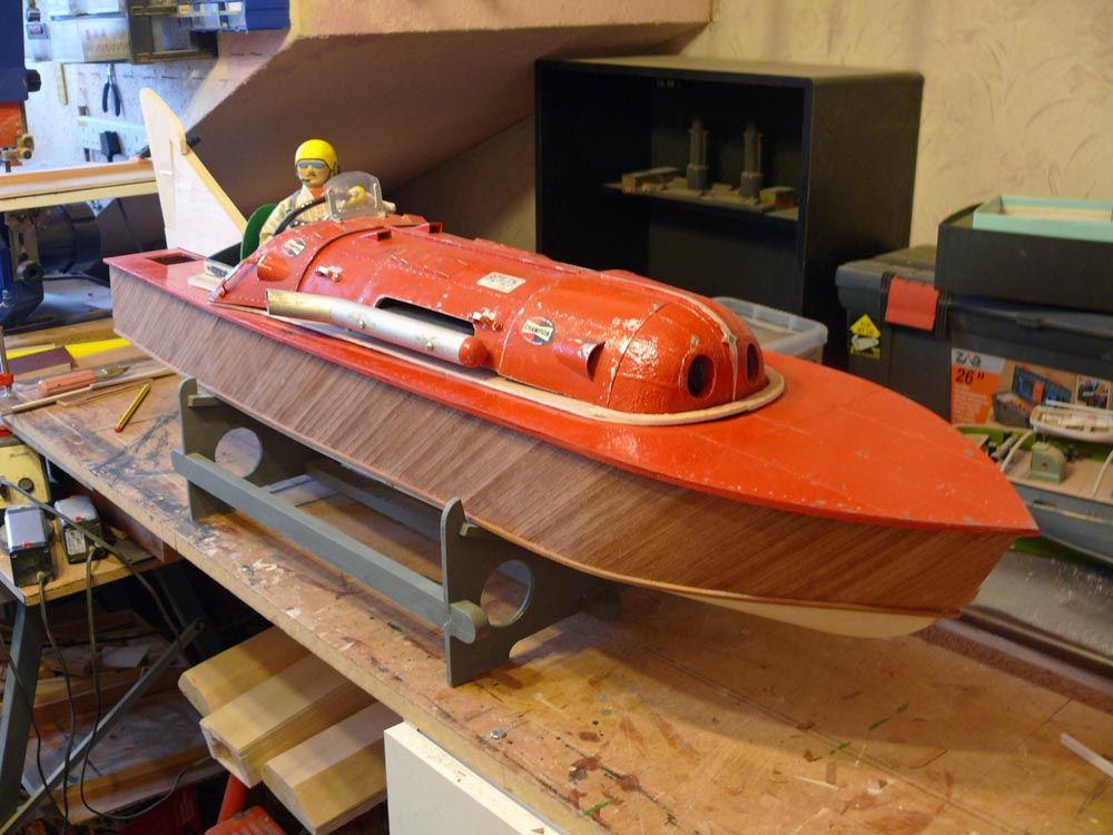

                                          Latest progress picture
                                          Veneer finished including the "DA"……….Only Teddy Boys of the fifties will know what that means!….lol
                                          Engine compartment being lowered and lightened
                                          C`mon, Larry……You like it now, surely?
                                          #46005
                                            Bob. Coming together now. Like the veneer, and the red deck suits the top, which is now looking to be a good fit (rather than too big)
                                            Are you happy with the very small fin size..know what I mean ?? It is barely sticking above the pilot. Could it do with being a bit bigger?

                                                Thank you Ashley
                                                Are you serious about the fin height, or are you pulling my leg?……….It's about the correct height, really………Could be ever so slightly a bit small?
                                                I'll look into it though

                                                #46012
                                                  Bob, not pulling leg. I would make it a bit larger myself, however of course I do not have the boat "in the flesh" in front of me to judge this by, only your photo.
                                                  I am just giving a point of view, if you would like to consider it. Perhaps a card fin of larger dimensions could be propped up against the fin to see what you think?
                                                  As I have said before it is your boat and I would not want to influence you unduly. yes

                                                    #46126
                                                      Ashley….I`ve had a second look at the fin size and decided it`s about the right size
                                                      We can reconsider it again shortly, when it`s finally in position and painted the correct colour
                                                      Thank you Ian……It should look even better when varnished
