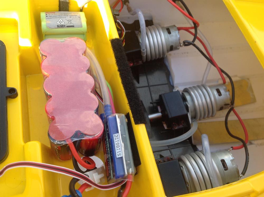

                                        Lesro Sportsman
                                        #45763

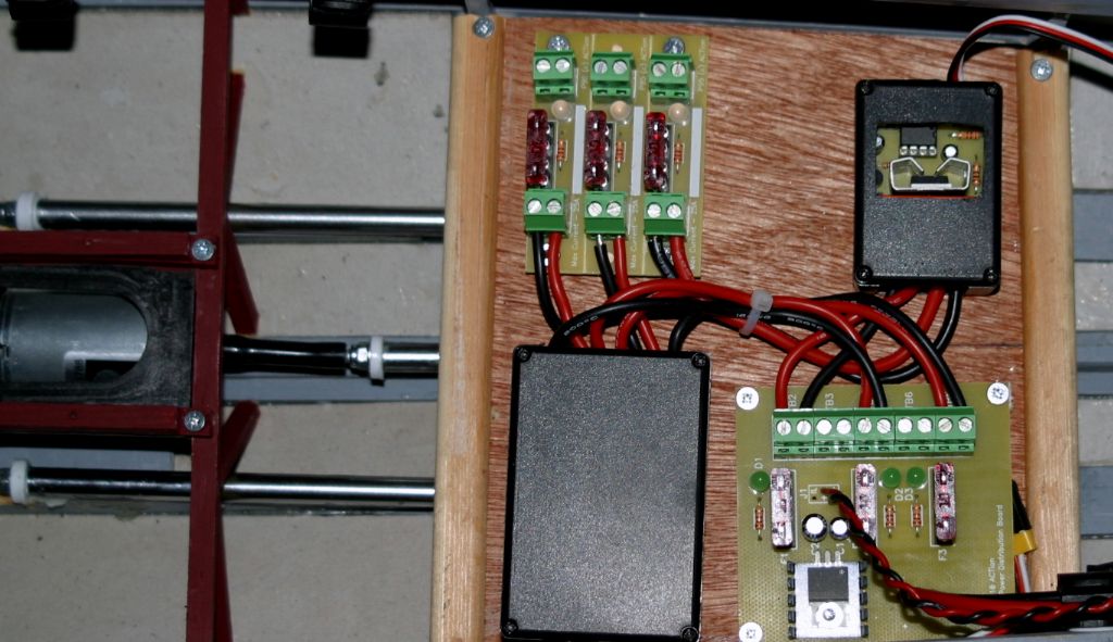

                                          Red Leaders triple engine layout and partially fitted electronics.
                                          Another view of the shafts going below the electronics panel.
                                          Triple rudders

                                              Very neat. I'd be interested to see the connections to the rudder tiller arms.

                                                Very nice, Paul…..Looks a bit fiddly getting to the motor couplings etc though?…..What motors are they?
                                                What is the overall weight with batteries
                                                Why are you using six fuses?
                                                More pictures, please?

                                                  The couplings are the flexible type so access and fitting is straightforward, the motors are all Graupner 500e ( I haven't fitted the suppressors yet)
                                                  I haven't built the batteries so I cant tell you the total weight.
                                                  Why six fuses, Its the correct method of installation as there are three fuses on the main distribution board (one for each of the ESCs) then each motor is protected by its own fuse.
                                                  Don't worry about asking questions.
                                                  ps. There is an easy solution to your 700BB problem.

                                                    Thank you Paul
                                                    I`ve never used two fuses per motor before, but it looks good!

                                                      Hi Bob
                                                      The first fuse on the power distribution board protects the ESC (as well as protecting the motor) but the second is purely to safeguard the motor.
                                                      I'm sorry but I was being flippant as my easy answer to the 700BB is not to buy one. From my point of view a pair of 600s will be fine but you could always hunt on fleabay for some MFA 800s
