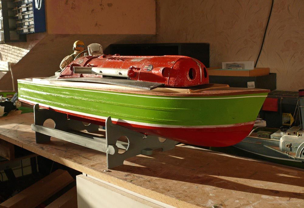

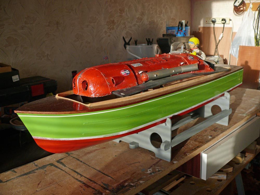

          New colour scheme try out….
          Green Machine
          We`ll soon have RED ALERT….and now we`ve got GREEN ALERT
          Bob back in`t Paint shop
          #45142
            Hi Bob
            I am sorry to say that I don't like the green as much as the cream….but I'm just a traditionalist.

              #45145
              Keith Stothard
                @keithstothard46727
                Please go back to cream !!!
                Keith
                #45157
                Ian Gardner
                  @iangardner62867
                  I thought the cream looked pretty good too.
                  Ian
                  #45161
                  Peter Fitness
                    @peterfitness34857
                    Bob, it's your boat after all, and you can paint it any colour you wish….however, I have to agree with Paul, Keith and Ian, I much prefer the cream cabin sides.
                    Peter.
                    #45163
                      Hello chaps….In view of the overwhelming support for the ivory coloured cabin, I shall repaint the section ivory once again…. Thank you for your interest
                      No problem…..Bob back in the in the paint shop

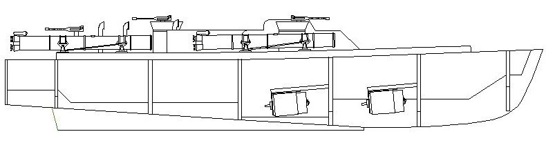

                          Red Leader Build
                          To set myself a challenge and to get the three motors as low as possible in the hull I have decided that instead of mounting the motors in the traditional way I am going to suspend them from an overhead frame, with this arrangement I can get the cans very close to the inside face of the hull without loosing the security of fixed engine mounts.

                          #45172
                            The motors look a bit vibration prone, hanging down like that?
                            Is it worth the risk?

                            #45173
                              Bob the challenge is in the risk…. as on paper there is no structural difference in suspending the motors in fact there is a distinct engineering advantage in getting the motors as low as possible.

                                #45182
                                  A couple of my models have the motors attached to the underside of the deck using belt drive. As Paul says, provided that the mounts are secure, it can give you more options if space is tight.

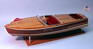

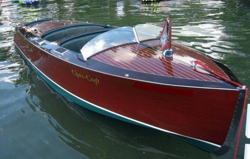

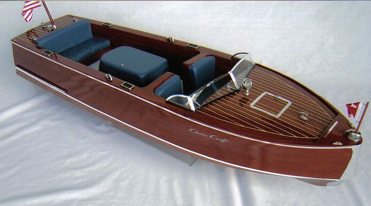

                                              Meanwhile do any of these take your fancy
                                              Edited By Paul T on 22/11/2013 17:46:12

                                                    Thank you, Paul
                                                    Your samples look lovely, but I prefer the SloMo version….At the moment
