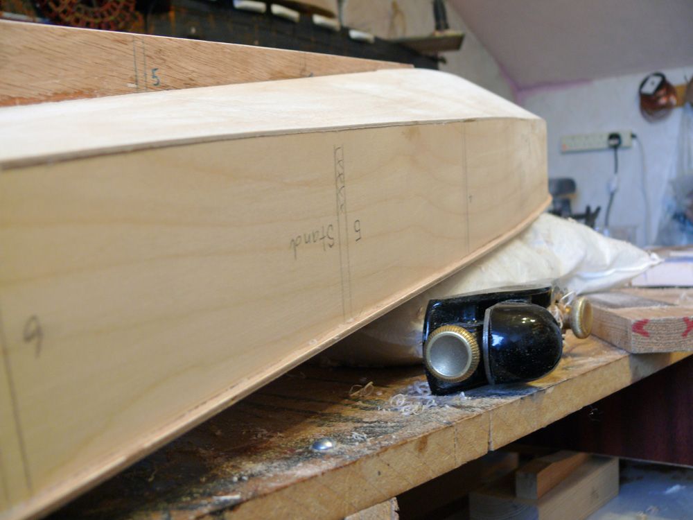

        I`ve planed off the surplus deck material and it`s looking good?deck overhang.jpg
        Notice the plane lying on it`s side?
        If the very proud woodwork teacher saw it……Blade down………Whallop!…….You got a clout round the ears!
        Happy days?

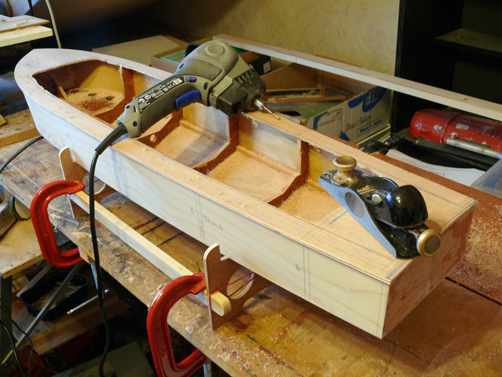

          Having a nice afternoon in the workshop today
          With the edges cleaned up, the hatch opening can be drawn easily, using the Marking Gauge with a soft pencil….Viz
          The hole was cut out using the new Dremel Trio with special cutting out drill, that thinks it`s a saw!…..Something I`ve always wanted to try!
          Followed by the plane and then the rotary sander for the curves
          Pity the saw dust fell down the holes in the Breadhook and into the soft varnish below?
          Should make a good seal though?

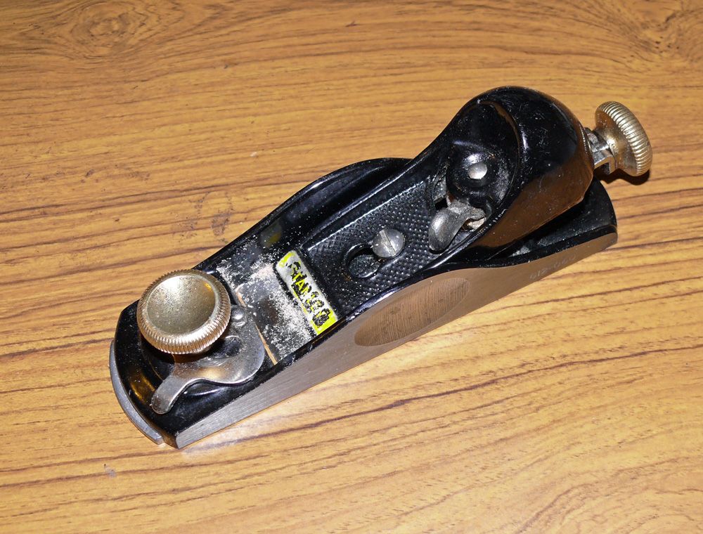

                  The plane is a Stanley of course
                  Model number…..G12-060 and costs about £50.00 now
                  Mine was a Christmas present!

                            This is a quality plane…..
                            A thing of beauty is a joy forever
                            It has adjustment for depth of cut by knurled screw, adjustment for squareness and adjustment for slot opening
                            That`s the spec….get one!

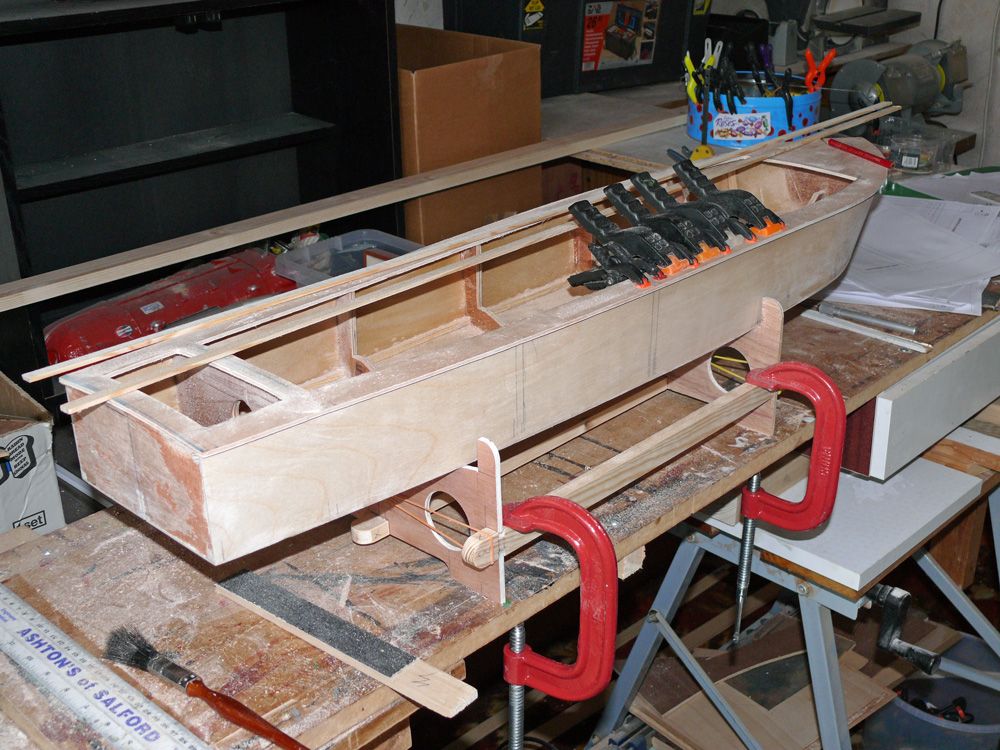

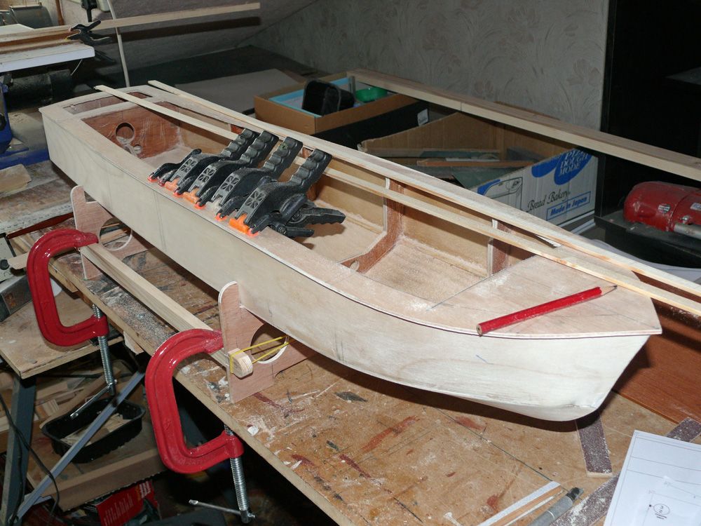

                                                      Both hatches are cut out along with the combing strips. The bandsaw is very useful for strip making. If you haven`t got a bandsaw…….Ask Santa Claus for an early Christmas present!
                                                      They are essential…..Along with a belt sander……And a vertical drill…..Not forgetting a little lathe too!
                                                      The cluster of clamps are trying to compress a raised glue joint, having brushed water on
                                                      It seems to be working too!
                                                      Not decided what to do with the 3mm deck over hang yet
