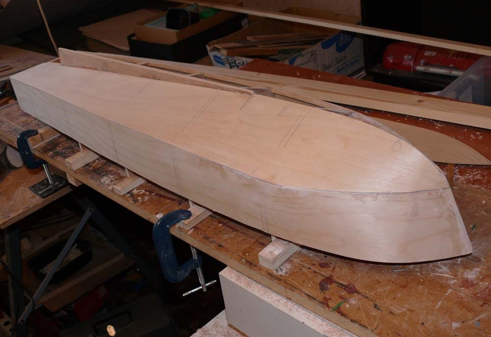

            The latest skin photos look great and the below chine curve is spot on, How easy was it to bend?
            #43315

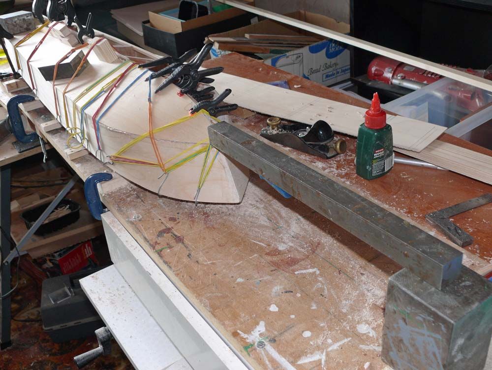

              Glued the first bottom skin in place with all manner of stuff. Notice how useful the clamp holes are?
              The tip was a struggle and had to resort to the heavy stuff!
              Taking shape now?

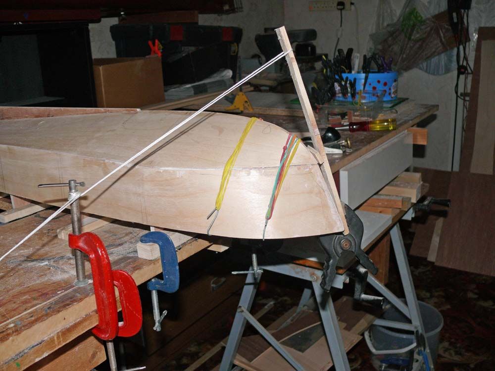

                              This idea is worth a mention………..Leverages and all that stuff
                              A clamp was required to secure the tip of the skin
                              After trying all sorts of nonesense, this Eureka Moment emerged!
                              It may look crude, but it did the trick!
                              After applying the waterproof PVA glue to the joint…..
                              I clamped a lever at the bottom edge of the hull
                              Attached a cord to the other end of the lever and loosely secured it to a clamp on the bench
                              A local block of wood was placed exactly where needed and pressure was applied, by pushing the top of the lever
                              When satisfied with the setup, the cord was finally secured to the anchor point
                              Problem neatly solved
                              #43337

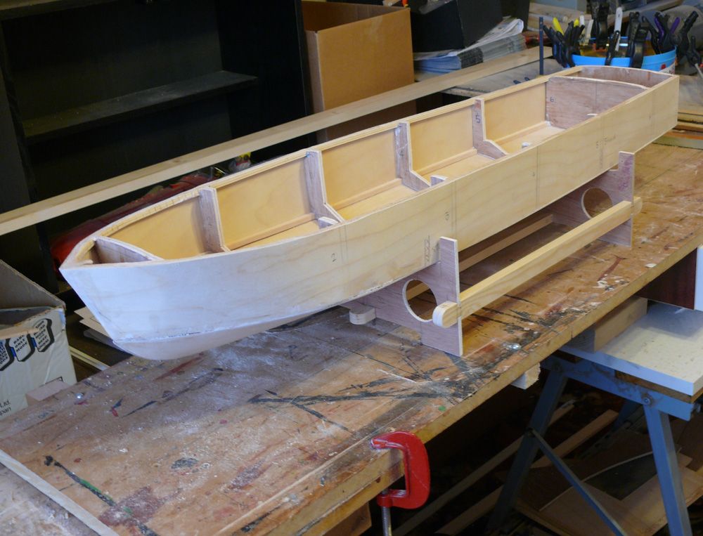

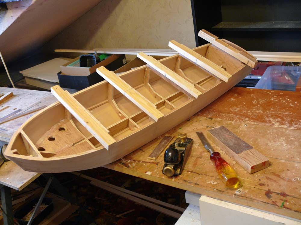

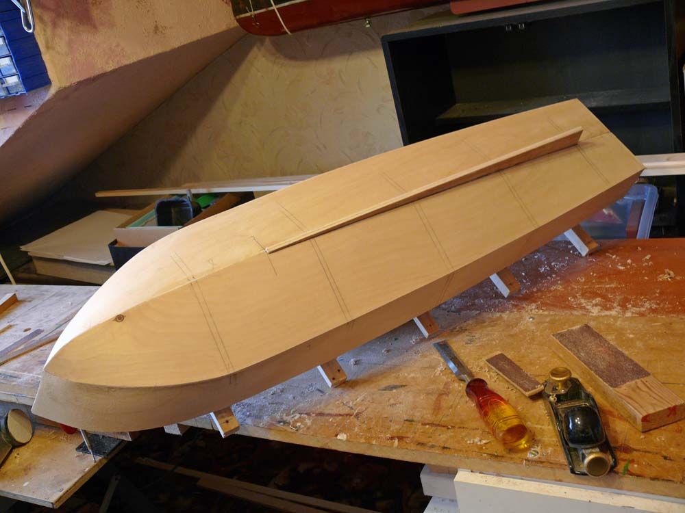

                                Hull carcass finished, five weeks of fun………Sort of!
                                The keel is a little proud, at the front, shall we plane it down to the hull?
                                What`s it like inside?…..I can hear you ask……..
                                The next step is to remove the Former extensions, level up the top edge for the deck seating, clean up the inside, add more glue round the joints and apply a few coats of varnish
                                Not forgetting of course to draw round the periphery for the deck top
                                Bob in the Paint shop
