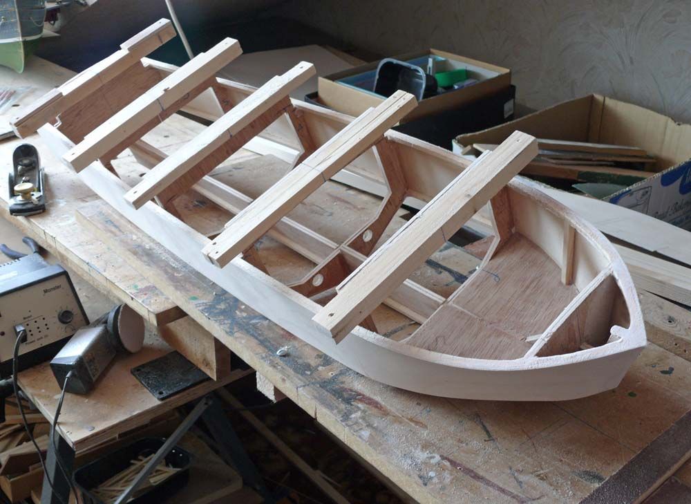

                Halfway there!

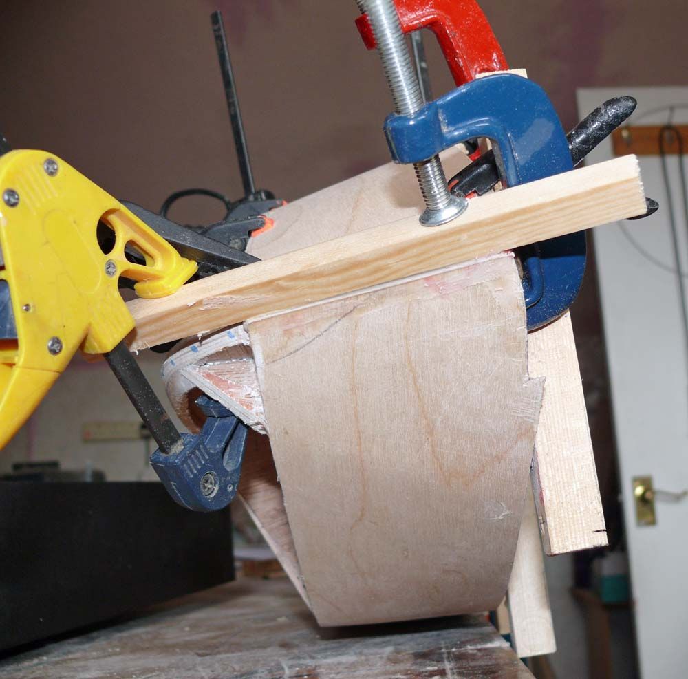

                Glued the skin on as far as the bendy bit and the prow joint looks more achieveable now with the hull on it`s side………As mentioned earlier by the Chief Designer!
                Don`t think we are ready for the Haydock Show now, but will put it in the boot, for viewing by selective audience!……….If I can find him! I need to look out for a blue Rolls Royce or similar?

                  I wont be going in the Roller as it takes up to much space in the car park besides it would look cheap next to Mr Freshneys new model.
                  #43260
                    Before now my answer to this tricky bow problem has been to use 5 min epoxy, butter everything up, and hold in position for 5 mins !! Not very scientific, but clamping bow pieces together has to be one of the most tricky things to effect.
                    Nornally I use thinner stuff than this, and in which case superglue is a godsend. It penetrates the wood (answering questions of "just glue" to hold it all together) on both parts and obv sets within a minute or so. Wearing pvc or other gloves to be safe while holding, either someone else can glue or a generous measute of sg can be applied and then the parts held together.

                        Still enjoying the thread. Whenever I have had to glue skins on, I have used brass flat headed pins as well as glue- old style. These sand down perfectly with the skin and are invisible under a painted finish- the only time you couldn't do this is with a bright finish- and I've never had the courage to do one of those. Saves a lot of clamping and it's quite fun to do as long as you pre-drill pilot holes!

                          By laying the hull on it`s side, I have managed to tame the Blighter!
                          Forced it down on a bed of P38………The Lockheed Lightning has saved the day!
                          This!……..Was our finest hour
                          Not a bad joint either?

                            Bob. Yes, been away. Have been following the thread, have not been posting as there have been plenty of comments on it, without just saying "ooh that looks good Bob" (which it does). Pleased to see some mods taking place. CAd drawing is all very well but there is nothing like seeing the animal in the flesh as it were.
                            There have been many times when I have drawn details on my builds, but when the time actually comes and you see the bits of wood you realise that your first idea isnt neccessarily the way to go.
                            Bow clamping is the case in point. Every model will be different and require a different technique.
                            Excellent joint on the bow. Do I detect some deft fettling going on?? Your use of p38 to bed this joint on is something to be borne in mind. I have found sometimes that p38 or similar is actually a very good glue in itself, and not only that..but obviously a great gap filler.

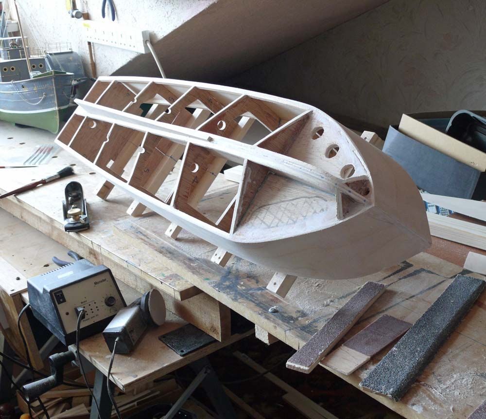

                              The hull is shaping up now, but again, it`s……Into the breach once more, dear friends!…….Got the bottom skins to wrestle with!
                              No doubt, I`ll get some expert advice from Red Leader tomorrow at Haydock?

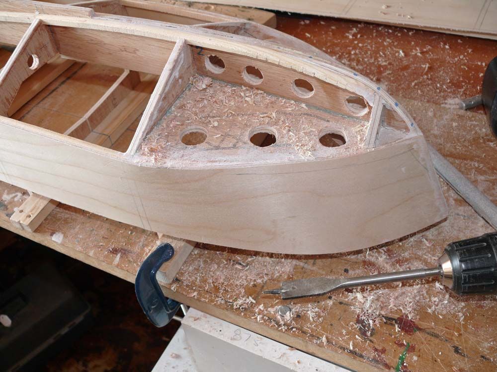

                                            Come on, Paul……Just because it`s Bank Holiday Monday……Gerrup!…..We`ve got important work to do!
                                            We need more `oles!

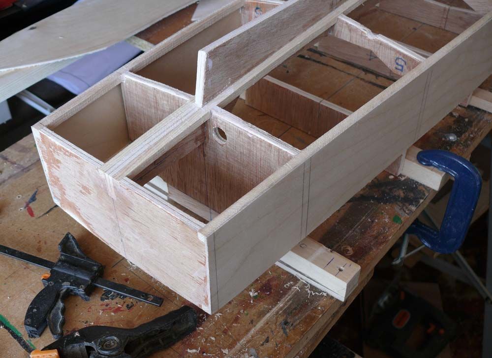

                                            We need a hole in Former 6………For the rudder mechanism?
                                            And more holes in the keel wall for clamping the top skin down and a few more in the Breadhook…..Just for show
                                            I think holes like this make the chassis more interesting?
                                            Bob on the shop floor having a bacon buttie break

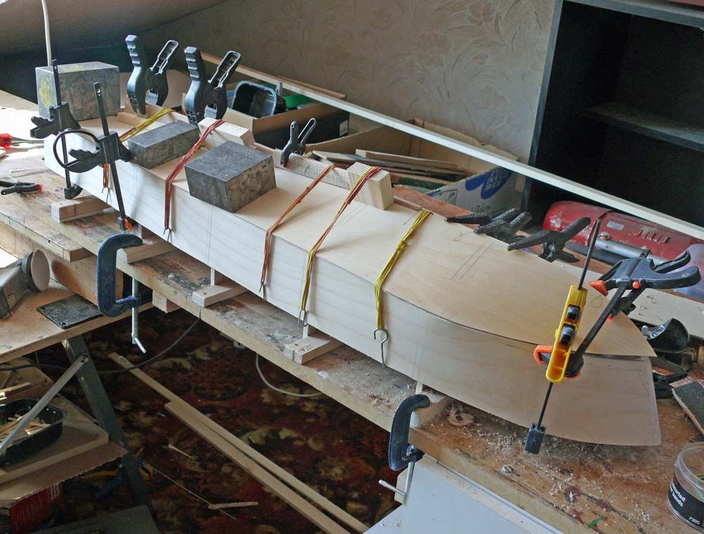

                                              The third skin is glued in place, leaving the curvy section unglued at the moment
                                              Don`t forget to run your hand over the skin to feel for unwanted lumps and bumps…..As this is your last chance!

                                                Hello Bob
                                                Re Extra Holes in Frame 6: The rudder servo and linkages all sit in the rear compartment between Frame 6 and the transom. The existing hole in Frame 6 is for the servo plug.electrical cross section.jpg
                                                As for the cute holes in the bow whilst they might have helped with clamping during the build unfortunately they will now allow any flood water to enter the lower compartment which would be very difficult to remove. Also I had hoped to use this sealed chamber as a floatation / buoyancy aid in the event of capsize or sinking but if you consider the holes to be more valuable as clamping restraints then we will keep them.

                                                  I prefer the holes option, they are very handy for clampimg the skins, the holes could easily be covered over later, if required, but I prefer to use a small plastic milk bottle as a floatation aid anyway
                                                  I also prefer the rudder servo push rods to be longer, so I`ll add the hole anyway in Former 6….Just in case
