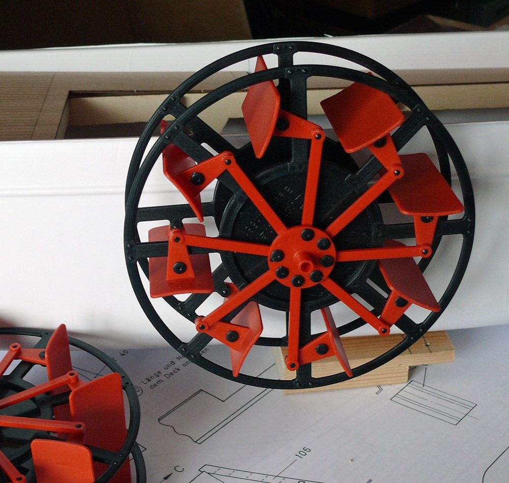

          The paddle wheels are 140 mm outside diameter and the drive shaft is 5 mm dia

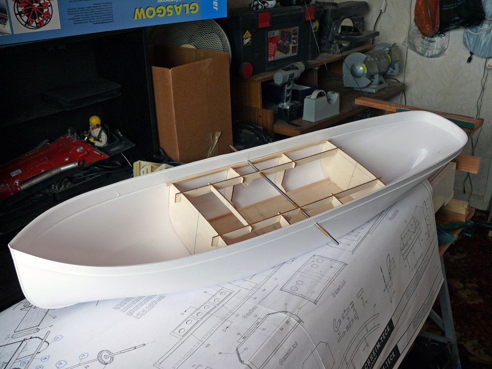

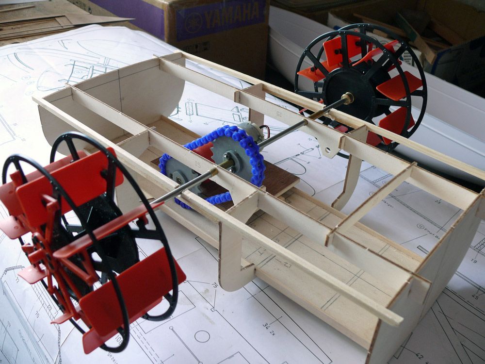

                      Work in progress picture

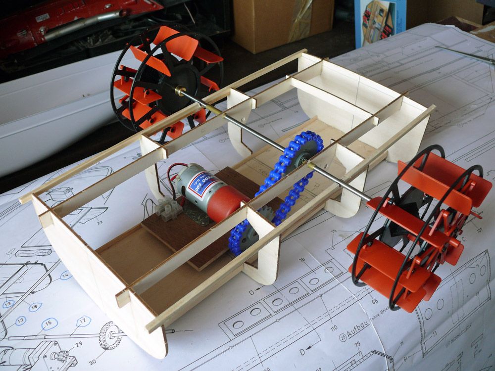

                      The drive framework fits nicely in the hull and paddlewheel shaft is in position
                      The top edge of the hull will be finalised when the deck is in place…..ie……Too wobbly at the moment!

                        Good Afternoon Captain Bob
                        Using a Becker rudder with independent paddle wheels in a steering competition!
                        Doesn't that give you a little unfair advantage?
                        You have done a nice job on that hull.

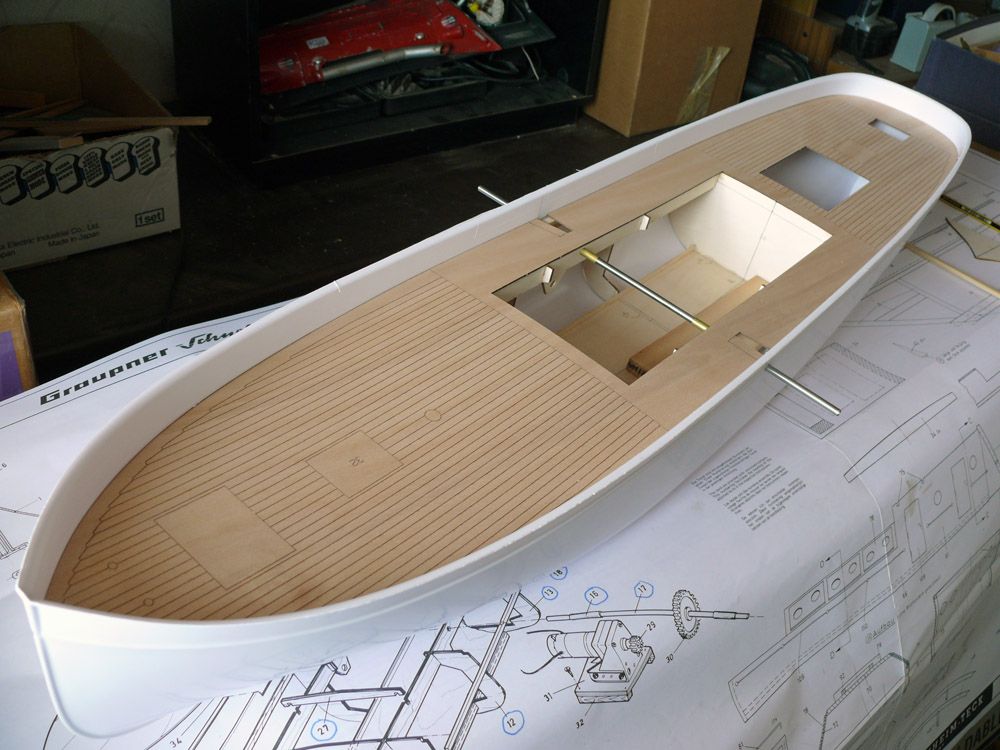

                            It was a shear delight when the top deck fitted the hull perfectly!
                            No need for the sanding block at all!

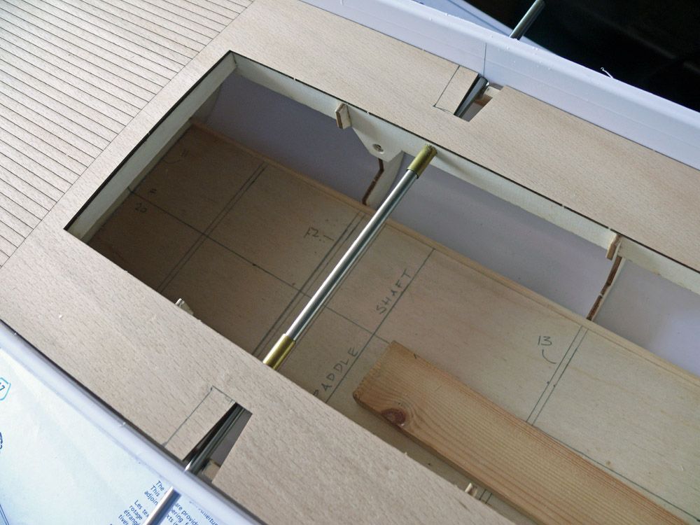

                            Pity the central cutout to clear the bearings was about 5mm out of plonk!
                            Not much of a problem, but it should have been corrected?

                              From a company of such repute to have a 5mm error on a well established kit is very worrying and would put me off buying from them.
                              Have you written and advised them of the problem.

                                I think I will contact them, just to see their reaction…..and post it!……Don't worry Colin, I shall be very polite
                                Most of the paddle boxes and superstructure are plastic mouldings and it's very difficult, deciding where the flash ends etc
                                I would not recco this kit to a novice

                                  Unfortunately this sort of error is quite common on even kits from the most respected manufacturers, mentioning no names of course! Usually if you report the error they will correct it so it is always worth doing so but if Graupner are still selling this venerable kit then I doubt if they will do anything now!

                                      Given how much you paid for the kit I would think that it is a very big problem.
                                      If I were running Graupner I would want to know how such a basic error managed to get through the design and prototype stages of production not just for this kit but for the wider implications involving all of their kits.
                                      I don't know what Graupner consider to be an acceptable margin for design error but in my former professional world an error of 5mm in 1000mm would be unacceptable.

                                        The hull has a central space in the perimeter beading with a dimple marking the paddle axle position
                                        That's the cause of the error
                                        Blame the moulding and not the lovely precise top deck

                                          The paddlewheels are simply pressed assembly throughout and rather fiddly
                                          The pivot pins are plastic and pressed in……They don`t feel all that permanent to me and was wondering if I should touch each one with a soldering iron to seal them in?
                                          Can`t risk glueing them, for obvious reasons

                                            Bob, Not seen any other comments about soldering the wheels, so perhaps they work fine as they are? Ashley
                                            #35627
                                              Thanks Ashley
                                              I can give them a whirl and see what happens……Spares are bound to be available?
                                              Good job I didn`t send my critical Email…..eh?
                                              #35628
                                                There seem to be quite a few Glasgow models about and I have never heard of them shedding bits of paddle. The wheels themselves have been available for many years and can be purchased separately at around £50 the pair. People use them for scratch built models.
                                                I'd give them a go as they are before making 'improvements', tempting though that may be.

                                                    The drive is very simple!

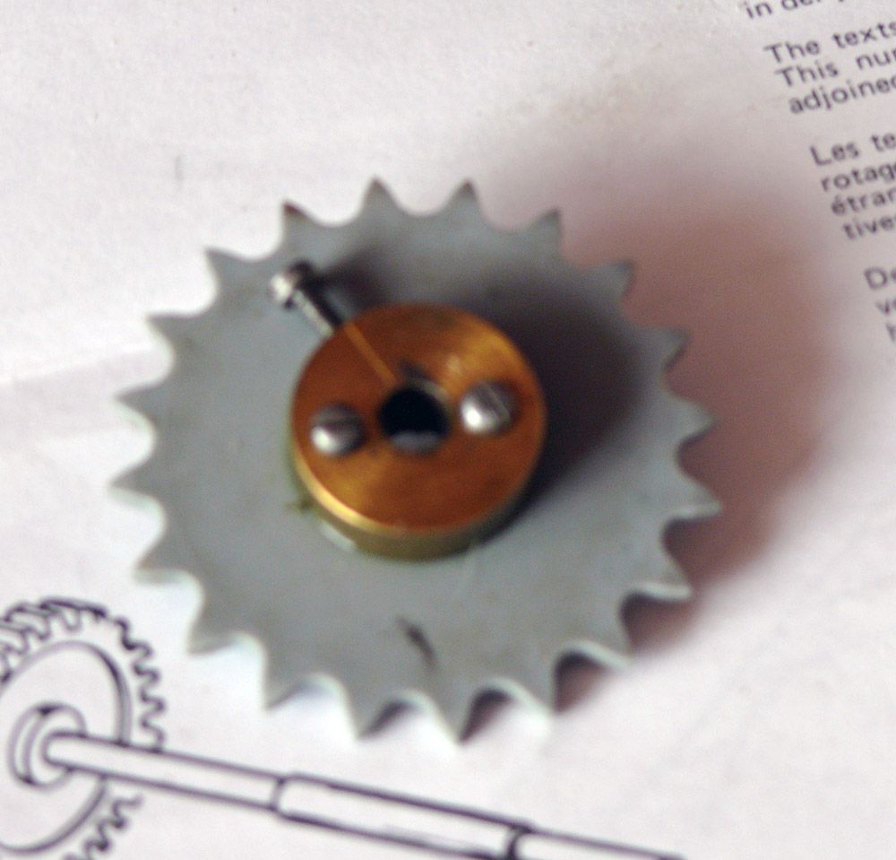

                                                    I`m using a 540 motor with 50:1 reduction gearbox and equal 20 T sprockets from HOBBY`S
                                                    The tricky part for you, would be making the sprocket drive bushes, as the standard sprocket bushes are too small. You would need a lathe for this item…..
