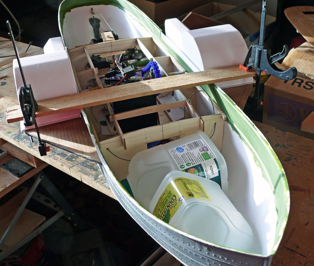

          #37619
            I suppose by keeping the sponson supports in tension……..It helped to break the glue bond
            Note the two empty milk bottles in the forward compartment, these are a present for Davy Jones!
            #37629
              sponson mod.jpgT
              This picture refers to previous post………Just a simple Senior Moment

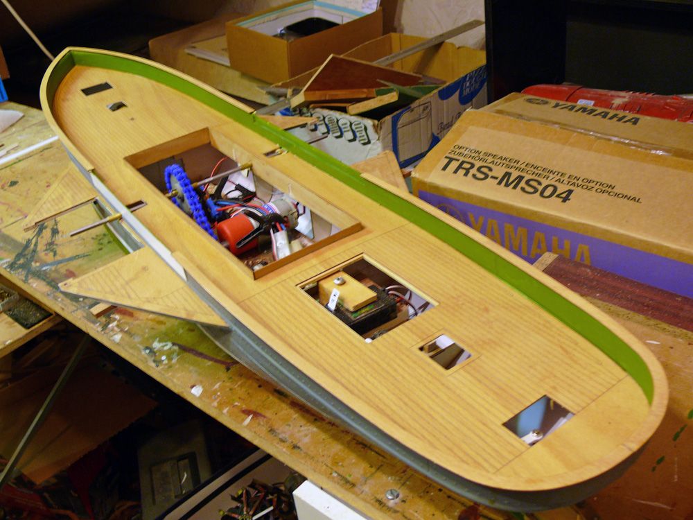

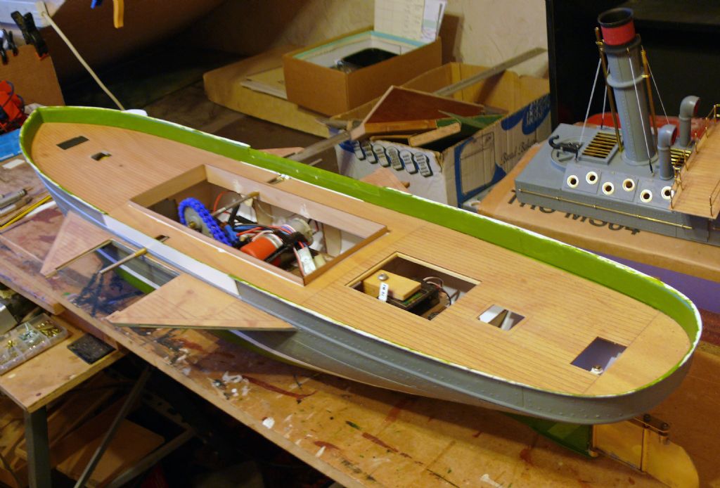

                Latest WIP picture
                Not very exciting….No disasters…..No snags…..Nowt to moan about for a change!
                For the benefit of the non Northerners….."Nowt"……….Means ……"Nothing"……….lol
                The deck is glued in and hatch coaming fitted. The model feels nice and solid now

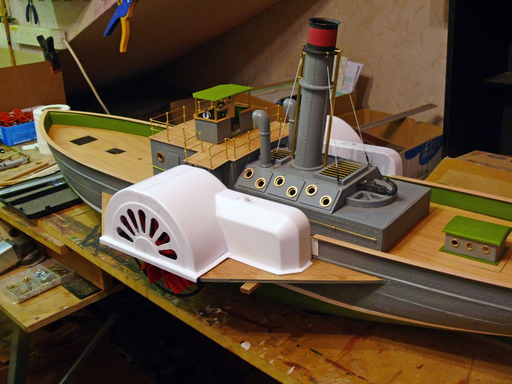

                      #37729

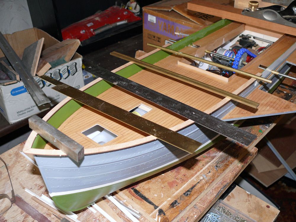

                        Fitting the handrails
                        To ensure that the rails lie correctly on the top of the bulwalks, weights are placed across both rails
                        I`ve abraided the top edges and using PVA glue and will have several coats of varnish
                        #37748
                          There yer go…….Handrails in position
                          The tricky part now are the bulwalk gussets………Painting thereof!
                          I really need a matching green edge, but the deck has deep grooves as planking joints and the paint might bleed through. The gussets need to be green for appearance

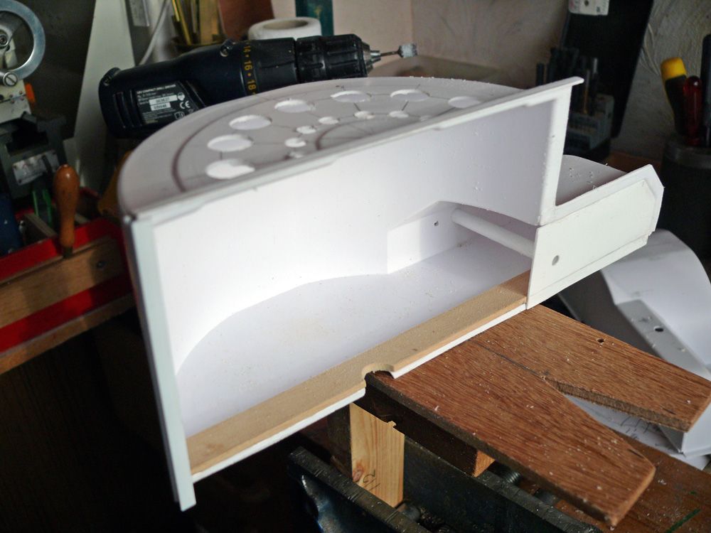

                              #37784

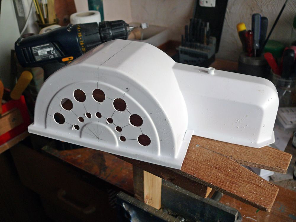

                                Working on the paddle boxes now. They feel very flimsy and need beefing up, in my opinion
                                Added a beam across the rear edge and filled in the rear box area
                                Hoping to retain the box with a single screw. Tube for same is glued in at top and bottom for strength
                                Note the back wall of the box will be on the outside of hull…….Not as kit instructions

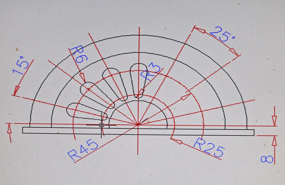

                                Vent holes changed to the traditional fan shape, starting with the drilled holes at each end of fan
                                CAD layout of fan hole vents
                                Making progress again, boys

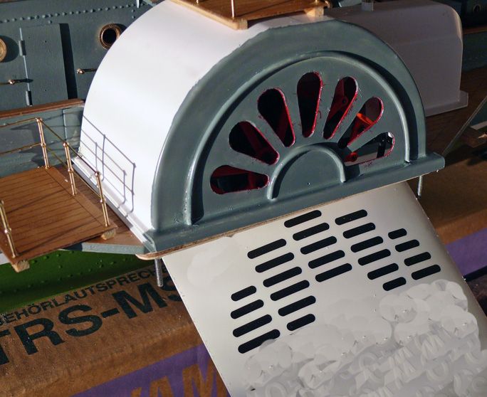

                                          Those paddle boxes look nice Bob, I knew you wouldn't be satisfied with the basic kit version, did you have to put a backing piece at the back of the blown vynyl to strengthen that before you cut the slots?.
                                          Very nice, clean job as always.
                                          Duckie
                                          #37835
                                            Hello Duckie…..Thanks you for those kind words
                                            I used the eye level work rest and a very sharp wood chisel, then finished off with the little sanding blocks
                                            Not much of a problem at all

                                              Bob, those paddle boxes look very impressive. I have thought about removing the 'stick-ons' off mine and cutting them out, but somehow there always seem something else more urgent.
                                              I think the original kit supplied pattern resembles the Manchester Ship Canal paddle tug Reliant.
                                              Tony.
                                              #37845
                                                Thank you, Tony
                                                Stick on slots!……..Pah!
                                                I have seen the kit slots on a real tugboat somewhere……..But prefer the radial fan shape for aesthetical purposes
                                                At least you have a drawing of them now!
                                                #37897

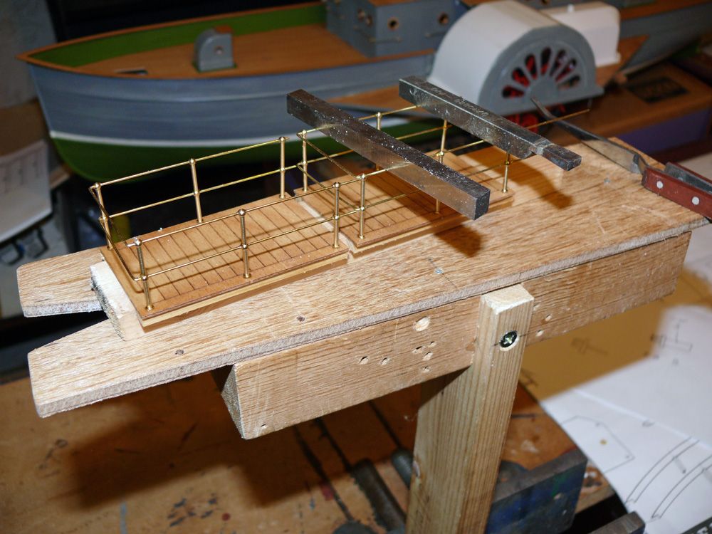

                                                  Paddlebox walkways
                                                  Tha base was drilled and varnished, allowing the holes to be slightly sticky for stantion assembly
                                                  The rails are secured with Superglue
                                                  The eye level workrest was a great help

                                                    The cut out slots on the wheel housings look very good did you get the design from the kit makers or did you research it yourself.
                                                    John
                                                    #37900
                                                      Hello John
                                                      The kit offered……"Stick on"…….Dummy vents, which is not so nice
                                                      I`ve invented the fan shape myself……..Based on previous paddleboats
