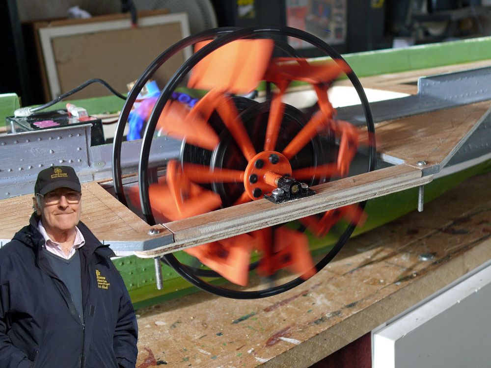

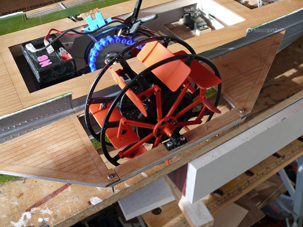

              #37516
                It`s down to the nitty gritty at long last…….Installing the paddlewheels and feathering mechanism….Great fun
                The stationary hub can be set at it`s optimum position with this design and was very satisfying fiddling with it. The float is set vertical at the bottom position, by moving the hub forwards or backwards
                Watching the mechanism working as it rotates was nice too……

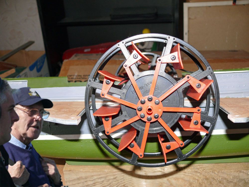

                      #37521
                        Larry, the feathering mechanism works by magic!
                        Unless you have one in your hands, it`s quite difficult to understand…..Whoever designed it, deserves a medal!
                        The main paddlewheel rotates on an axle………Obviously…….cough!
                        The feather mechanism coloured orange, rotates on it`s own axle……..Not shown on photo for clarity and is located off the sponson. This axle is set 6mm forward of the main paddlewheel
                        Both paddlewheel and feather mech rotate together ……………and this is the magic bit……..One spoke is solid……..The horizontal one on the right………This one spoke is what creates the strange movement of the floats.
                        It`s intention is to ensure that the floats entering or leaving the water in a vertical attitude….`ish!
                        If you can understand that…..You`re a better man than I am!
                        You can ask me any question………..Bob

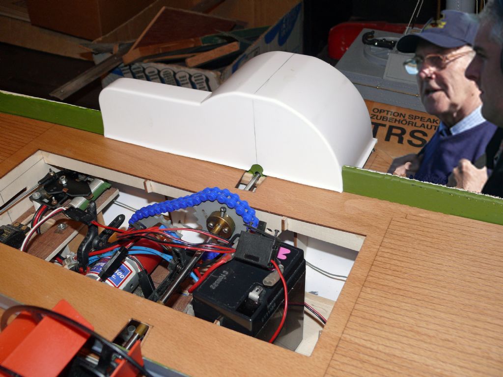

                            #37561
                              "Got a bit of a problem `ere…..Surry!"……..Said Fred
                              "And what`s that?"……..Said Bob
                              "When`t props runnin`……..Watter`ll gerrin bort!"……….Said Fred…………"Crumbs!"…..I reply or something similar!
                              Seriously chaps, the paddle box fits on the inside of the hull, which means that paddle spillage will enter the hull,………….so Fred tells me!
                              Can see a drastic mod looming!
                              Looking forward to this!……Bob

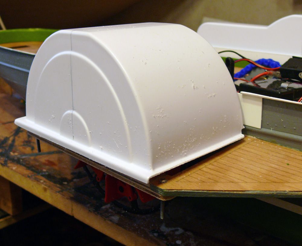

                                      #37586
                                        Here we go again!
                                        Look at the first picture……..The axle bearing is flat on the sponson……….As it should be
                                        Now look at the next picture………The paddlebox is resting ON TOP of the paddlewheel!
                                        Can you believe it?…..The flat on the top is no help either!
                                        Any Glasgow builders out there with a similar problem?

                                                  Sorry chaps……I was incorrect in saying the bearing was flat down on the sponson!
                                                  The bearing shown is not the main paddlewheel axle, but the feathering axle!
                                                  Which simply means that the sponsons are too low down
                                                  Now to test the holding power of that fancy glue I`ve used!
