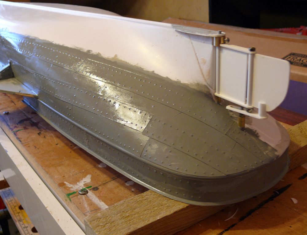

      Made a start on the rivetted card hull plating and a lick of paint. I specially enjoy painting over rivetted hulls, the effect is instantaneously pleasing!
      The complex curves at the rear are not all that severe afterall….So it`s full steam ahead now

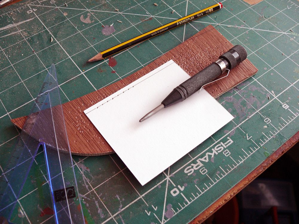

            I'm sure I've seen this info on one of your other threads Bob but, what do you use to create the rivets on the card ? A pin wheel springs to mind but not quite sure !
            Phil
            #36905
              Hello Phil
              You are quite right, all my paddlers have the rivetted card feature and I use a mechanical spring loaded centre punch. The type that can be adjusted for various impact strengths
              Unfortuneately, each rivet is punched the hard way! …….ie…….One at a time!
              I always use the same piece of spongy plywood as a workrest too

                two more simple questions, the card referred to, is that paper card or is it plasticard, and where did you get an adjustable spring loaded punch? I can only find ones of a fixed tension so far.
                Kim.
                #36954
                  Hello Kim
                  I use artist`s parchment paper, with the smooth side on the outside, for large boats, I use 0.015" For Glasgow, I`m using 0.010"
                  You need to find an engineering stockist for the punch, but I`m sure you`ll find one on the net somewhere

                    That looks like an "Eclipse" centre punch, as stated easy to find on the net.
                    Terry

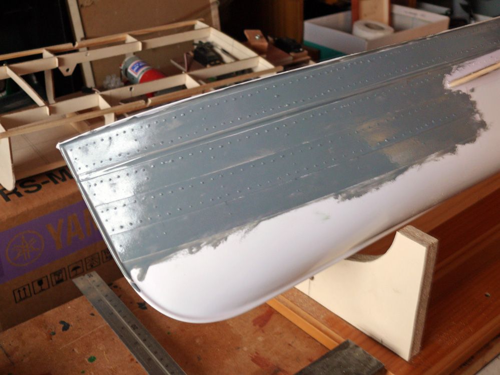

                      Nearly finished the hull plating now
                      The tricky part will be painting a nice waterline over the plates and rivets!
                      I think the plating has improved the hull`s appearance and given it the olde worlde look?

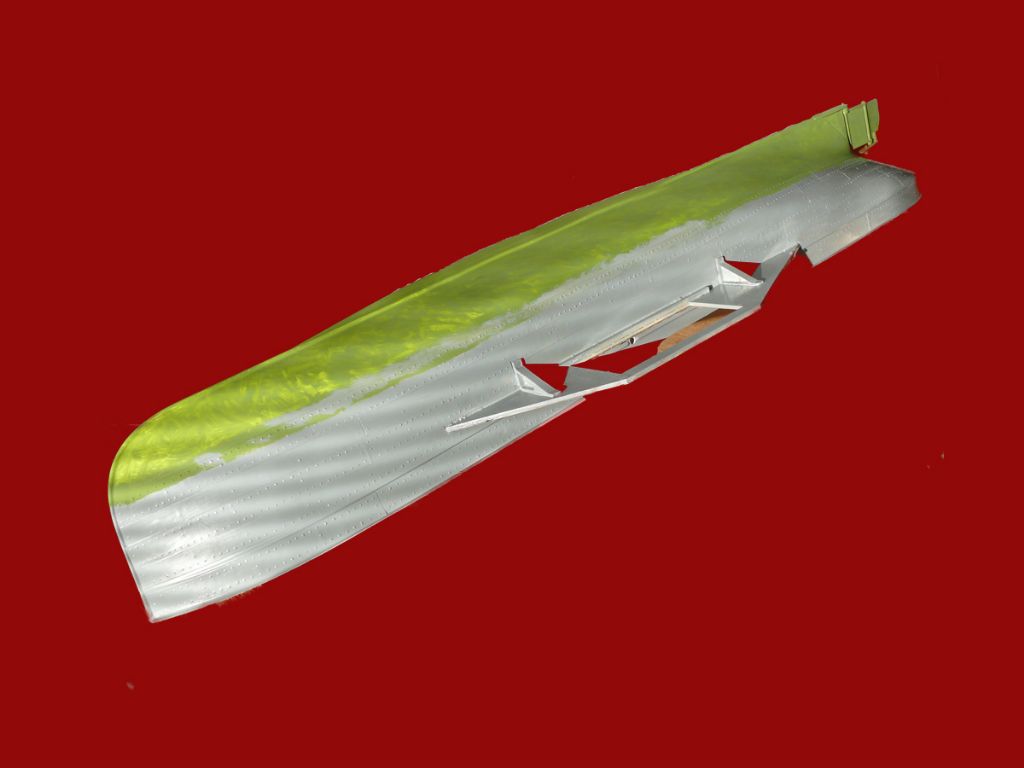

                        Hello, what`s this then?
                        Work in progress, but displayed rather dramatically…..As a bit of fun
                        Enjoyed the exercise and should be the start of things to come?
                        It`s just a try out, the stripes are reflections from the window blind

                          At 1st glance that looks like a screen shot from a 3d ship modelling programe set to "zebrazone" mode Bob very dramatic indeed Mate

                            Thanks Phil
                            It was a new PP tryout on Adobe Elements prog, which was interesting to explore

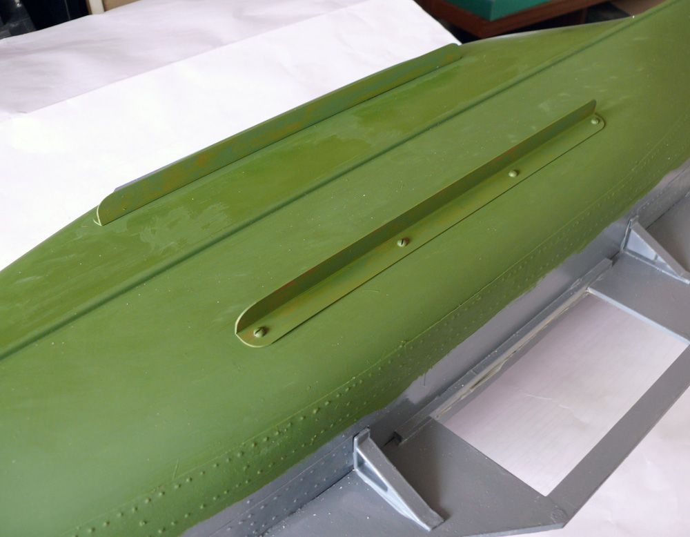

                              Not part of the kit, but I`ve fitted a pair of bilge keels to dampen out any wobbliness and instability and provide something level to stand on!
                              Nice rivets….eh?

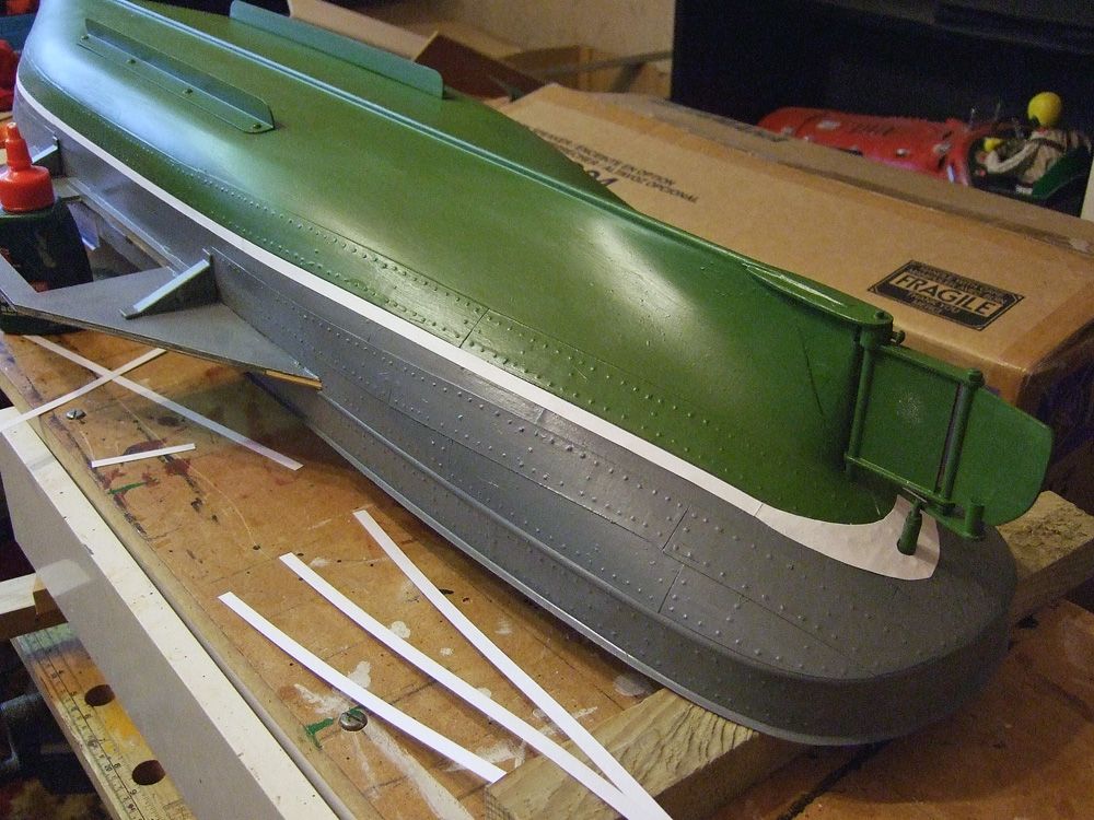

                                  We`re getting there at last!
                                  The Eureka Moment paper waterline!
                                  It was so easy applying it……..With plenty of time to juggle it about in 12" lengths before the PVA took hold…….The finished effect is very satifying
                                  I suppose several coats of varnish will tone it down?
                                  Bootifull?……..Bob

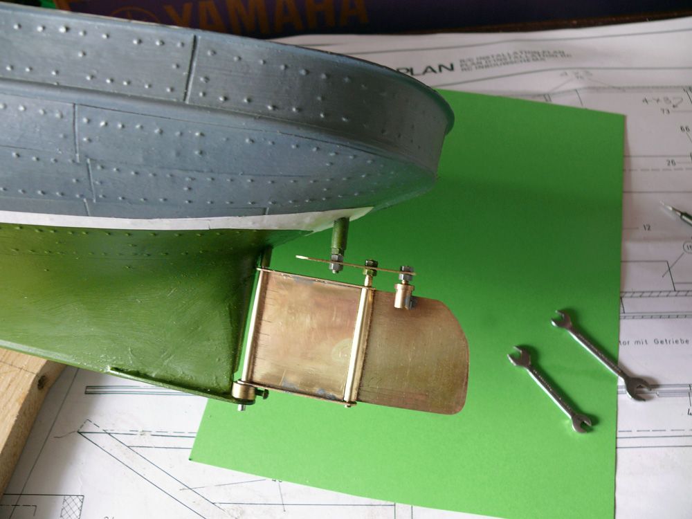

                                                  Have now replaced the feeble plastic Becker rudder with a more robust brass one and is looking better for it?…..
