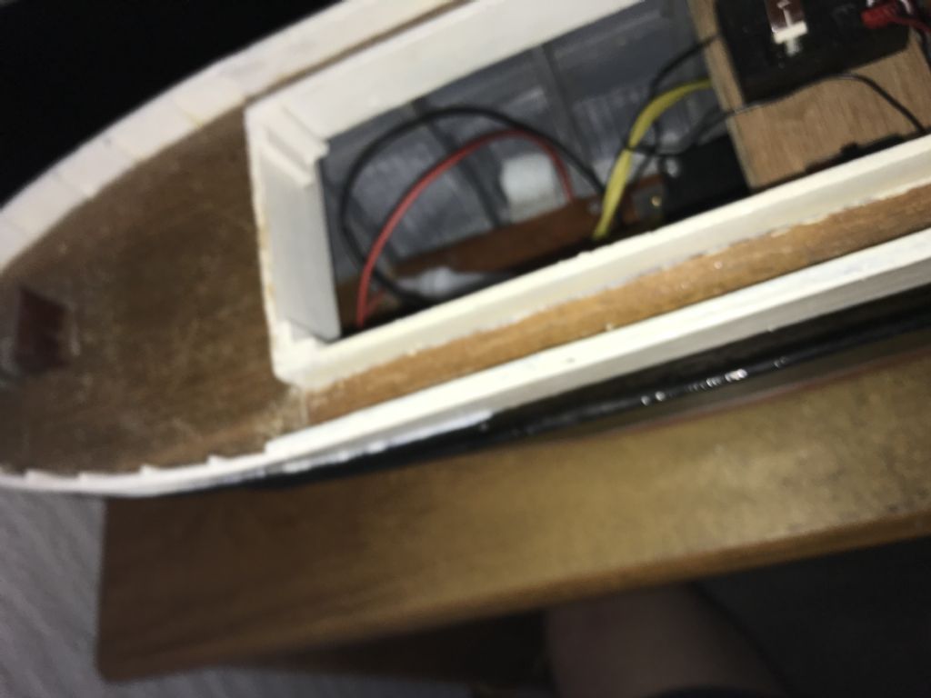

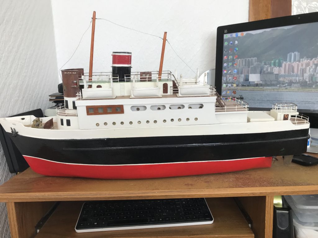

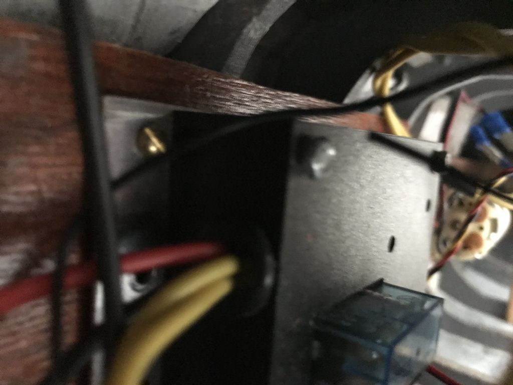

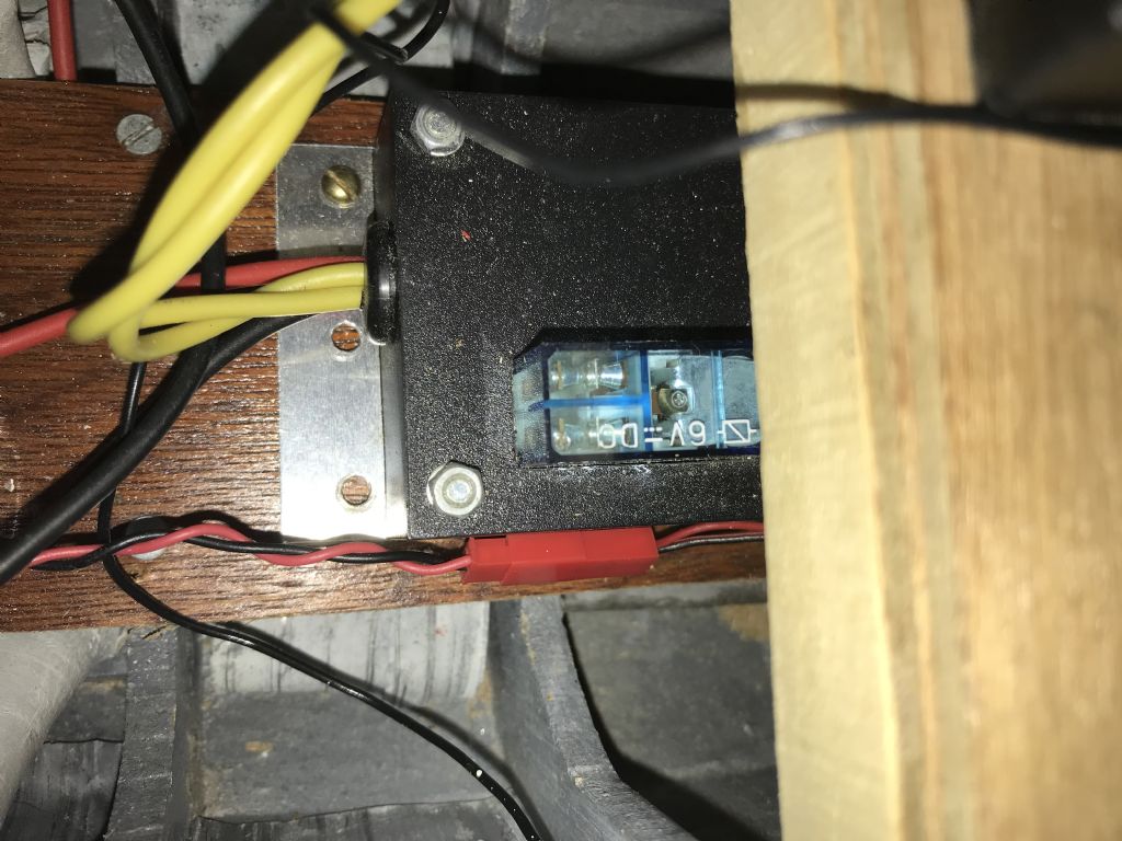

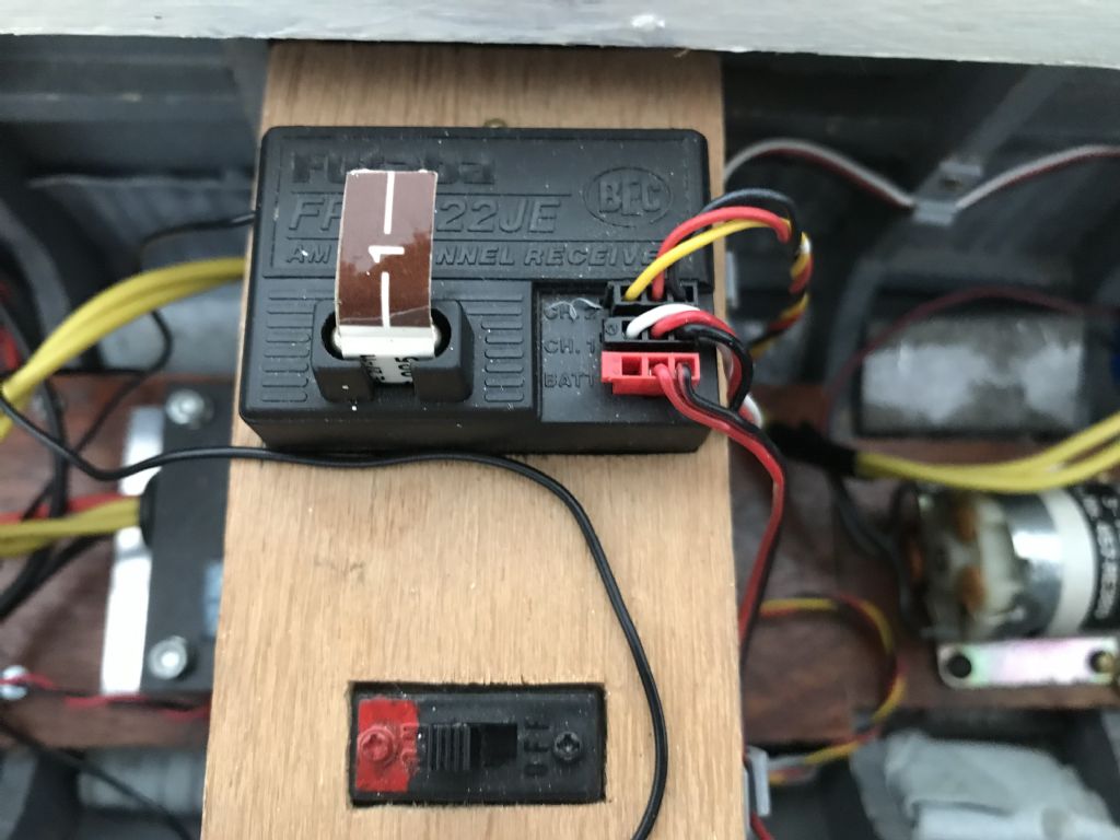

              img_2826[1].jpgimg_2824[1].jpgimg_2822[1].jpgimg_2821[2].jpgHi Richard/Dave,
              THank you for your replies. Please accept aploogies for delay in responding. I rodered a new 6v battery and waited for it to arrive to check . I have no movement on rudder or prop shaft at present. All batteries are fully charged and he one fuse I can see seems ok. On the unit sitting the bilges there appears to be a red led which does not light up.Don't want to poke around too much, checked all the connections are tight and Rx?Tx chrystals are where they should be. Nay guidance gratefully received. have uploaded some photos if they help.

                Hi James,
                With a radio old as yours maybe suffering with Black wire Syndrome which is not easily detectable by eye, hence the advice to buy new 2.4 gear, I know it sounds drastic and I do have a Futaba set 40 years that still works Also the BEC speed controller may have also expired if the light doesn't come on.
                One way would be to take the radio out and try it with a conventional 4 cell 4.8volt supply to see if it still has any life in it ?? It the transmitter ok ?

                  James, I would start with the very basics and work up. Firstly I would disconnect everything. Then plug a known fresh battery into the switch cable into the receiver and new fresh batteries into the transmitter. Check the crystals are the same number (and frequency range!) and turn the transmitter on. Turn the receiver on. Plug any known working servo into all the sockets one by one and check that it operates according to the relevant stick on the transmitter.
                  If that all works then you have proved the radio transmitter and receiver are fine.
                  Next plug the speed controller into the correct channel socket in the receiver and check that you have motor operation. If not, the speed controller or the motor would be suspect. Put power directly across the motor terminals to check the motor. If it works we are back to the speed controller.
                  A step by step simple process such as this will enable you to determine what is and isn't working and build things back up one stage at a time. Don't overlook the obvious, as Ray said cables could be corroded and switches might be faulty.
                  Or go for plan 'B' and buy a new radio set and a speed controller! Make sure the motor works OK first though.

                    As Richard says, plus, If there’s no light on the receiver, check that power from the batteries is getting to the two outer pins on the lead, and also try shorting out the switch to prove that it’s not simply the switch that has given up.
                    Often, simply unplugging and re-plugging the leads a few times can do the trick.

                      I am using rechargeables which were fully charged at the onset. Checked the batteries for receiver with a multimeter ( not proficient with this bit of kit though!) and got a 5.47 reading, checked the output side of switch and got basically the same reading so presume swirch ok. Receiver does no appear to have a battery.Connected motor to 6V battery and it spun no bother. The boat was sitting in front of me and I was tinkering with remote (no batteries in)when the motor suddenly started spinning did it a couple of times off and on and certainly made me jump , so I am thinking that speed control is capable of doing something. Need to try and test the transmitter next.

                        Well, I picked up a second hand RC and rcvr on ebay and the controls are working. Did a float test in grandkids paddling pool and did not look too bad – bit of an issue with the ballast but that will come .

                          The model does look a bit top heavy plus the high superstructure will catch the wind so you will need to be very careful about stability. It might need to float a bit lower in the water than the indicated waterline but you can check that as you say.

                          James McCall
                            @jamesmccall61935
                            Thanks Colin,
                            I have been looking at her and thought the same. I plan to check out and adjust the ballast when I get a mo.
